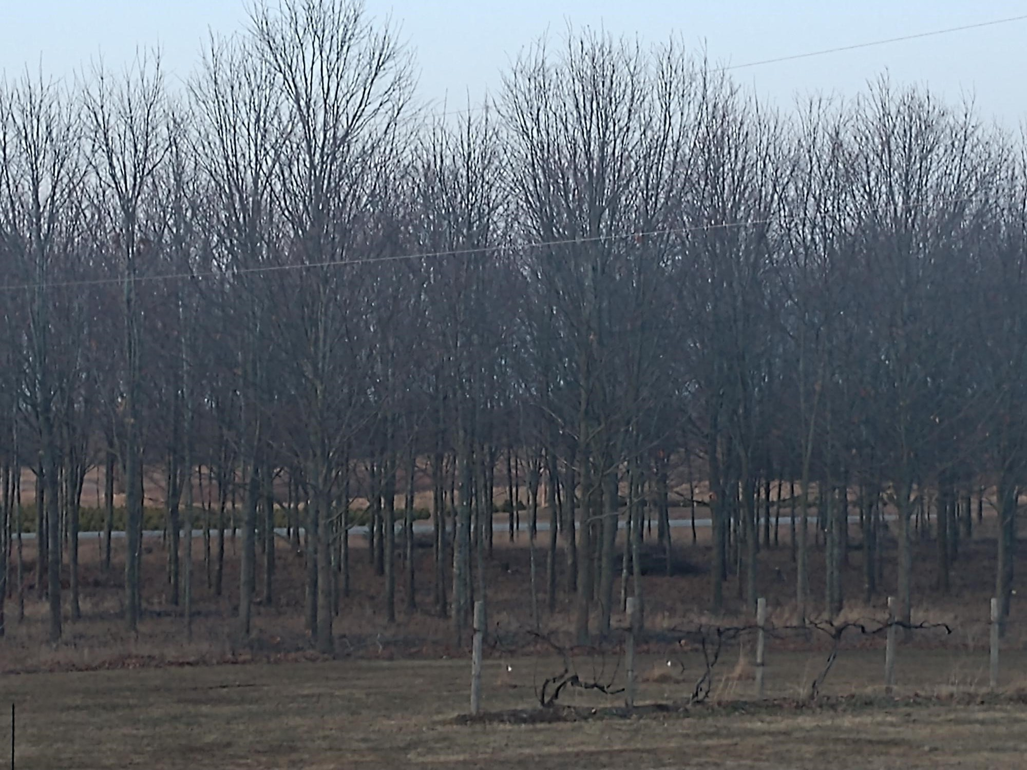

We planted 4k saplings back in 96. half Red Oak, half Black Walnut
Here's what I did after talking to a Nursery in Tn. way back then.
First I fertilized the sh_t out of the Oak saplings. 46% nitrogen....Urea. Enough that it burns the weeds/grass that attempted to grow around the tree.
applied it by hand. tiresome but did wonders. The Oak loved the nitrogen. Applied it once a month for 3 months starting in MAY. We live in Lower Michigan, GR-Lansing area.
Did that for 3-4 years. Somewhere around 1/8-1/4 cup each.
The other thing I did was roundup around the oak saplings. Hit them before bud out on the oaks and once later in the summer only during complete calm mornings.
If you keep it away from the green sapling bark and the leafs of the Oak you'll be fine.
I thinned out some 25-40+ ft. Walnut two years ago and just thinned out my Oak this winter some closer to 50ft.
