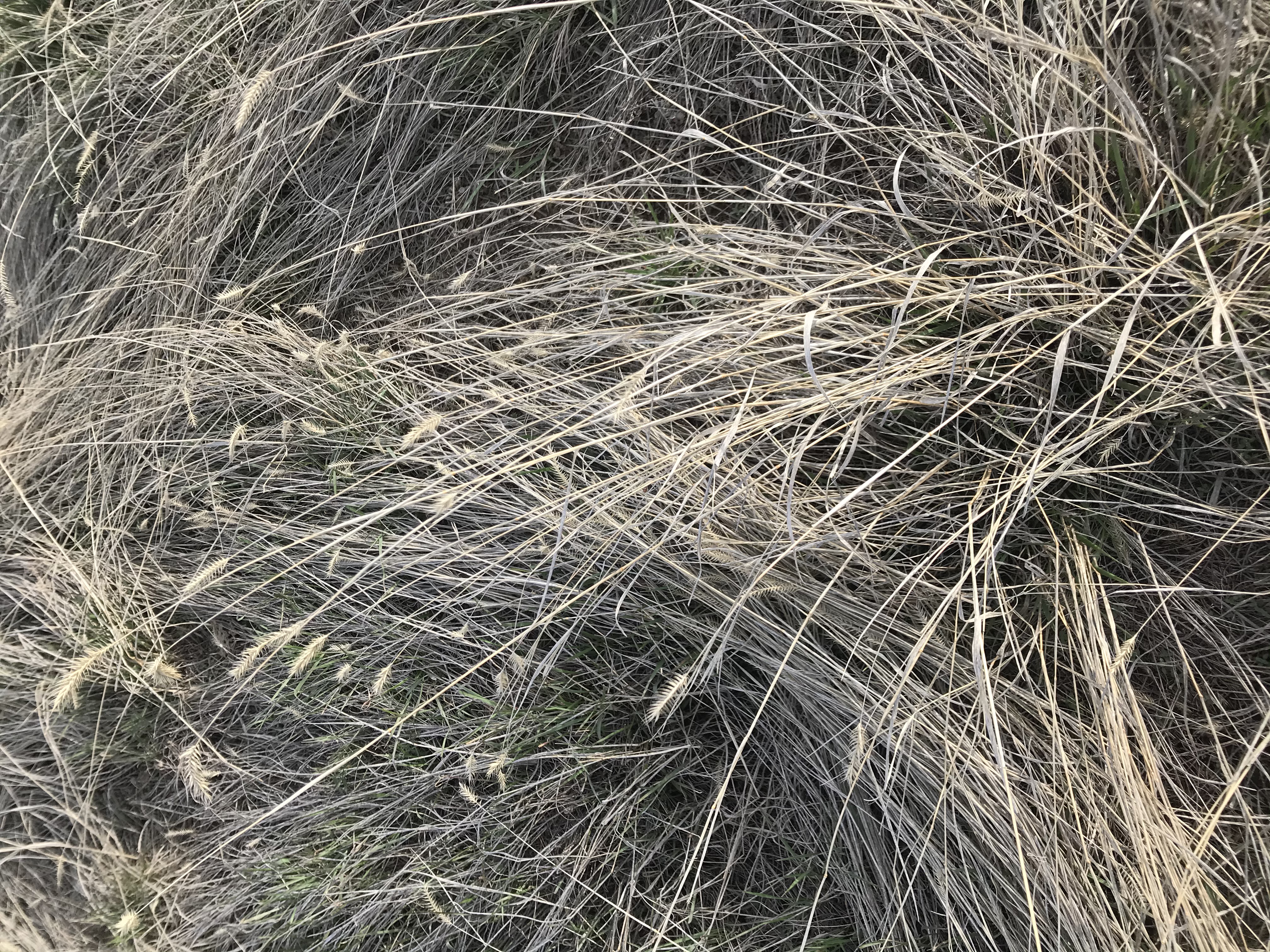

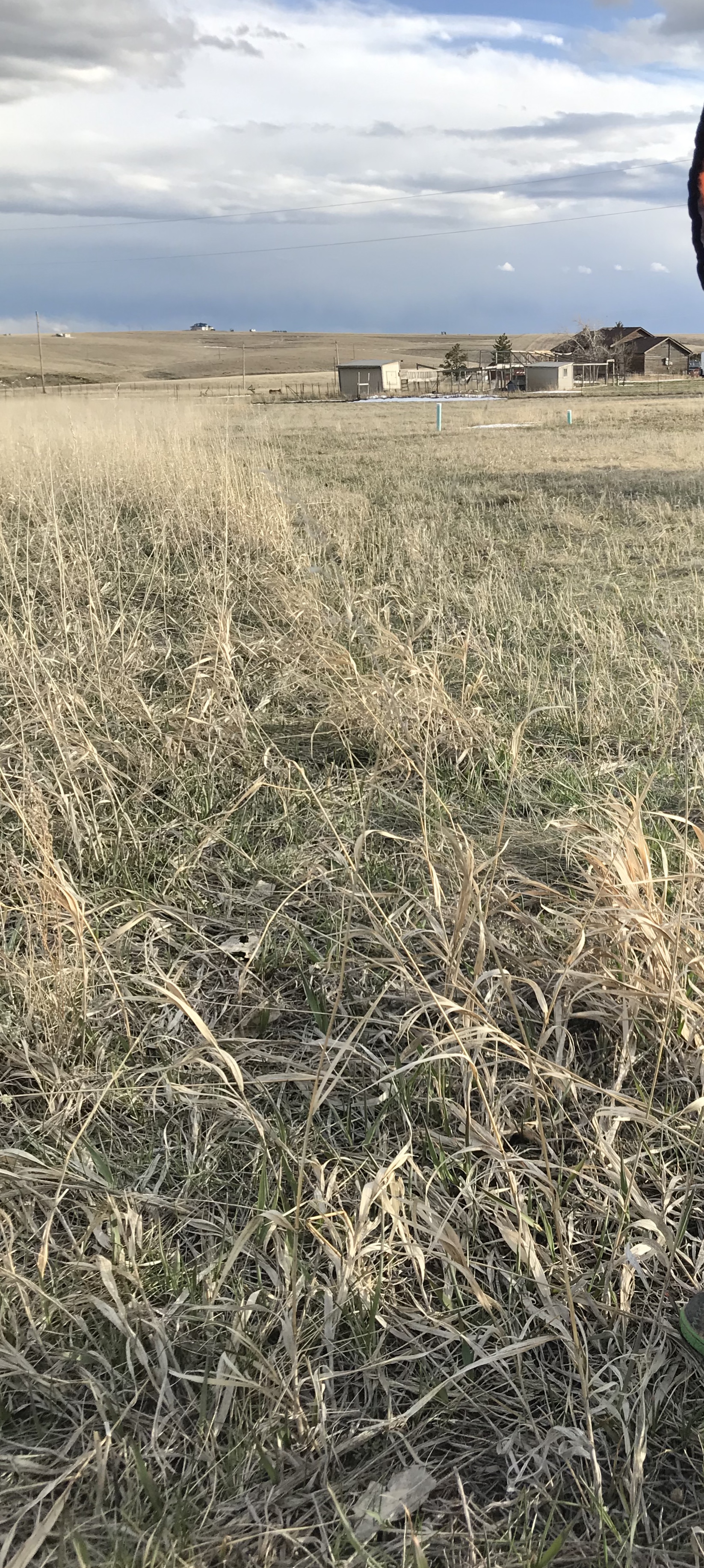

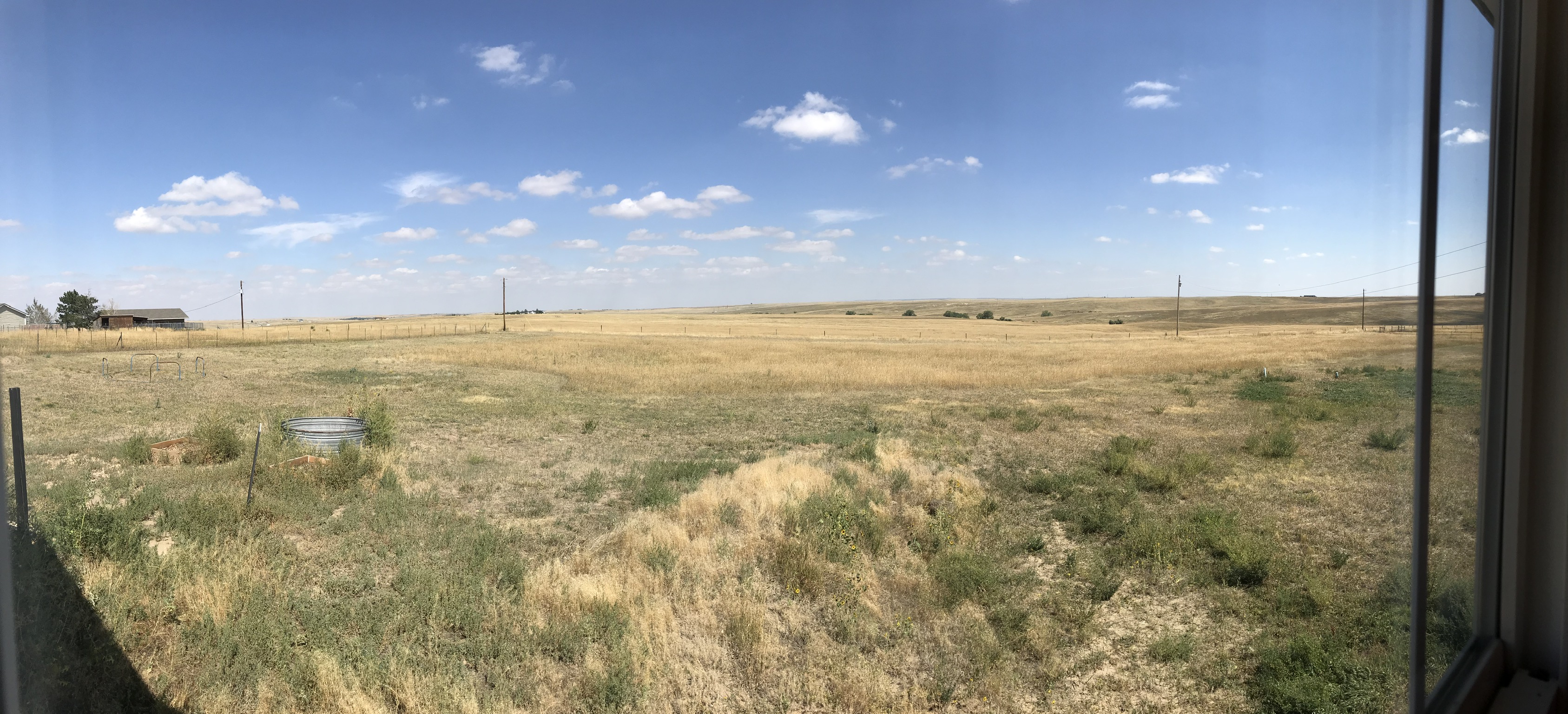

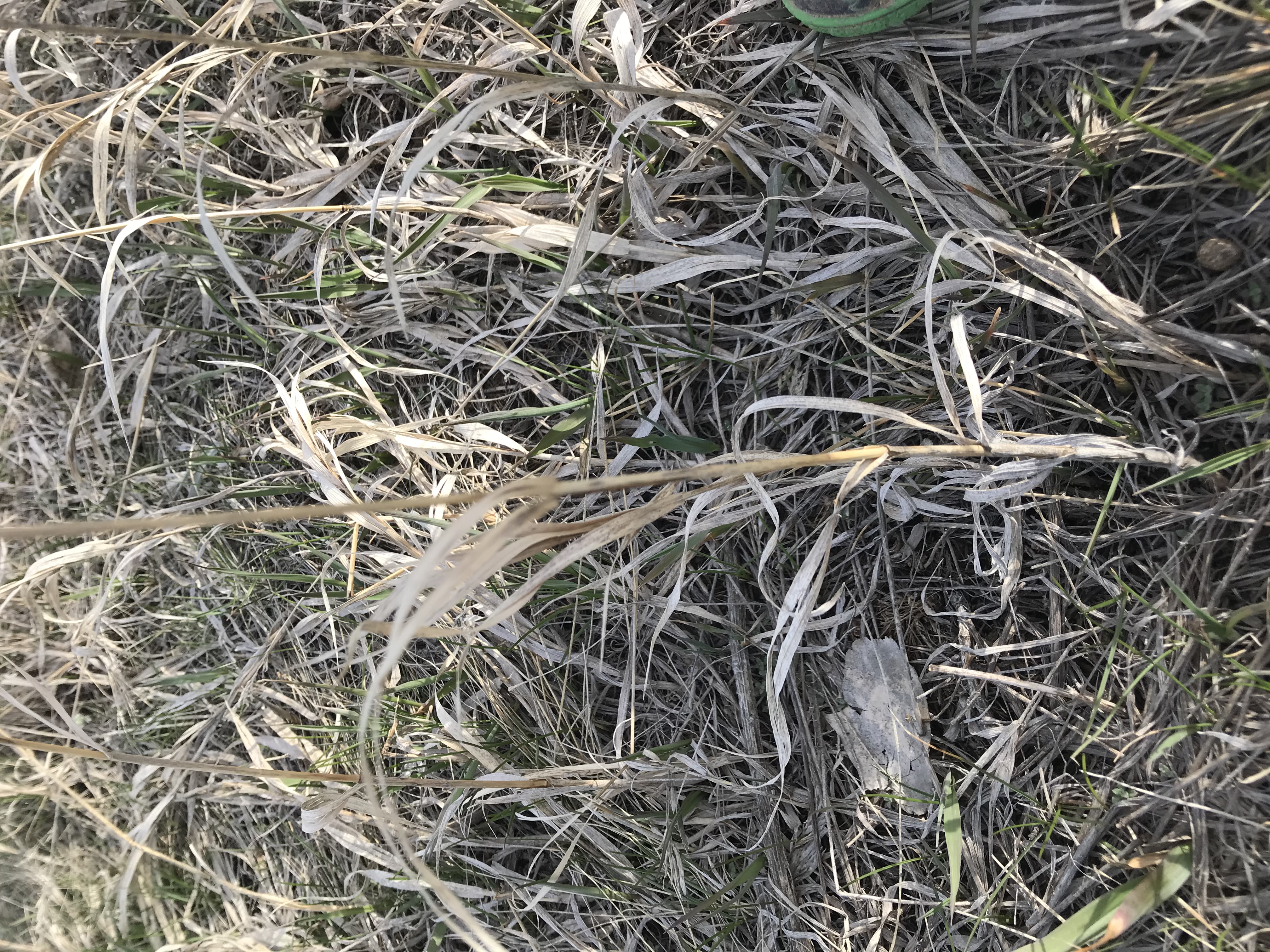

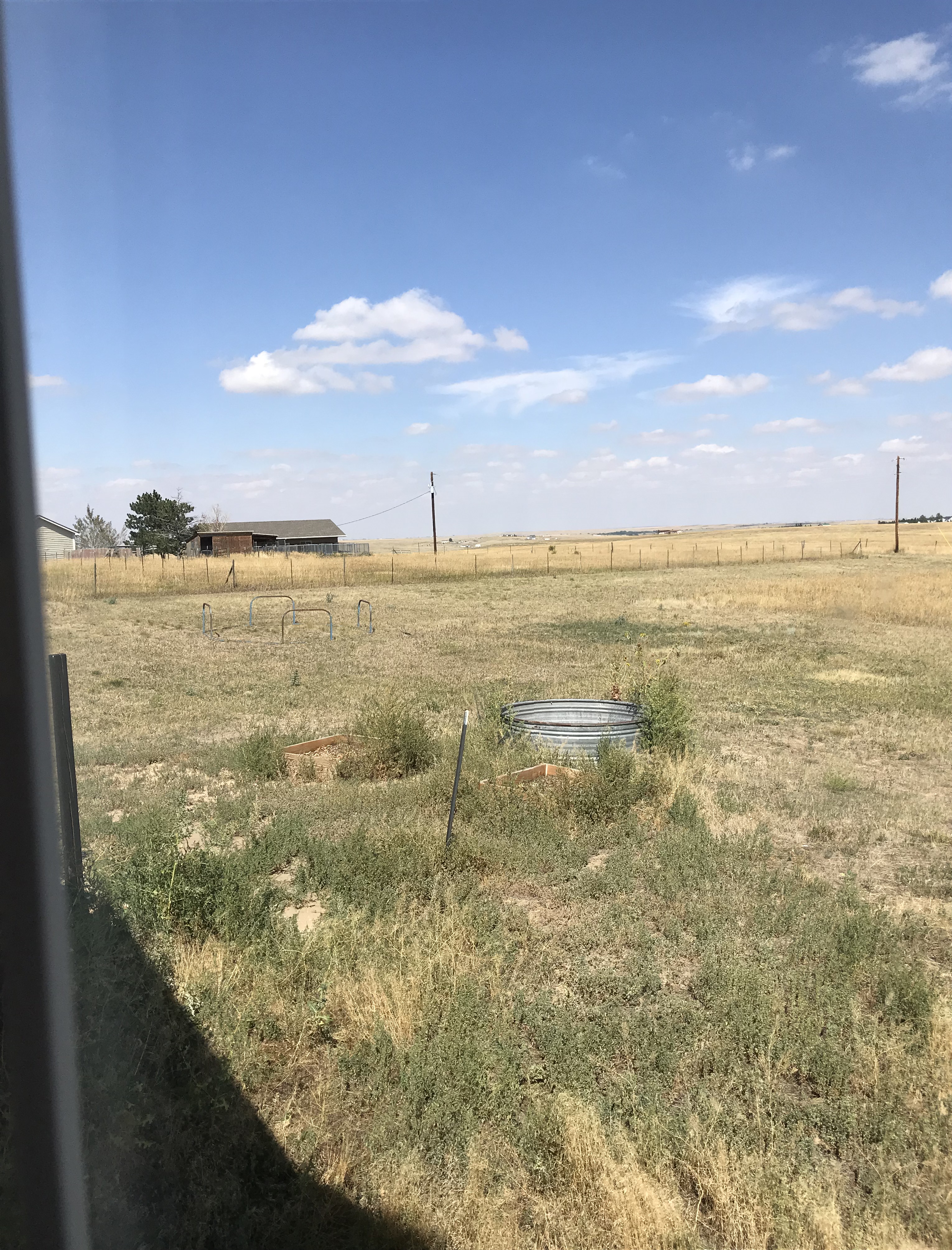

Hey All. I have seen threads that touch on this but I知 looking for advice and guidance on what would work best for my application. I知 on 5 acres with grass, hay and weeds in eastern Colorado so moisture is low and growth is slow. I have some landscaping to mow around with very few trees. I was originally looking at brush hogs because that痴 the only thing I knew but then finish mowers caught my attention. My land does have some holes, high low spots and I知 sure sporadic rocks and debris. Yesterday I was reading another thread on here and learned about flail mowers so I知 digging into the pros and cons of them. From what I gather, maintenance and cost may be higher but it is safer, leaves a cleaner cut and it better in tight areas than a brush hog? It is better for tougher land and debris than a finish mower but won稚 leave as clean of a cut. I could care less if my grass looks cut or chopped but I will need to knock this stuff down so if I can make the best of what I have I知 all game for that. I知 a tractor and attachment noob so any advice would be appreciated.

Those pictures look like either rotary cutter or flail mower work to me. A finish mower isn't designed to mow that type of stuff. Moreover, they bend and break much easier than the other 2 when you find a rock.
Rear finish mowers are meant to give the manicured lawn look. Think mid mount on a rider type finish.
Rotary cutters/brush hogs/bush hogs are meant for rough conditions and trees up to 2-3" in diameter and chop it up into a course finish.
Flail mowers are meant for mowing fields and thick tall grass but not as much as a brush hog with the small trees. They mince things up well enough to be nicer than a brush hog but definitely not a finish mower.
If you want cost effective, get a brush hog...if you want a nice job and don't mind the extra maintenance get a flail mower.
I wouldn't mess with a finish mower for that unless you plan to manicure it like a lawn.

Based on what you posted of growth, a flail will handle that easily, and much safer. Remember a rotary brush cutter can send objects flying where a flail doesn't. My rotary threw a rock about 5" roughly 100'. Had anyone been in the path, really bad injuries or worse. I have lost some blades on my flail hitting hidden rocks. But has been pretty maintenance free, other than grease and checking belts. I have wound up wire a couple of times that I didn't see when I was clearing near a fence line. Twice! Now I won't mow a new area without walking it really well first.
