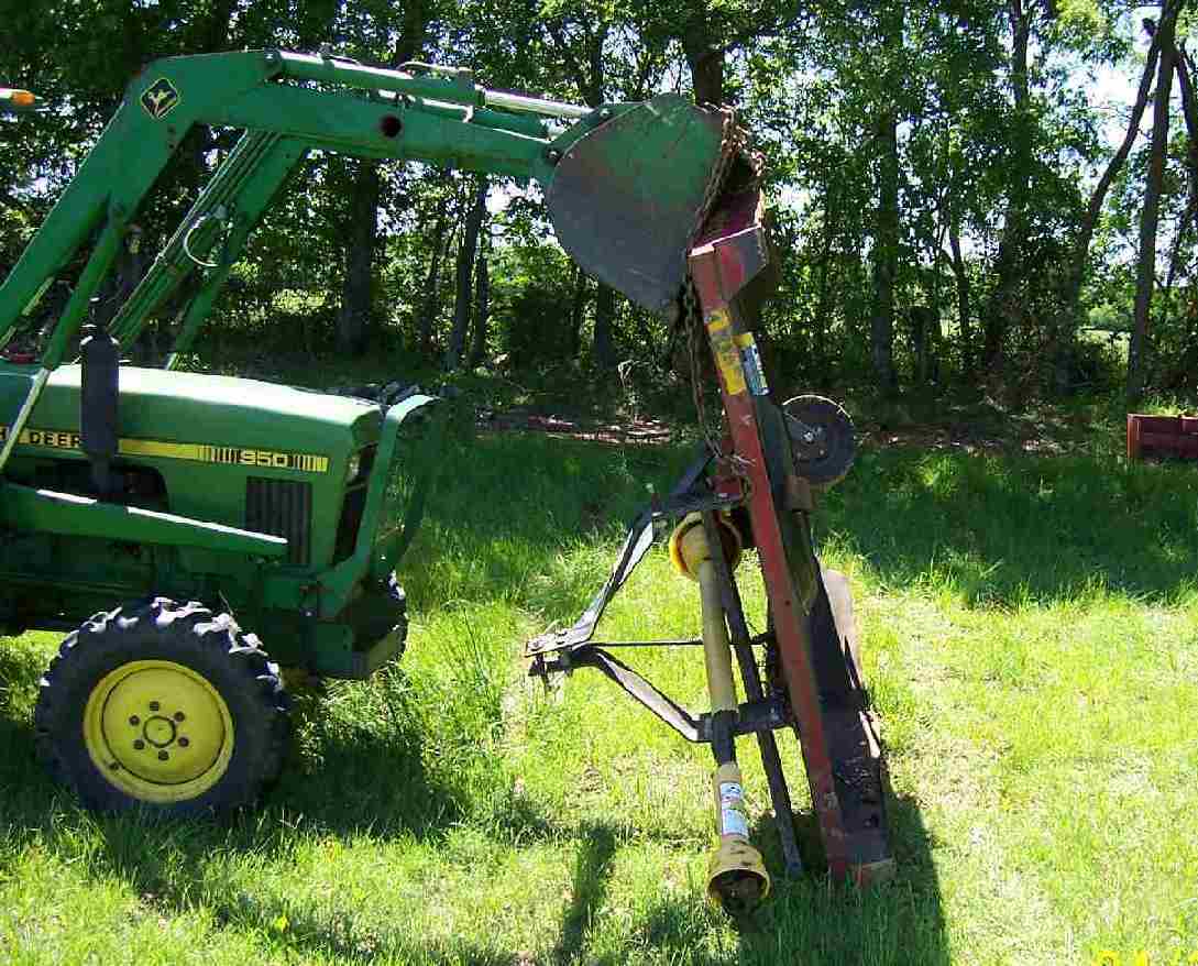

It's time to sharpen the blades on the KK brush hog however, I have noticed there is a tack weld on the nut and bolt that is holding the blade on. Is this normal?

I wouldn't think so. But you needn't remove the blades to grind them. Most folks just block the mower up off the ground, making sure it's SAFE to work with your arms under it, then grind the edges of the blades with a 4-1/2" grinder.

I thought about that, but it didn't look like there was enough room. I'll take another gander at it. Thanks.

Using a couple of chains, use your FEL to lift it on it's side. You will have plenty of room! Just make sure it is set so if the chains or the FEL fails it will fall away from you.

What Gary said.

Raise it all the way up, use jack stands for safety, done in five minutes, hardest part is locating my grinder. as far as the tack weld, it should not be a problem if you really want to take the blades off.

DCS, you probably know this but since no one has mentioned it I will. But when we talking about 'sharpening' rotary cutter blades, you don't really grind them to a sharp edge. I just take the nicks and dings out and leave a smooth rounded cutting edge.
