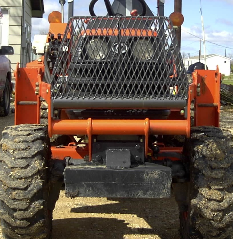

wichiwichi
Feb 12, 2002
127
Farmersville, TX
Kubota B7500DT,June 2000
I have modified the factory brush guard so that it will actually stop most brush. Added a 2" id pipe filled with lead and expanded metal. Also in the picture is a weight made of square tubing and filled with lead. Between the 2 this gives me about 160lbs and also allows use with FEL on or off. Neither interferes with operation.
   / Brush guard that works #2
wichiwichi,
Thats a great looking grill guard and certainly looks like it will do the job nicely.
   / Brush guard that works #5
Now THAT oughta guard your grill/w3tcompact/icons/wink.gif
   / Brush guard that works #6
I did something very similar (minus the weights) and have already saved my grill from errant branches a couple of times. Mine's painted orange, but your welds look better. /w3tcompact/icons/smile.gif This is something Kubota ought to offer as standard equipment, IMO
Pete
   / Brush guard that works #7
Where did you get the lead? I would like to make some front end weights
Most tire shops will give you their used wheel weights.
   / Brush guard that works #9
Gads!! I LOVE expanded metal!!
If ya can't do it with expanded metal and/or Duct tape...just ain't worth doin'!!
Nice job..very professional looking!
   / Brush guard that works #10
If you decide to use wheel weights, and melt them down to fill a tube or whatever, be very careful not to breathe the vapors. Sounds elementary, but I got sick for a long time as a result of melting lead wheel weights to make ingots to put in the bow of my boat. I thought I was being careful, turned out I wasn't. So stay outside and upwind!
