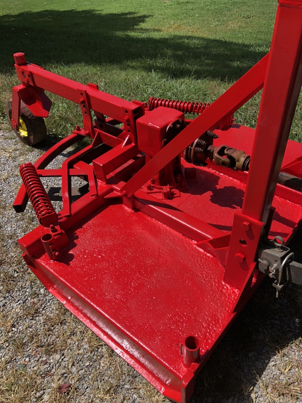

Fresh paint on our 25year old Brown tree cutter.
I like the size of this one. Called a tree cutter?what size is it

Google Brown Tree Cutter. They are very expensive compared to a bushhog, but they are designed to cut that 3-4" stuff. Yes, a bushhog will, but it won't cut a wall of it, without either bogging down to the point the blades don't cut, stall the tractor out, or break something. I dont think they ever made a 4 ft model (or atleast they don't list one of current products). They are awesomeness, but you probably won't be able to use a 5 ft one without some pretty serious front weights. I see one locally (6 footer) for $3,000 OBO, in good, use not pretty condition. New, that is probably close to $12,000.

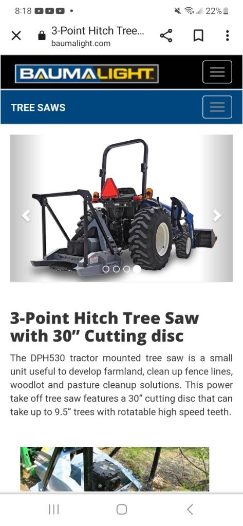

No knowledge abiut them, but there is a Bramua Tree saw, 30", only weighing 700 lbs, for like $3000 new. Didn't do much digging to see how the front of the 'Saw' body is, and whether it works like a bushhog in forwards
