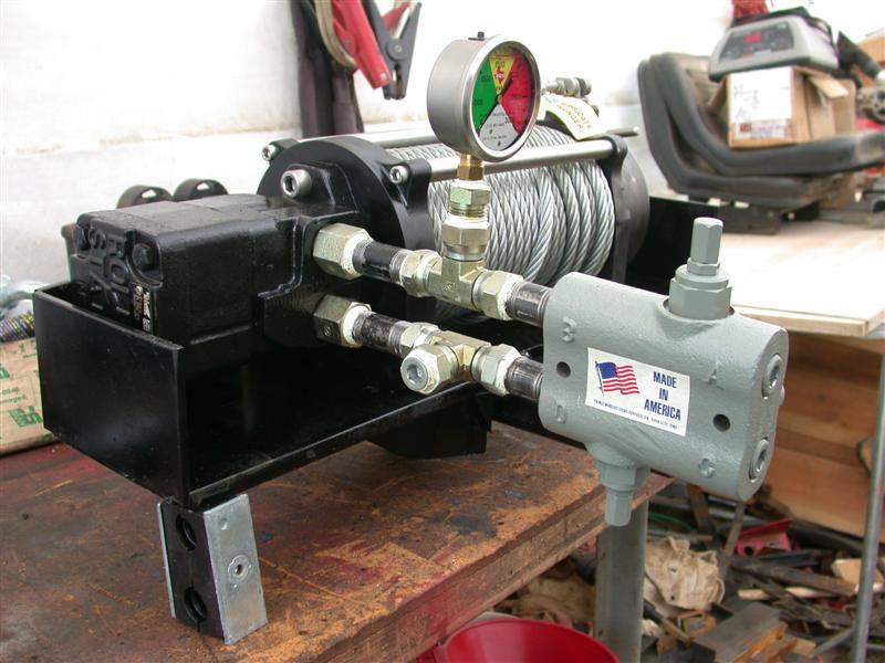

As far as the cushion valve, you can use a single relief valve if you will be turning the hyd motor only one way.
The fluid flows straight through the valve , until a control valve is closed, and if this is done at a fast rpm. the motor will try and run like a pump,and no where for the fluid to go, and things will break. What the relief does is to relieve the pressure off the motor, by sending the fluid back to the input of the motor.
With the double relief cushion valve, The valve is installed across the motor input and output hoses, so that is you were to use the hyd motor in reverse, such as a auger, you are protected both ways.
Installing and using the open center motor spool valve. Remove the foot control aux valve, and install the solenoid valve, and wire up a switch to run it in forward or reverse. You will have to use a sub plate with the solenoid for the hose connections. Supply hoses in, and two hose out that feed the flat face Quick disconnects.
If you so the solenoid thing, you will have double protection, because the solenoid motor valve allows the fluid to recirculate through the valve in neutral until it has wound down. If someone were to hook things and one of the QD were to fail closed, and close off fluid flow, then the relief valves by the motor would protect it.

The picture below, shows the double relief valve on a hyd motor that is mounted on a winch. One of the guys on here put that together, I believe 3RRL.
