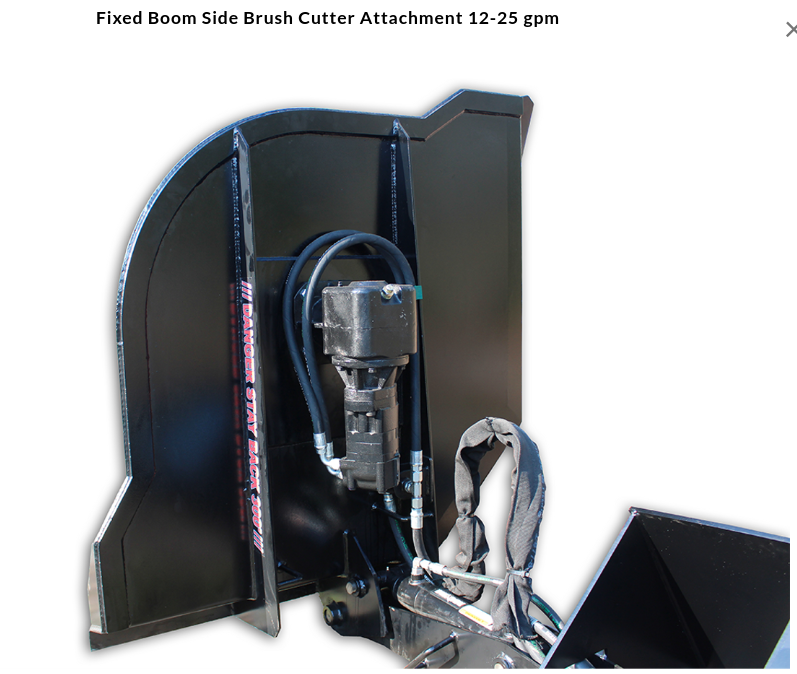

I’ve been talking myself into a front mounted brush cutter and exploring some options. One thing I’ve noticed is a couple of the manufacturers may not be using a cushion valve on the motor, rather just teeing the lines. One side of my brain says that can’t work very well, the other side says but you’ll save ~150 bucks.
‘This is not to berate anyone else’s build, noticed on this one and the lane shark, just wondering how the T would work. This video clearly shows the arrangement at the 14:13 mark,

Yes, it's T but between both T's, there is a check valve. This check valve will allow the hydraulic motor to spin down on it's own, instead of an abrupt stop that would most likely blow the seals on the motor. It will also prevent the motor from rotating the wrong way, even though it's not usually an issue with brush cutters.
Both setups will technically do the same job, albeit in a slightly different way.

Looks like this setup uses the 3rd function, so when you release the button, both work ports of the valve are blocked.
Basically when you turn the cutter off, the inertia will turn that motor into a pump. With the check valve, the fluid will pretty much flow between just the motor and the check valve, pretty much making a small circuit up to the Ts.
The cushion valve uses two relief valves that open to the opposite side. Once there is a pressure spike like when turning the cutter off, it relieves the pressure to the other line. Using this valve, will allow for a faster slow down of the motor without blowing the seals.
Adjusting the relief valve on the return side of the motor, adjust how fast/slow it will take to fully stop the blades.
While with the check valve, it will coast down a lot longer till it finally stops.
Either way is fine really and both ways prevent the seals from blowing out.

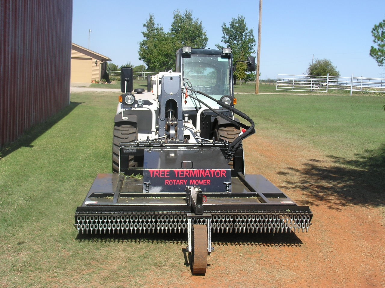

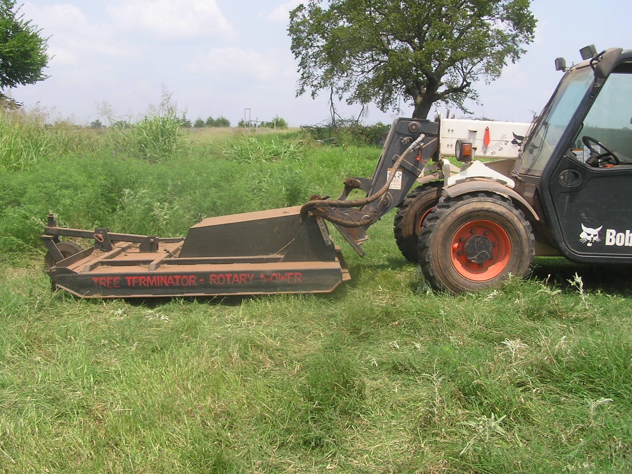

One advantage of a hydraulic front mount brush cutter is the blades are sharp on both sides so it can rotate either direction.
Here is the new version of mine: Tree Terminator Rotary Mower
Got my 7' in 2009:
Still using it now:
The hydraulic motor has a built in cushion valve:

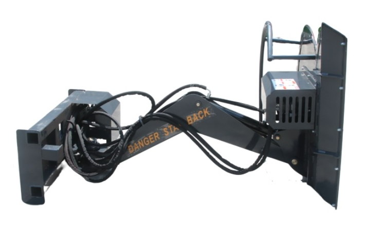

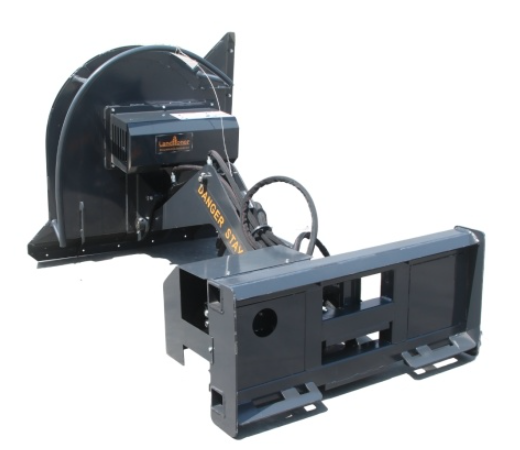

I have a Lane Shark, can confirm that the WR Long 3rd function hyd kit comes with a separate return line to prevent overheating the fluid. It takes a while to spin down after deactivating. There are a few videos explaining the plumbing and reasons for the design on the Lane Shark website.
My grapple is currently attached, but the green capped line is the Lane Shark return line:
My primary use has been turning it 90° and running down our trails to getting up high & trim back branches; It also does a great job of cutting back thick brush / vines working from the top down when set flat out in front.
It's definitely not the end-all-be-all tool for every job, but fits my specific needs perfectly.

Thanks Yes, that’s a big part of it, always need more than one thing to do the job. Yours works pretty well on your DK? How far does the deck sit out from the front tire at 90? maybe the answer for my desire is a lane shark type in front and a 6-7‘ flail in back
/ Brush cutter opinion/help #13
It has worked fine on my tractor; When flipped 90°, it sits out a few inches outside of the front tire. If you do a youtube video search, there are several videos out there showing it in different configurations on different tractors.
I don't have it attached at the moment to give you exact measurements, but I'll add some older pics when I had it in different configurations, if that helps.
