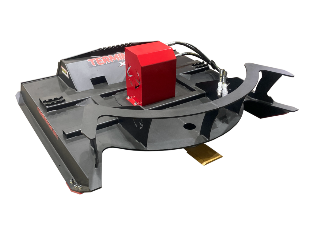

This is what I want to run.

Should be roughly
Estimates
$300 for tank set up
Cooler $450
Filter $50
Hydraulic lines and fittings.
Maybe $400 not sure
The price of pump when I figure one out?
Build my own brackets the way I like.
I assume that is all I need. If I could ever find the right pump I’d be in business.
Or could order one of the prefabbed kits but they are priced at $4500-$6500
I just need the pump.
