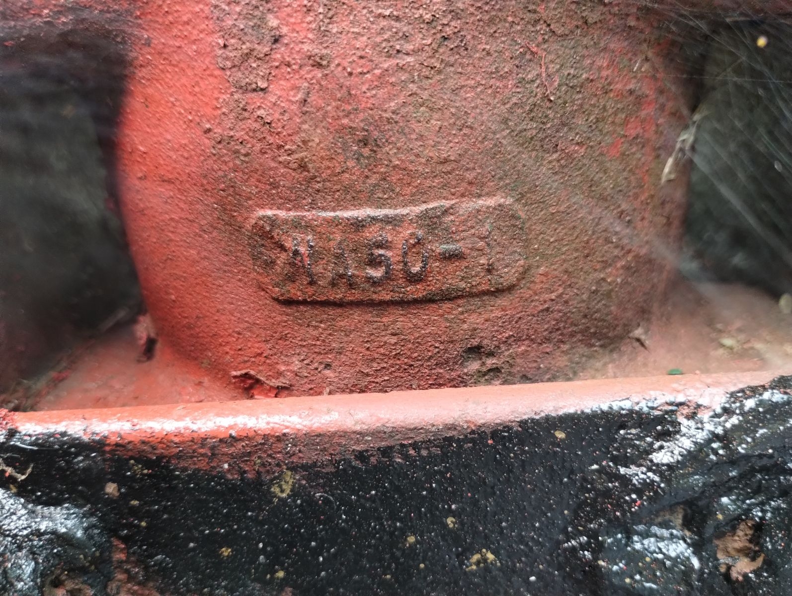

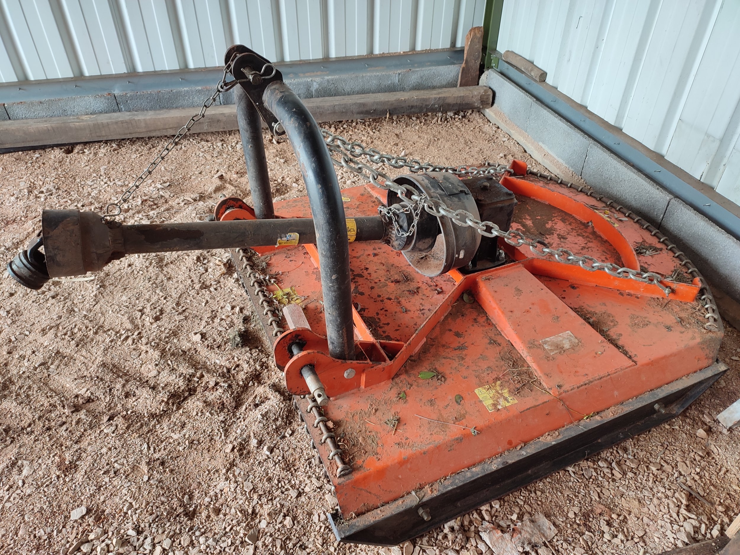

Hopefully someone can shed some light on a brush cutter I recently purchased. I don't know the make or model. Couldn't find a tag or label. I do know the original color was green. I have attached pictures for review.

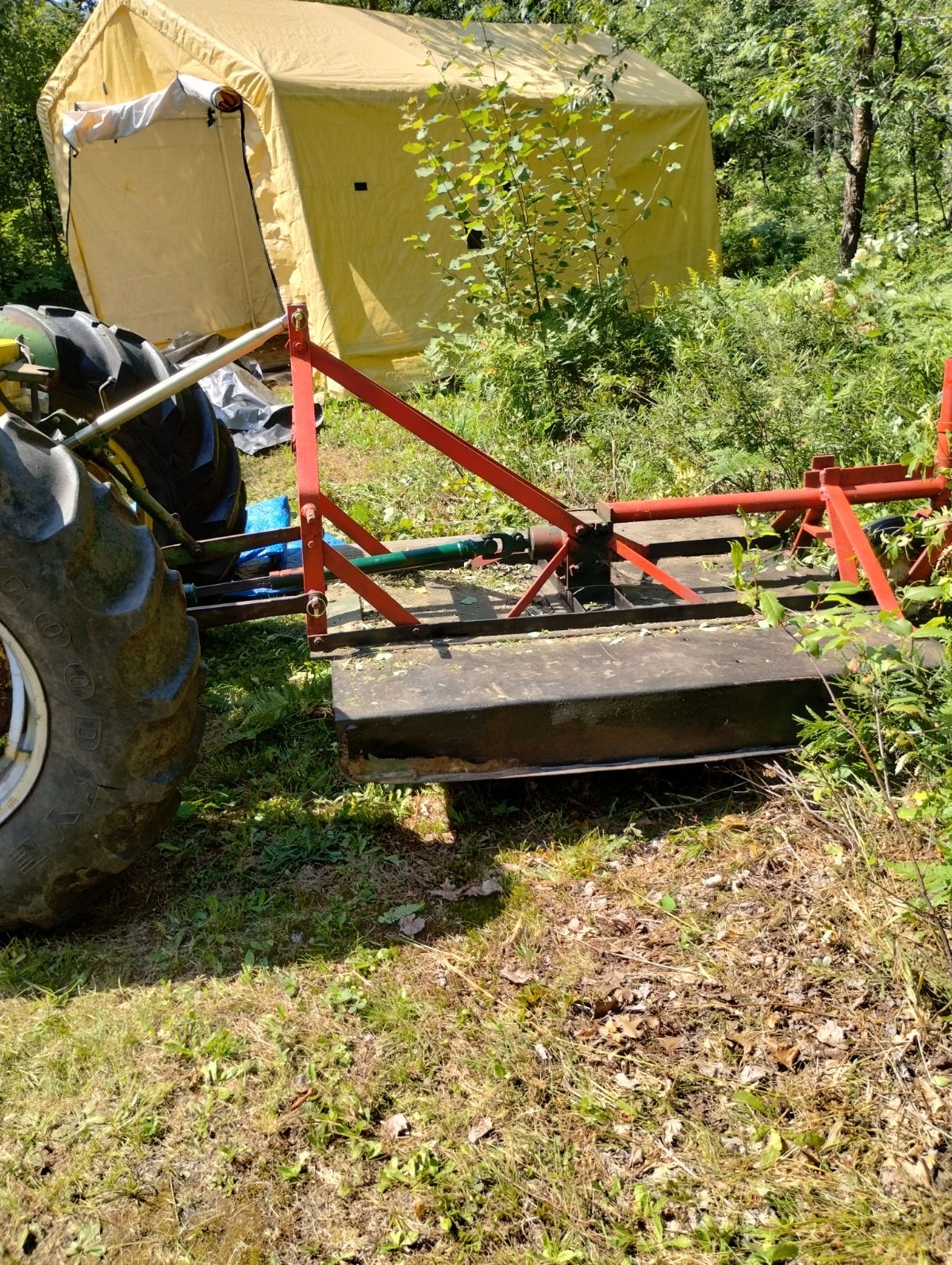

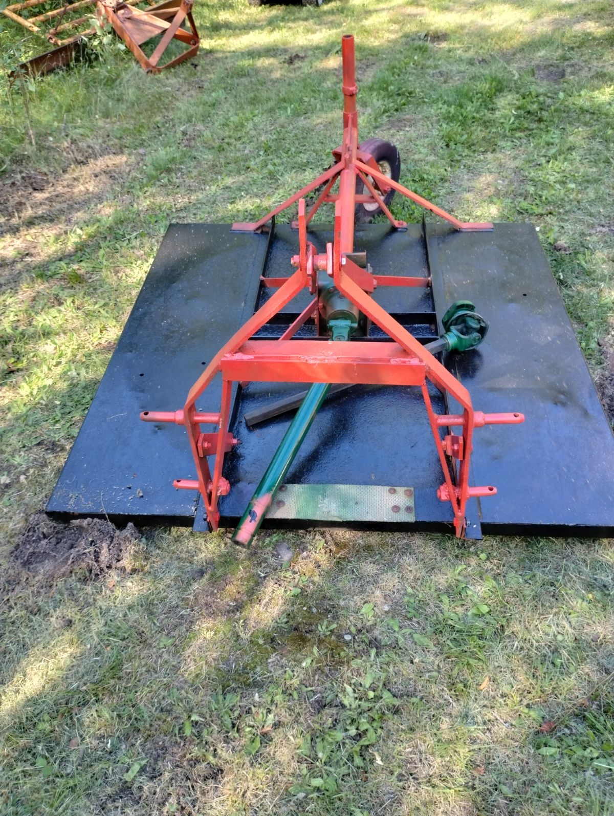

Sorry about that .... Here they are!

If you look at the photo "paint" you can see pale green paint on the side. There is a tag on the front of the gearbox but it is unreadable.
   / Brush Cutter Identification #5
Sorry cant help with the ID.
I would almost bet though, that its obsolete, and you wont ever get parts for it even if you could ID it.
IF you do ever need parts.....its just gonna be a match up by size. Like blades, or an aftermarket gearbox or tailwheel. Really thats about it....the rest is just metal to need fabbed or welded if it breaks
   / Brush Cutter Identification #6
It looks homemade to me, but others may recognize it.
One point -- that looks like a rigid top link, and there is no give visible anywhere in the frame. If so, something's likely to bend or break when you run through a dip.
Thank You. I have used it and it works well. I was wondering if I should add the bracket like they have on the King Kutter where the top link attaches.
   / Brush Cutter Identification #8
I'd think a link like that, or even just a length of chain instead of the stiff upper arm, will work.
   / Brush Cutter Identification #9
+1 for the chains. Ditch the bars and run some chains. Brush cutters shouldn't have bars in there.
