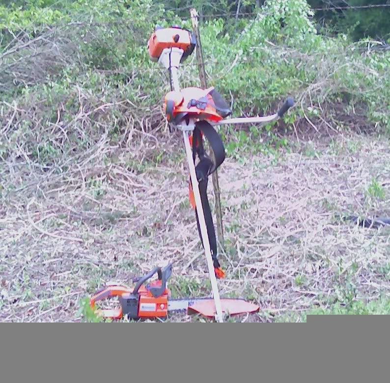

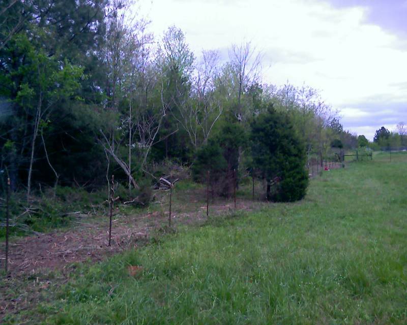

I find them indispensable, especially under fence rows. In fact I use the 3 bladed brush knife blade 3-4 times as often as I use the string head. Here are some before and after photos of some fence rows I cleared out using a Stihl FS-250 and a brush knife blade.
