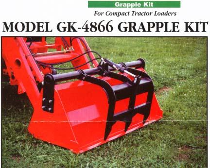

Sounds like you have found a very useful piece of equipment. Did you build your grapple for your bucket, or find a factoy one? Sounds like this could come in very handy for a lot of things.
I built a grapple of sorts for a set of forks I built to load brush or logs on a dump truck, but can see many uses for other types of grapples.
PS
I would like to see a picture of your grapple, or one like it.

I have been very impressed with it so far. While it does add a little weight to the FEL it is worth it. I do not have a picture of my tractor to post but the grapple can be seen at -<A target="_blank" HREF=http://www.pfvirtualfarmshow.com/new_products/1101a.asp>Grapple </A> is made by ATI Corporation and is specifically for compact tractors. Mine does not look quite like the picture. We added about 6" to the brackets on the sides to raise the unit up and increase the bite, so the torque tube is about twice as high above the bucket as shown in the picture. The only complaint I have is the hydraulic tubes hang down behind the bucket (lots of slack is required for rolling the bucket). While they have never really gotten damaged or in the way, I would prefer to have them under better control. I am thinking of putting them on an elastic cord that will hold them up but streach to allow for movement.The control lever is mounted to a plate and stalk beside the loader control. It took about an hour to learn how to operate the loader and the grapple togeather with one hand. I finally have it down and can roll the bucket and close the grapple at the same time. Not incidentally I have welded chain hooks on both ends of the top of the torque tube and this allows better control and leverage when lifting loads. Besides improving handling of brush, loose materials can be held in the bucket without spillage. The bucket will now hold about twice the normal capicity of mulch as without the grapple. Also as you might imagine, you can grab any size log that will fit into the mouth of the grapple. Combined with the tooth bar, I can now grab logs in one try that I used to have to chase uphill until I could get the bucket under them. Some that were so large that they simply could not be picked up are now piled neatly waiting for fall cutting.The grapple does run on the tractor hydraulics, but it does not take much flow. I would recommend this attachment for anyone that handles brush, logs, and mulch, with or without a tooth bar. On last thing. Put quick detach fittings at both the control valve, and the FEL bucket end of the lines so you can remove either the loader or the grapple when you need to.I have attached the picture from the above website (sorry I do not know how to put a link in these posts).
