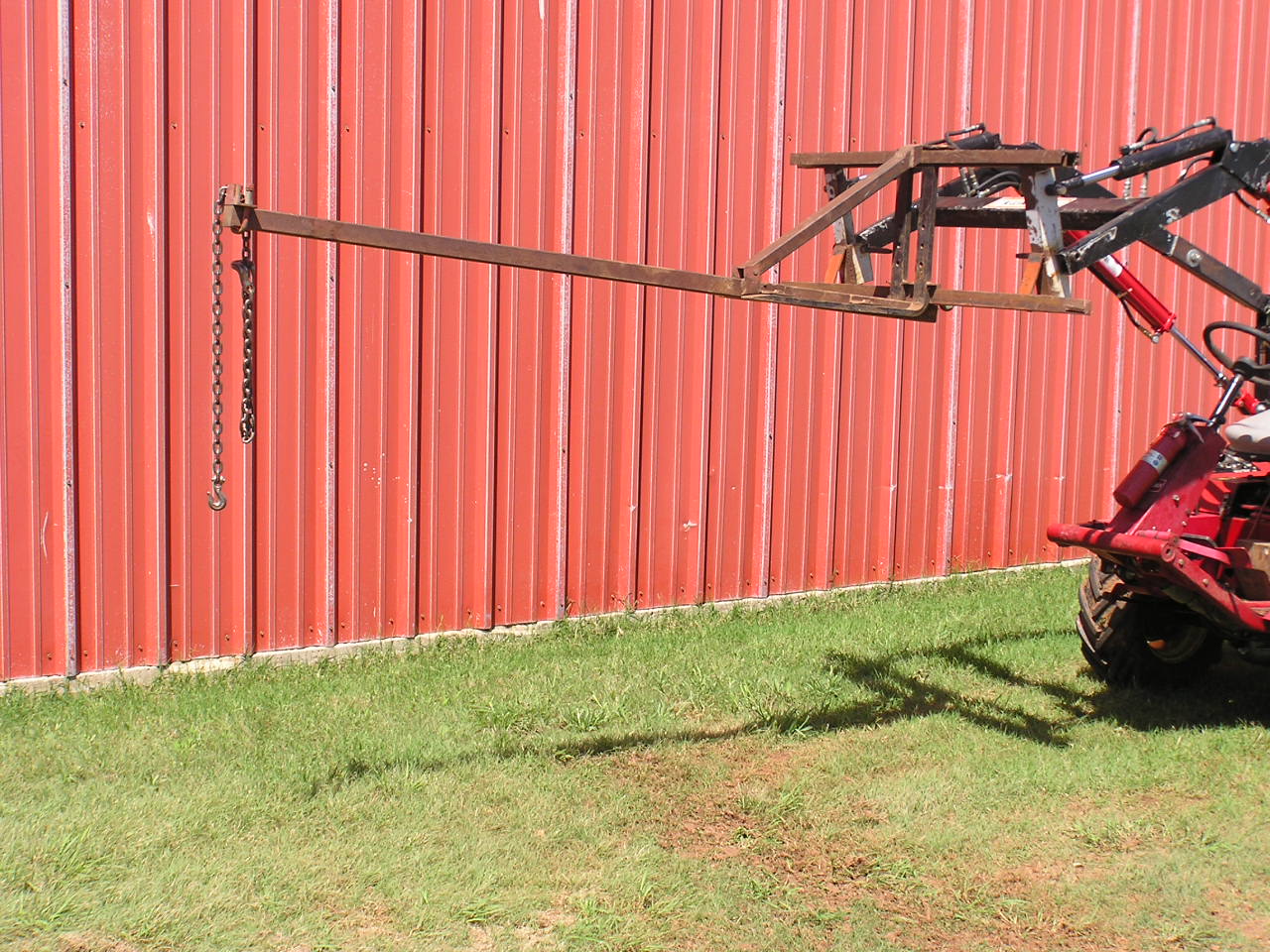

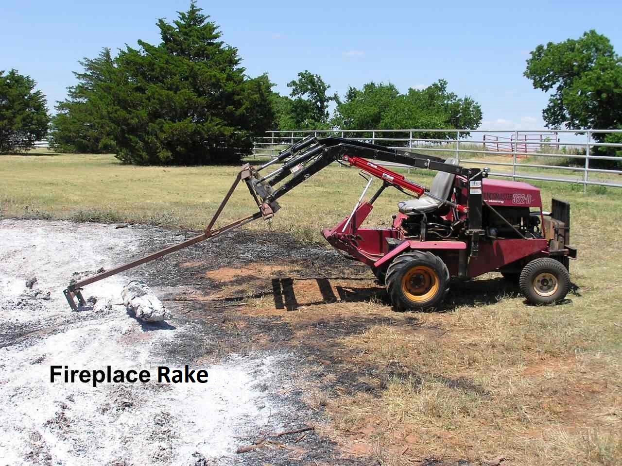

I'm burning a couple of large piles of brush with stumps, trees, etc. I put them in sink holes over the years. There are two problems though. As they burn I'd like to be able to push things together for better burning, but it's too dangerous, stuff on edge of an 8 foot deep sink hole. Other problem is even if I drive around another way...in from bottom...the hot coals and logs burn the FEL bucket.
Is there something simple I can fabricate for this? I drilled holes in bucket for a tooth bar...maybe something out like two 6ft. steel bars, another angle iron across. Do they make such a thing, or better ideas?

Image in my brain seems like clamp on pallet forks with a piece of steel plate (heavy screen?) mounted vertical at end as push plate ...

If it really is an 8' deep sink hole and dangerous by your estimation to push with your tractor, you best leave it to burn and when the fire is out a few days later do whatever you need to do with a rake. You make one mistake and you have a roasted tractor, not just a bucket, and maybe you to!

Burn your stuff up on the flat, and push it in when it's done burning?

Check with road departments or contractors in your area to see if you can get an old piece of guardrail. Use your holes or whatever to mount that, maybe backwards, concaved side forwards.
   / Brush burn attachment??? #7

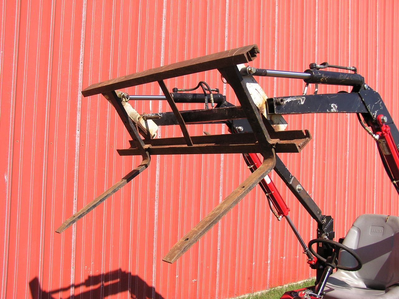

My Fireplace Rake:
Sets on the forks latches to the top of the frame:
