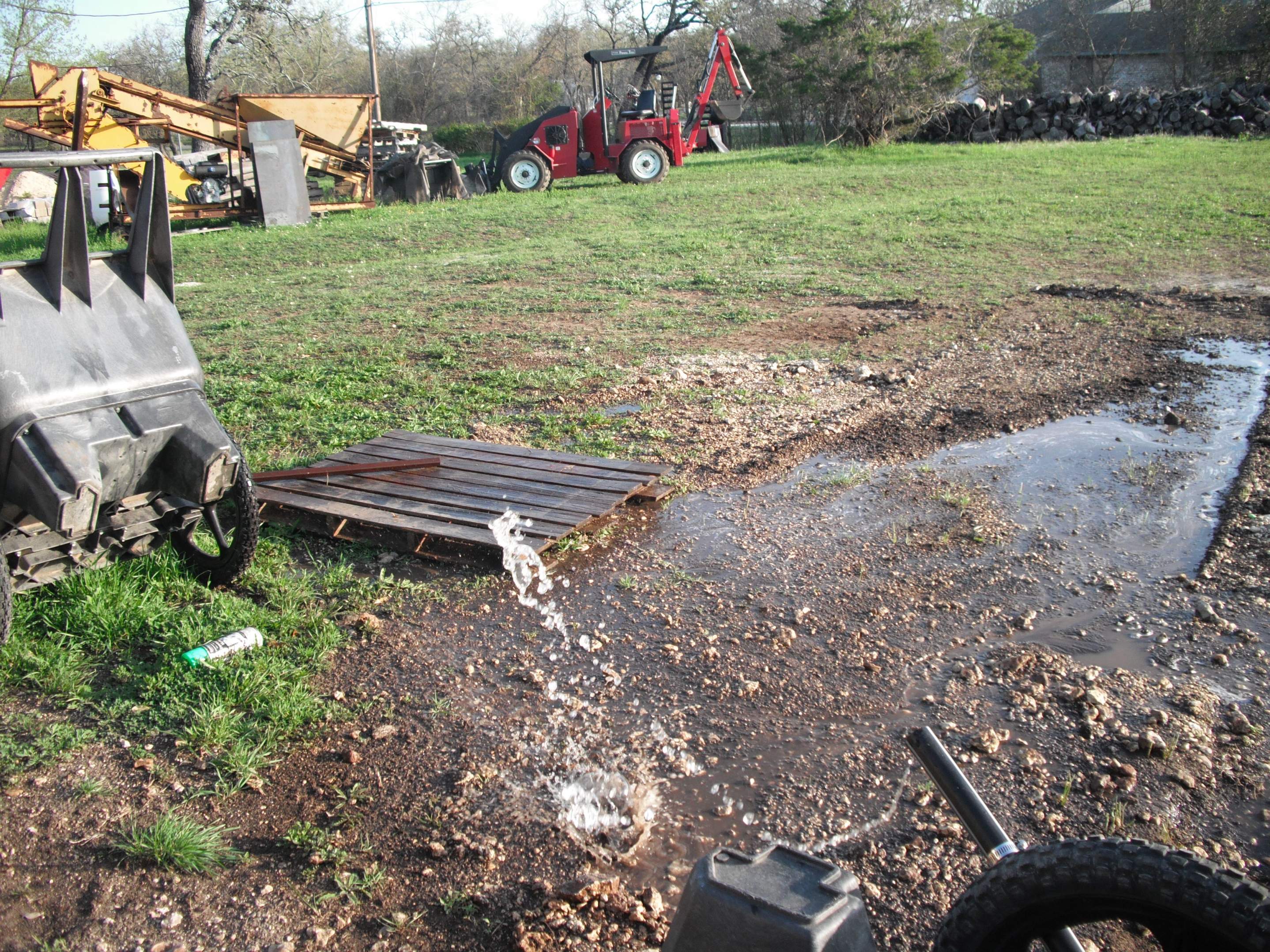

/ Brumby Pump #15
Here are a few pics of the pump in action. (cannot download movie)
400' down
about 270' to water level
compressor set to 50 psi
1" discharge pipe.
3/8" > 1/2" . 1/4" air supply line
The pump is about 14" long and about 1 1/2" in dia, made of SUS
You can see the water comes up with the air bubbles. The discharge is not constant but follows the air bubbles.
Rgds,
tim

Thanks for the pics
That's a really cool set up ,and I like the idea of not having to replacing expensive parts that are down a hole.
Got to get me one!
