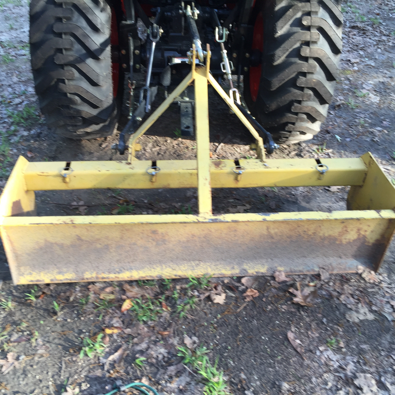

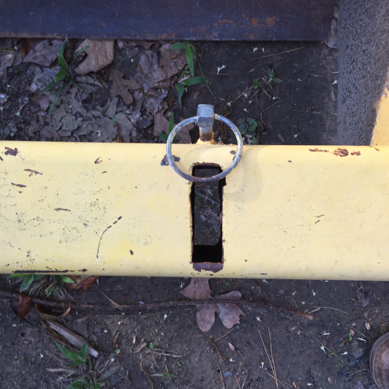

I bought a used cheap box blade but is has not scarifers. Was going to buy some but for the life of me I can't figure out which ones or how to attach them. Attached are pics - any ideas?? Someone welded on lynchpins which have some thing to do with the scarifier attachment but I can't seem to wrap my poor ignorant head around it. Thanks for any assistance.

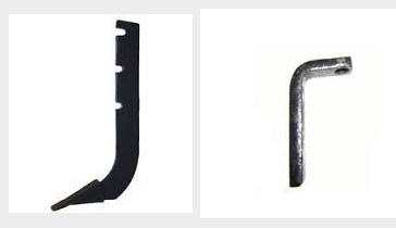

I uses this style scarifer with a square pin dropped in behind it, to hold it forward in the notches.
The spring ring like a lynch pin, holds the special made square pin in place.
   / Brought a cheap *** used box blade - what scarifer? #3
As above, notched scarifier and locking pin, not in scale to each other. The linch pin goes through the locking pin hole to hold it in place.

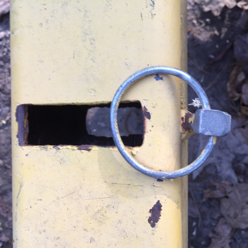

His is a little different. the lynch pin is welded on, only the ring is used. I couldn't find any pictures of the square pin.
   / Brought a cheap *** used box blade - what scarifer? #5
I thought the pin was through a loop or eye, but a closer examination shows it to be welded, as you noticed and I didn't. It looks like it would use the spring tension of the ring to hold the scarifier forward.
Bruce
   / Brought a cheap *** used box blade - what scarifer? #6
The spring tension of the ring holds the square pin in place.

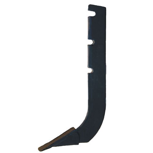

Thanks for the answers guys. So I am assuming the square pin is a wedge? I am a little dense so a photo of the attachment method would be appreciated. It doesn;t have to exactly the same but I am a very visual person. Thanks!!!
   / Brought a cheap *** used box blade - what scarifer? #8
#9
Thanks Brad!! I owe you one.
