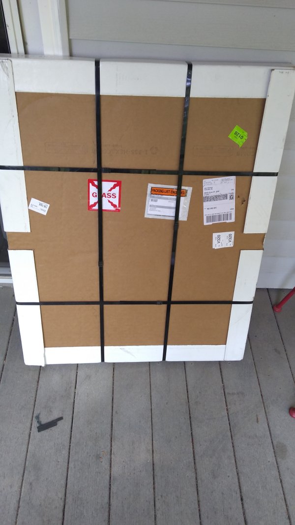

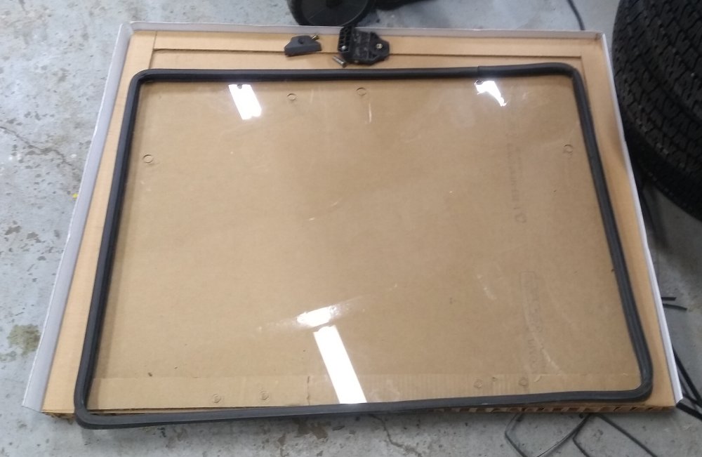

#17
New windshield came in, in one piece, and it appears to be cut and drilled properly.
Pics of the shipping box, the glass on the floor with the weatherstrip installed.
Right now it's bolted to the tractor, hanging from the hinges, looks like all the holes line up and are the right size.
Will post pics when it's all done.
Not bad for $188 delivered ... about 1/4 the cost of the same part from Curtis Cab.

Windshield is installed. Everything fit perfectly, even the old weatherstrip. All the holes right where I wanted them. About $500 less than the OEM Curtis part for the exact same thing, same thickness tempered glass, etc.
