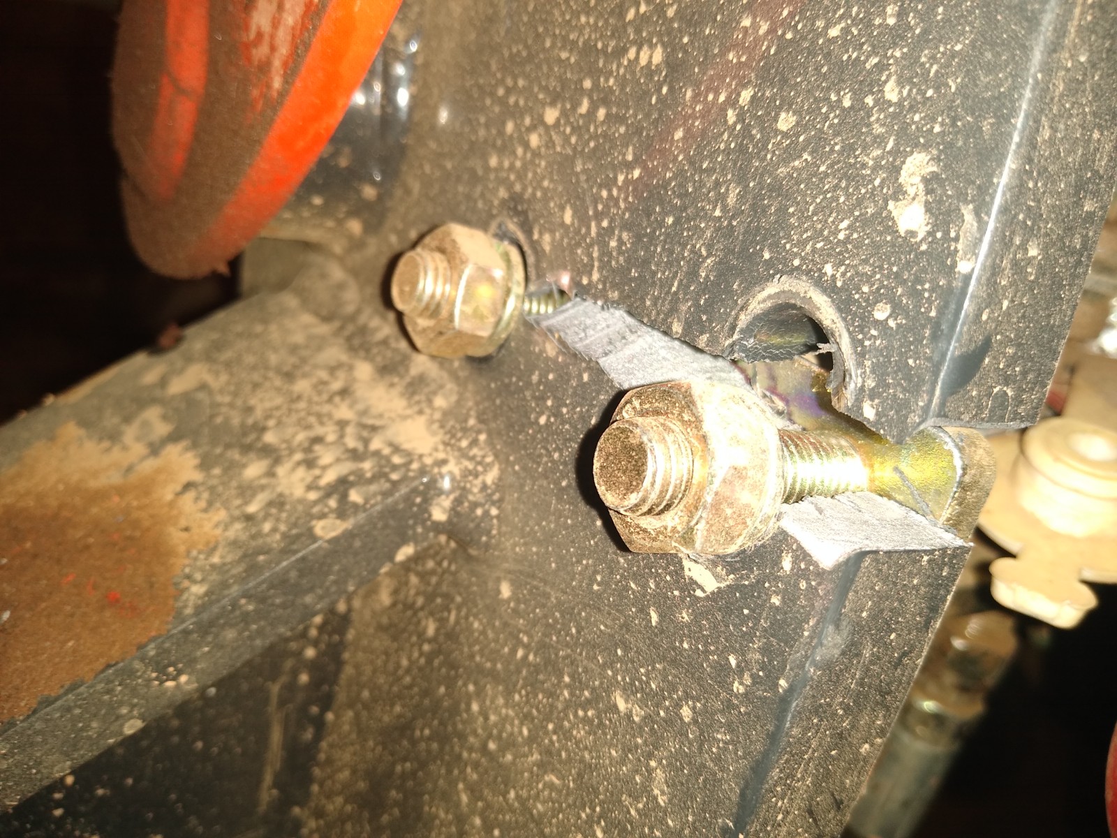

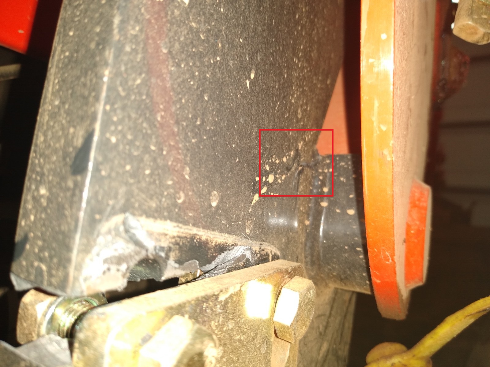

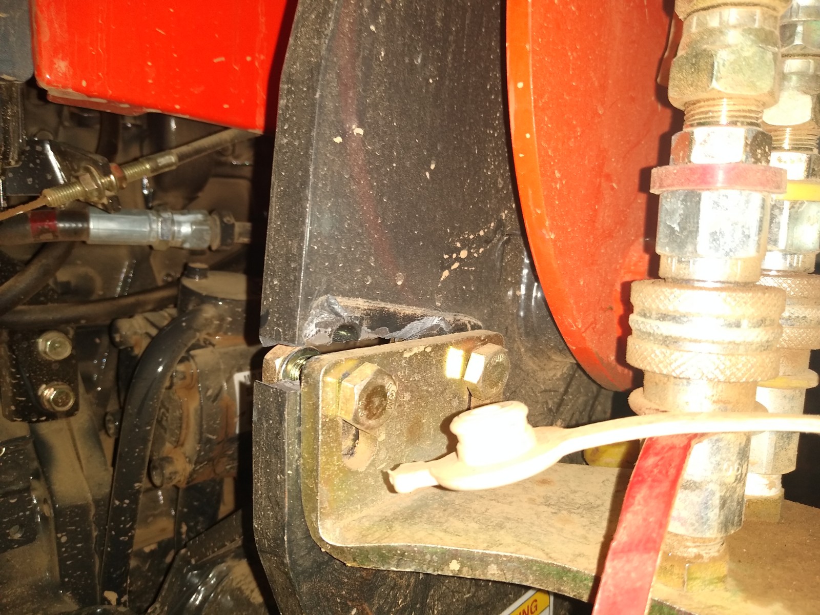

Totally bummed! I've got a CK2610H with KL4030 loader at around 185hrs. I noticed that the loader arms were askew while working yesterday and found that the right side loader mount bracket is cracked. We got the tractor back in June so the loader is still on the 12mo attachment warranty. I'll contact the dealer about it on Monday. What do you all think about this being covered? If the parts aren't readily available, what kind of downtime should I expect?

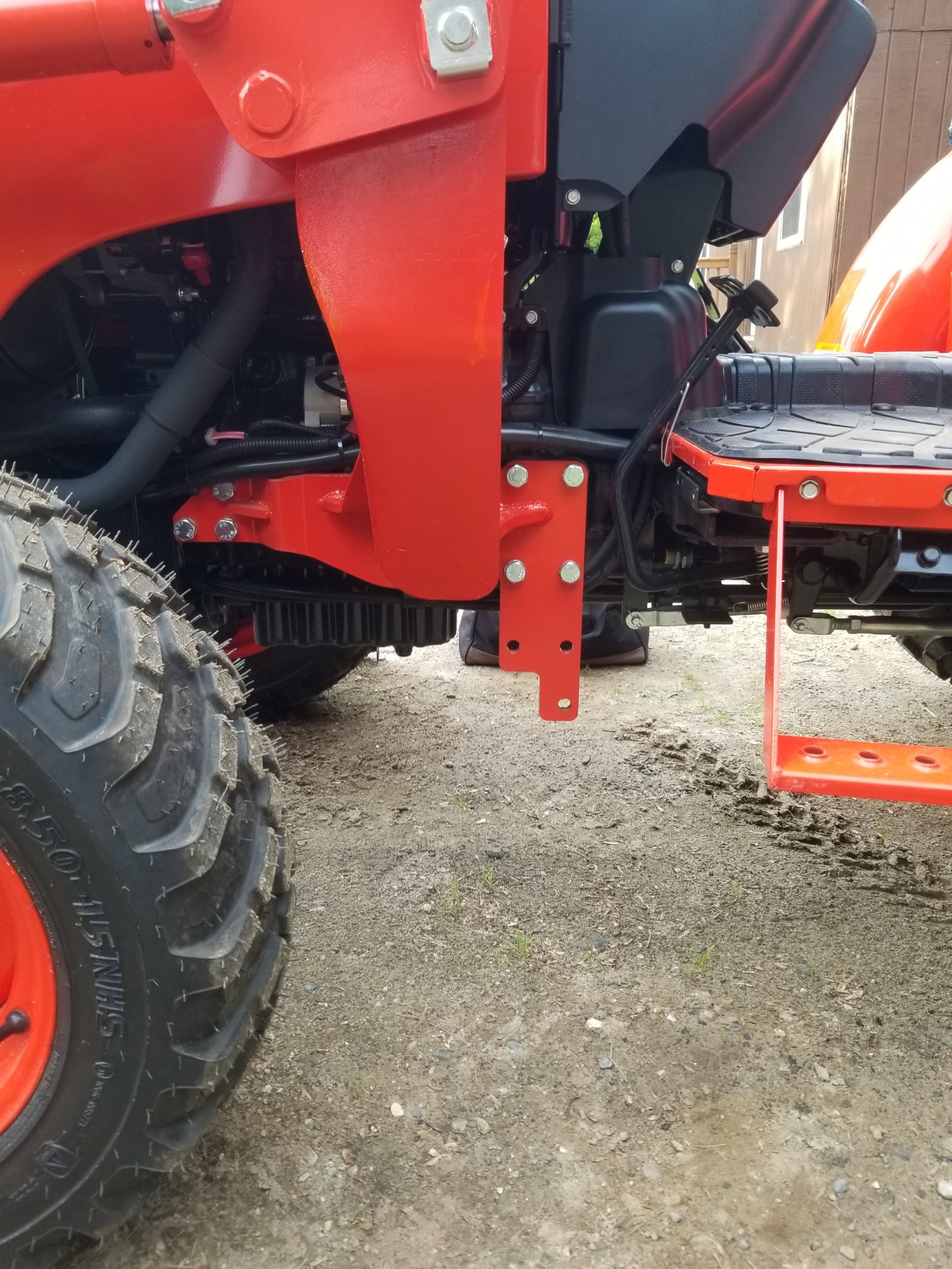

My other options are to buy a new bracket. The partsfiche on Michigan Iron and Equipment lists parts for the KL4010 and 4020 loaders, but not the 4030. M3510-51111 is the right side bracket for the KL4010 and appears to be similar to what I have on the KL4030. I have an email out to MIE to confirm. $640 though...
Or, my friend is a skilled welder. He can weld it back together and add a gusset, if we can bend it back to where it was. I'm hesitant about this option as it looks like the whole plate is weakened. In addition to the obvious crack, there is another one on this plate close to the pivot, which I've highlighted in the pic.
Two of the hard hydraulic lines with the T-fitting on the right loader arm caught the brush guard on the tractor when the loader was lowered while askew, so those are bent and one has a slow leak. Not sure if I can bend them back and tighten the fitting back up, but if not the two replacement hard lines are around $100.
I have the same exact problem. Moving dirt and the loader mount broke causing the loader to fall over to the left hitting the hood and brush guard also causing hydralic lines to hit and start leaking. I was doing normal typical tractor work on two flat ground acres (no abuse). The 1st thing I did was google Ck2610 loader problems to see if anyone else had the same issue and came across your post. Identical to mine! I called my dealer and he said that he seen it before in person and saw other issues on the internet. Immediately he said that the bolt holes are creating an area of weakness on that mounting plate. We both agree that a recall should be done with an updated mounting bracket with more support. He said it should be covered under warranty. He currently has my tractor. I hope they get it fixed! Im still curious if they will take care of the damaged hood and brush guard as well. Ill keep everyone posted!

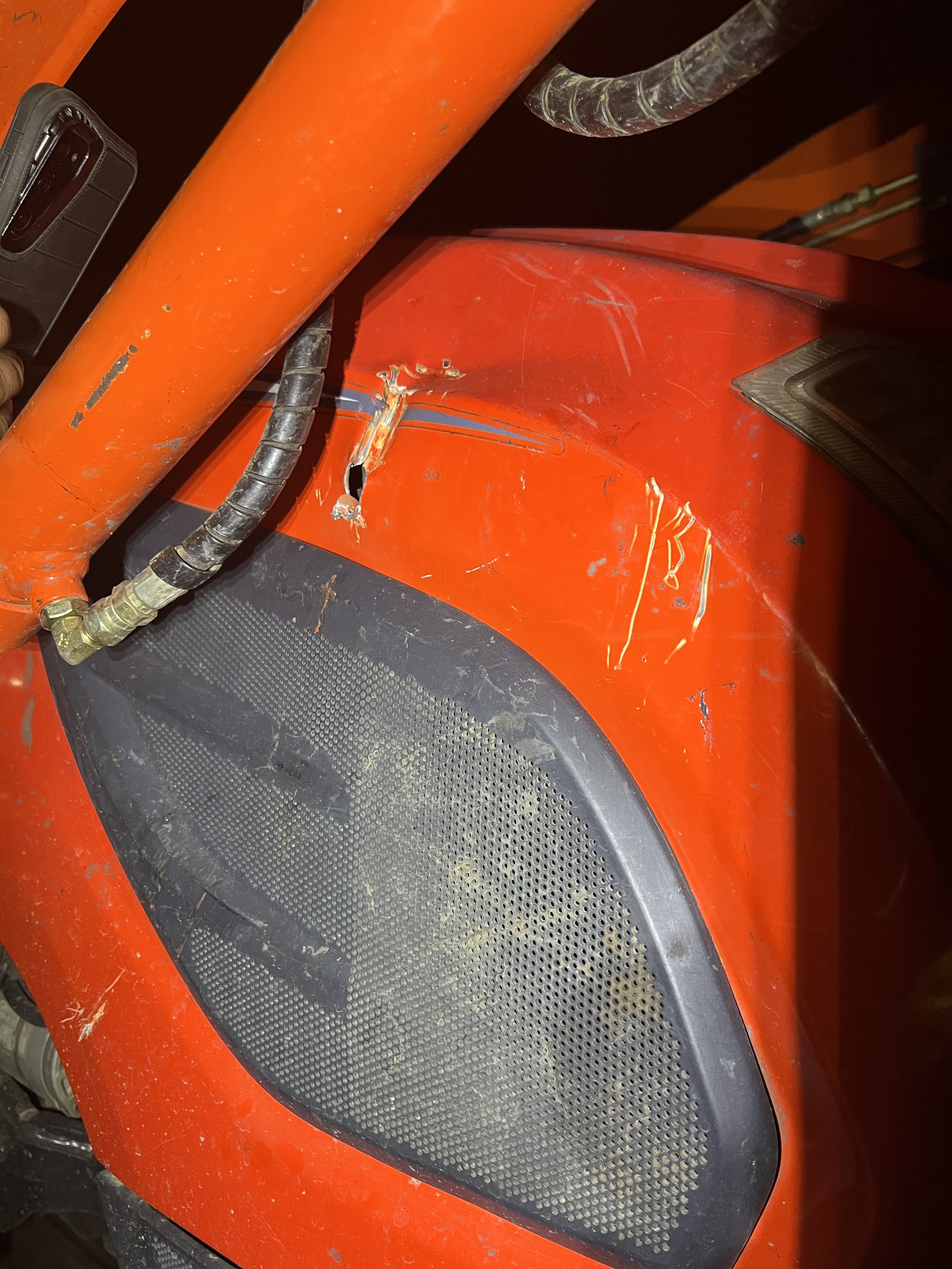

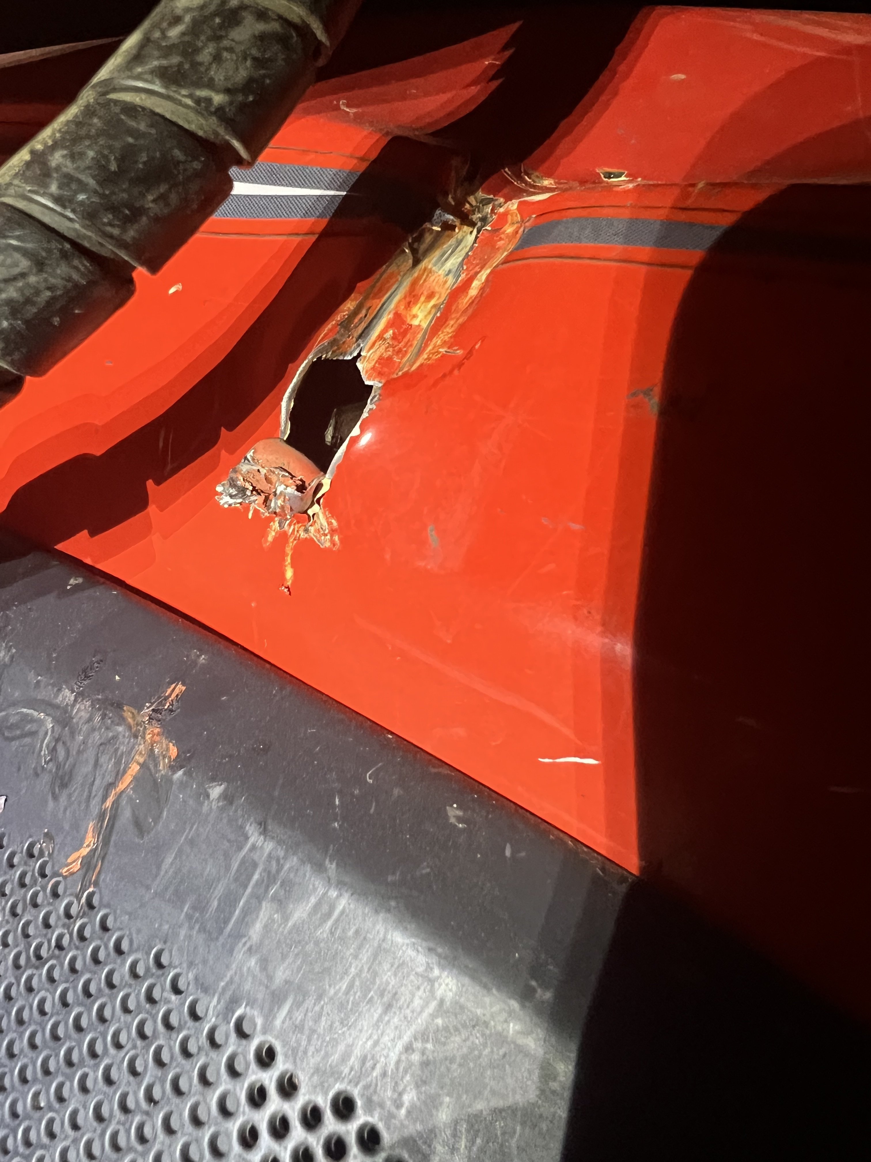

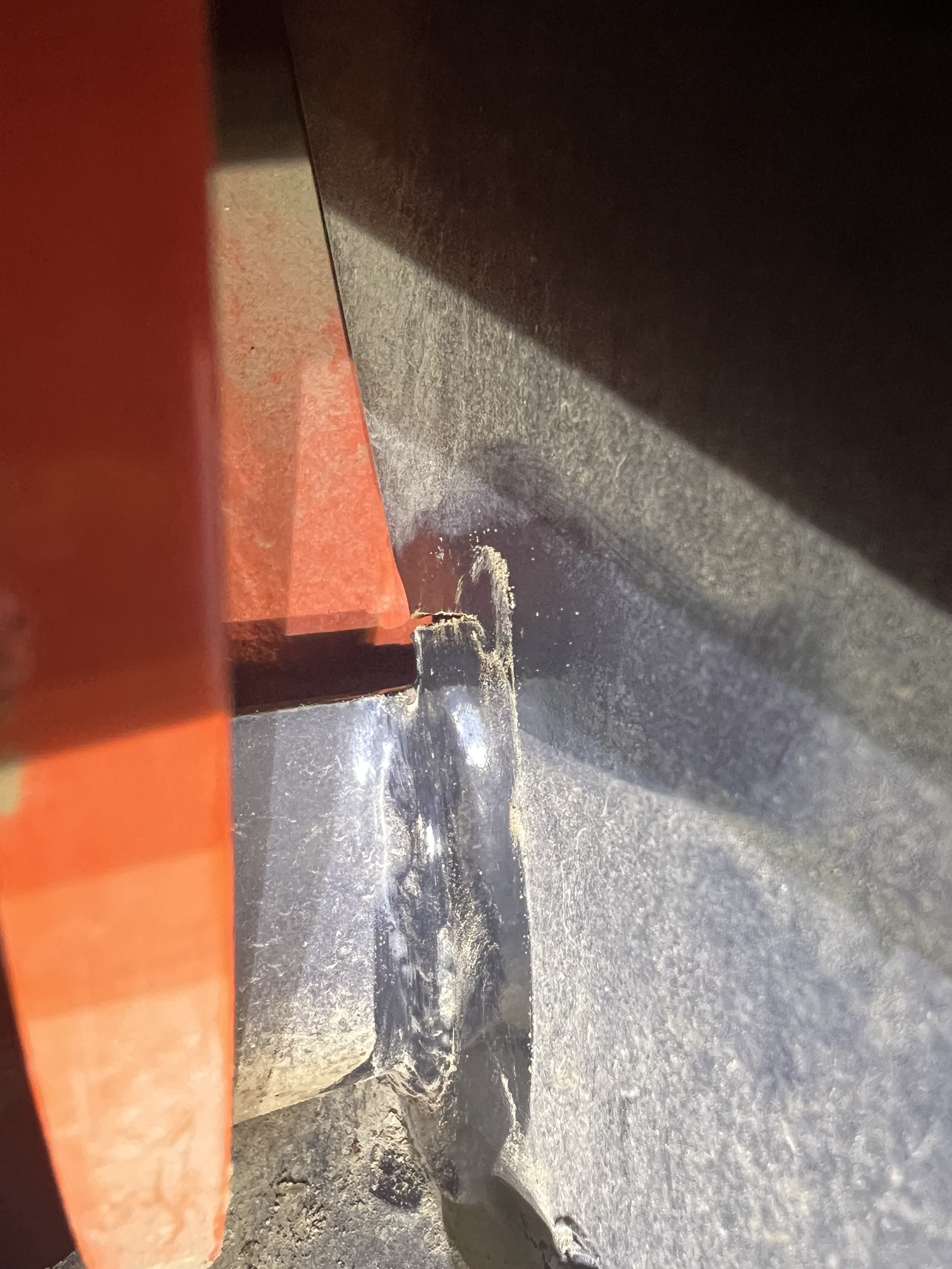

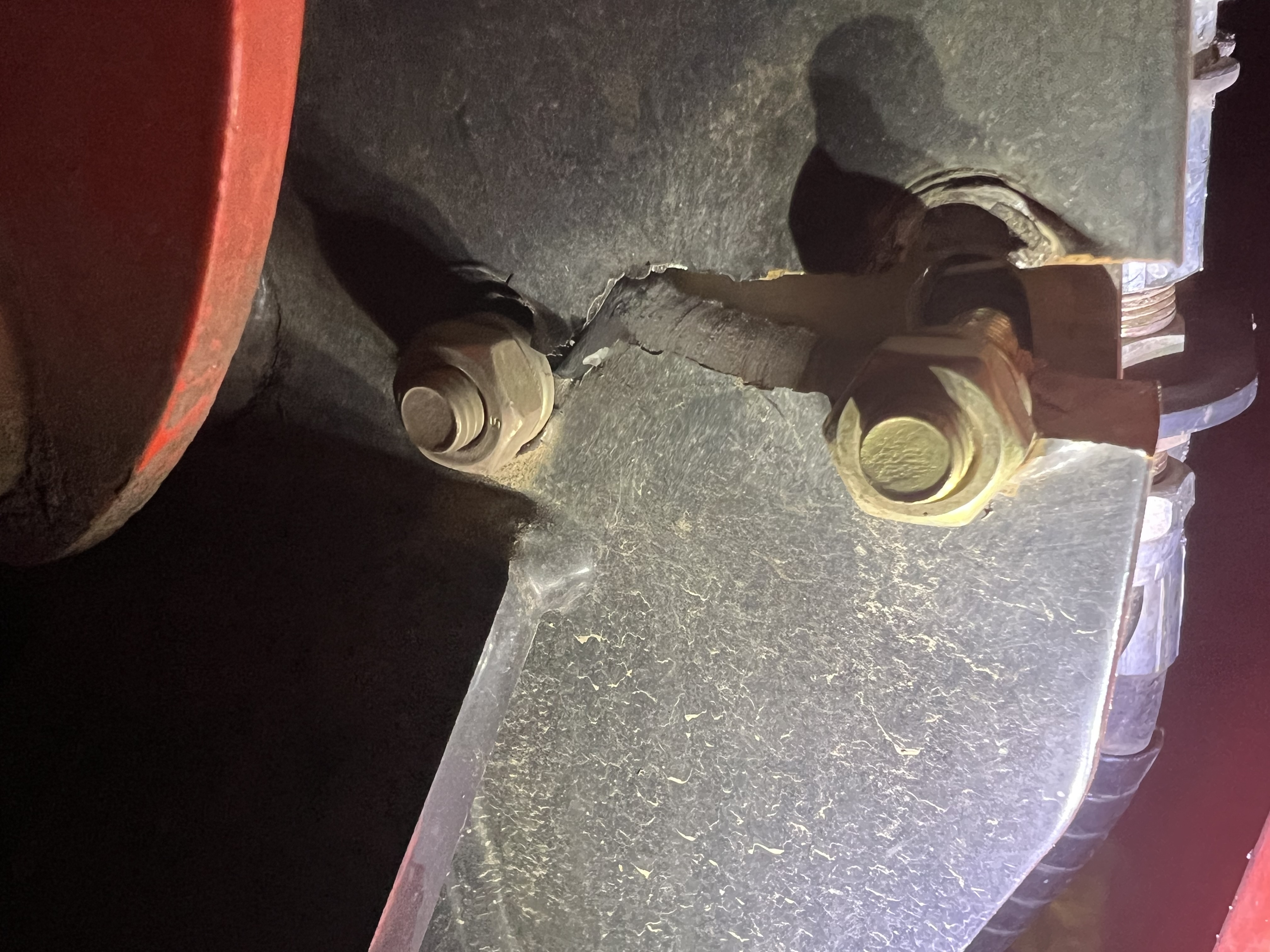

Thought it add to this post. Mine finally gave way last night. I counted 3 cracks on the right loader mount bracket. Same ones OP had. Tractor is 2018 CK3510se. I’ve had it since new. It has 800hrs.
Classic fatigue crack. Characterized by flat surface that collected rust. Fresh metal with jagged break with 45* shear angle was the failure location.
Was moving dirt from a to b when this happened. Definitely a weak point in the system with stress risers allowing cracks to propagate. Left side is pristine. Loader came crashing down on my hood and damaged some hydraulic hard lines.
