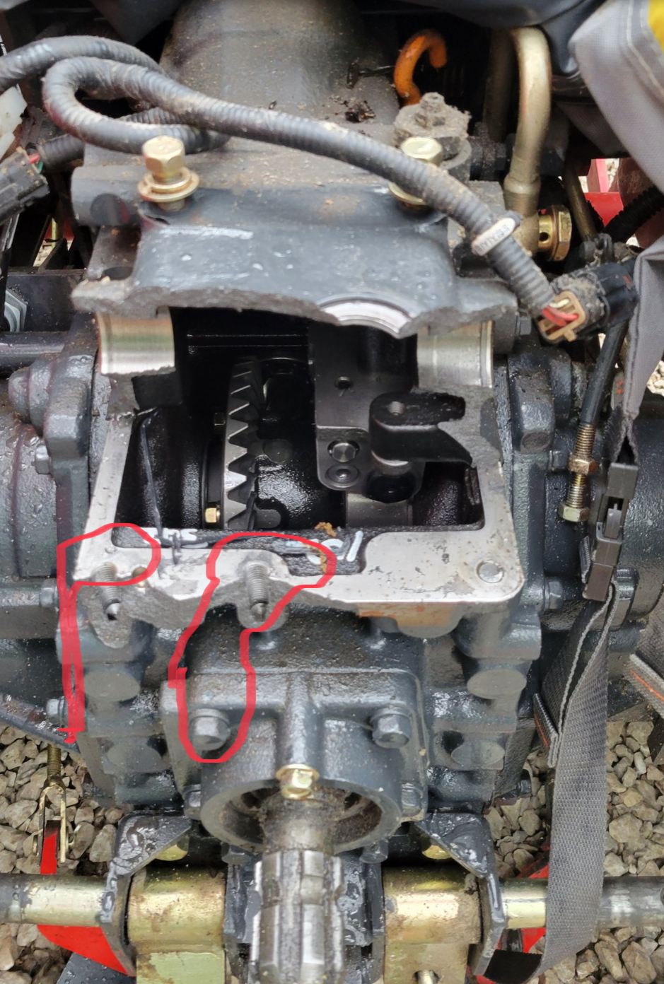

Considering the original case break and stud repair, I would beef up the toplink mount by making a bracket that ties into the 4flats on either side of the PTO, drill, tap and bolt it there. The aluminum housing isn’t strong enough. I know you said you replaced the 3PT post hole digger in favor of a skid steer type, but thats just my 2 cents
/ Broken hydraulic Cylinder Case #23
Im not sure drilling and tapping those spots would provide much more strength.
And whats aluminum? I though this was cast iron??

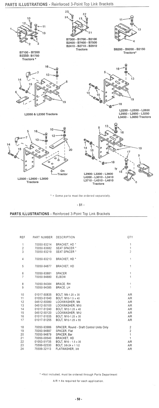

At one time, kubota actually offered a bracket to beef up the toplink connections on some of their older models. It was recommended for 3PH backhoes. And it tied the toplink brackets (which only have horizontal bolts bolting it to the rear case) to the bolt holes on top where the seat mounts.
IF you can make/weld something that ties in some of the bolts on top of the casting it will help alot.
This was kubotas optional toplink mounting bracket
I too thought about a mechanical abutment of sorts, but haven't gotten there yet. Just want to avoid another failure. The worse case scenario, of course would have the welds fail and re-damage the case and/or hydraulic cover.
Can I ask you, in the event some foreign materials entered the case during repair, would you suggest a flush of sorts, perhaps kerosene?

Xlent content my friend. Did I miss-say aluminum somewhere? No, the tricky cast iron here. I will take a photo of my "attempt." So many shops wouldn't touch it because 'it is likely to fail, ' well, we'll see-hopefully not.

Apologies on the aluminum as that is what it looked like in the pic.

Kerosene or diesel flush would be a good idea.

I would go the silicon bronze filler/TIG method on the cast iron too. Probably add some steel straps too. To use some non broken areas for support.
You could even go all the way down to that steel bracket bolted below the PTO shaft.

I doubt this was caused by simply lifting the three point. The first post indicates an auger (possibly stuck?) in the ground and attempts to free or redirect it. We don't have the full story here but the tractor was probably moving in one direction or another in that attempt so the forces applied to the lift arms weren't strictly from the hydraulics.
You are correct sir. Auger was locked in tight in clay. Dummy me, rocked tractor a bit and the housing broke apart. My heart sank. I can weld but not cast iron so I brought it to a pro. FINALLY putting it back together. Hope it holds. Should I flush trans case?

Welding cast iron isn't difficult really. You can either O/A weld it or TIG it, but either method requires careful pre heating and extended cooling. The issue with welding it is the lubricant that has migrated into the case material and it has to be removed which is involved by itself.

Might be possible to make studs of the appropriate length and weld them to the casting. Would depend on if there is enough room to drop the top cover over the studs.
I did, and the case being cast iron, I welded it together and with 9 total bolts holding on the cap I think the welds will suffice, at least I hope so. Going to test it with a Peruzzo articulating flail mower. Will proceed cautiously.
