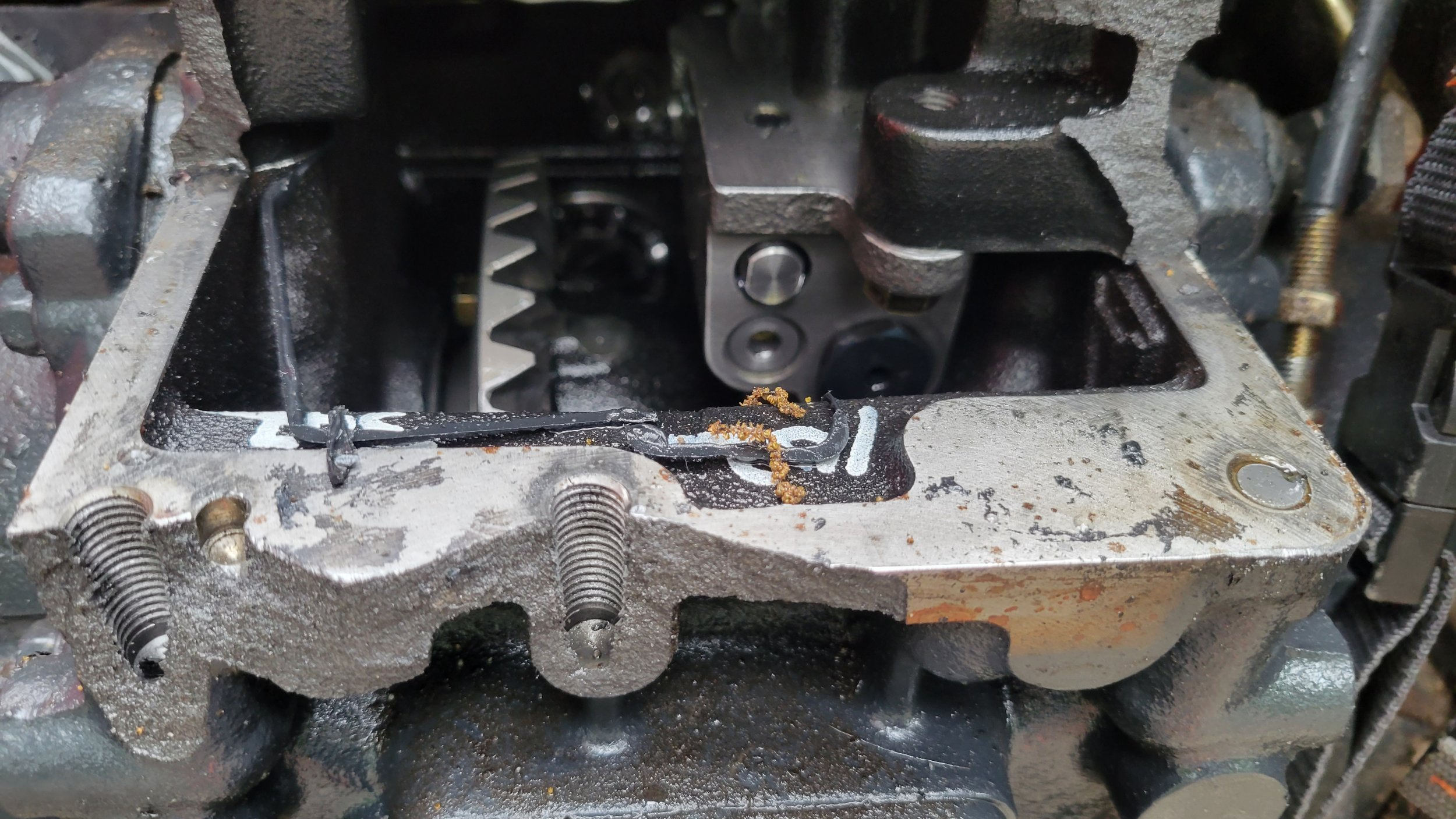

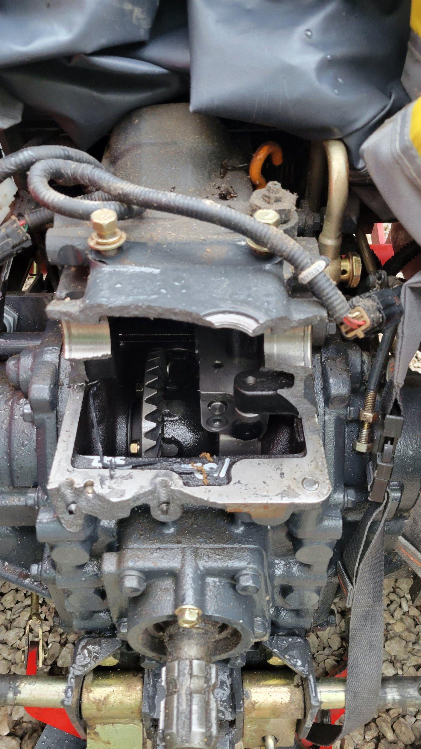

Got post hole digger leveraged in a clay hole and the rear case broke apart. So odd as I have dug many a hole. I think I may have tried to upright the auger and a whole lot of force was exerted on the 3pt lift arms.
Anyway, disassembled, purchased new cover but contemplating how to go about fixing the two broken apart bolt holes? The third one sheered off and I will weld a nut on and extract.
The cover is held on with several more bolts so how important is the integrity of the two broken apart holes? Do not want to replace entire case.
Weld, drill, tap? JB Weld? Drill and tap two new holes next to the broken ones? Any ideas? Dunno.

Wow man, that is quite a break. If you have the small pieces of the casting that complete those bolt holes I think they could be welded back together since that casting probably hasn't absorbed any oil and it's got enough mass to be able to sink the heat from welding. Take it to someone who does castings a lot, or take them some photos. If they have a mobile setup they might be able to come to you. The will probably tig weld or tig braze that.

I would buy a new rockshaft housing and repair the 2 bottom casting bolt holes. You better check the 3 pt piston and make sure the relief valve (safety valve) is set right .

Might be possible to make studs of the appropriate length and weld them to the casting. Would depend on if there is enough room to drop the top cover over the studs.

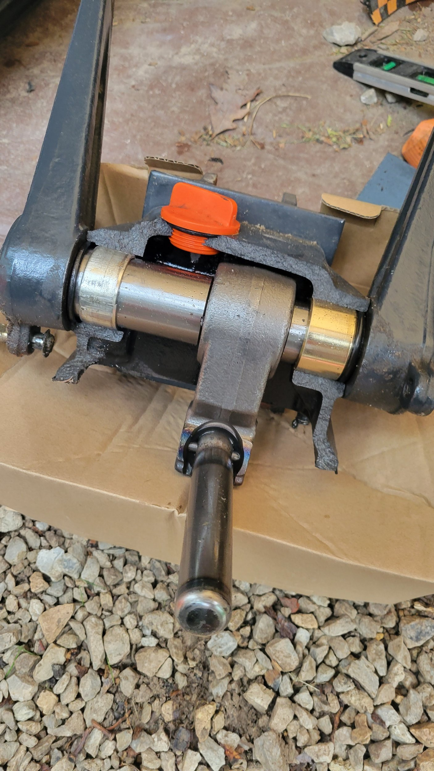

Candidly, looking at the broken off part and all the various threaded parts and bearing surfaces for the rockshaft, if it was mine, I would (and this is just my opinion and what I'd do), is, I'd order a new rear casting and replace it rather than attempt to cobble it back together because no natter how you 'fix' it, it will never be as structurally strong as a non compromised casting and the resale value of the machine won't be good either (once a prospective buyer sees the welding).
I do know what a comparable Kubota rear casting costs, It's around 6 grand for the part on an L model, 15 to repair and replace (labor included). Lots of components to remove, replace and clearances to be set.

He said he bought a new cover, so all the things related to the broken rockshaft will be new. The only thing being considered for repair is the 2 broken bolt flanges.
Arc welded with proper materials. Thank you
Correct.
Thank you sorry for the reply delay. Hurt hand. 8 surgeries. So we welded in two studs and extracted 3rd. Now with two hand I will reassemble. Hope cast iron stud welds hold up but again there are nine total bolts holding cover to gearcase. Fingers crossed.
