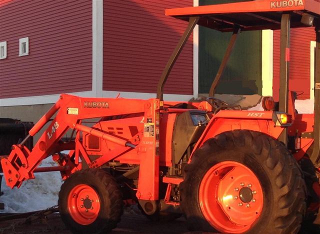

Update on the Broken L48. I sold the machine to a TBN member who plans to fix the machine himself.....The buyer is...on this board often, and has lots of orange machines.....hopefully he will start a thread detailing the process.......Best regards, Curtis Farmer

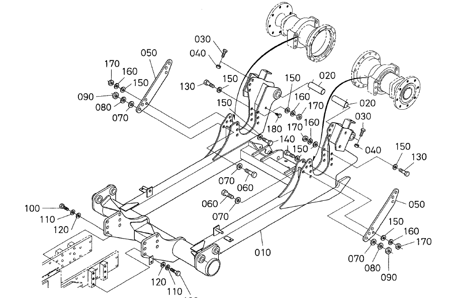

OK, I'm the culprit - I adopted the ailing L48 mostly for the technical challenge, hope to learn something and have a story to tell sometime.
The L48 shop manual has a good description of the HST's function - but has no diagnostic info for the control assemblies - Kubota just says replace anything that isn't working right. I'm not thrilled about doing things that way - so hold my beer and wish me luck...... (have some experience making automatic transmission parts - different story)
The symptoms are: seemingly normal forward function, but reverse is weak and very slow. It moves a little in low, and but may not move at all in high. Also the HST pedal does not return to the neutral detent by itself - gets lightly stuck on the forward side and needs a nudge to neutral. The damper has a sticky spot too so I took that off so it isn't masking the linkage motion.
The manual says if there's drive in only one direction, then replace the high-pressure check/relief valve on the other side. The valves for forward and reverse are identical so I tried interchanging their positions (the painted plugs didn't look like they had ever been removed before). The valves look fine - no dirt or filings, mirror finish on lands etc. With locations swapped the symptoms are unchanged. If either one was causing the problem, the symptoms should have switched with the valves. Next step is to properly clean the outside of the HST and remove the regulator & servo cylinder to see if there's something about either one - like a bent, broken or missing pin, lever, cam, spring, o-ring, or maybe a family of mud wasps. If that doesn't show something the tractor may need to be separated. The frame drawing below indicates why the separation job is spendy on the L48 and similar rigs - lots of wrenching.
All ideas are welcome - Dick B
