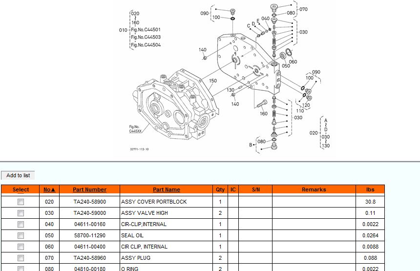

Looking at Kubota's online parts illustraion for the L48 HST, I see there are 2 pairs of poppets/reliefs. The first picture is of the "Valve Assy High" which should be the high pressure relief with directional check. Item #030 (qty 2).

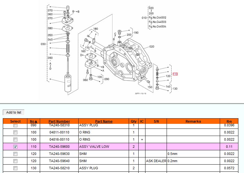

The next pic shows what Kubota calls "Vlave Assy. Low" (qty 2) Item #110. Not sure what they are but since there are 2, I believe they would be directional related and they are shimable so I think they might be "neutral valves" to give smoother transition in & out of neutral. If 1 of these is stuck or broken spring would give the same loss of drive in one direction.
