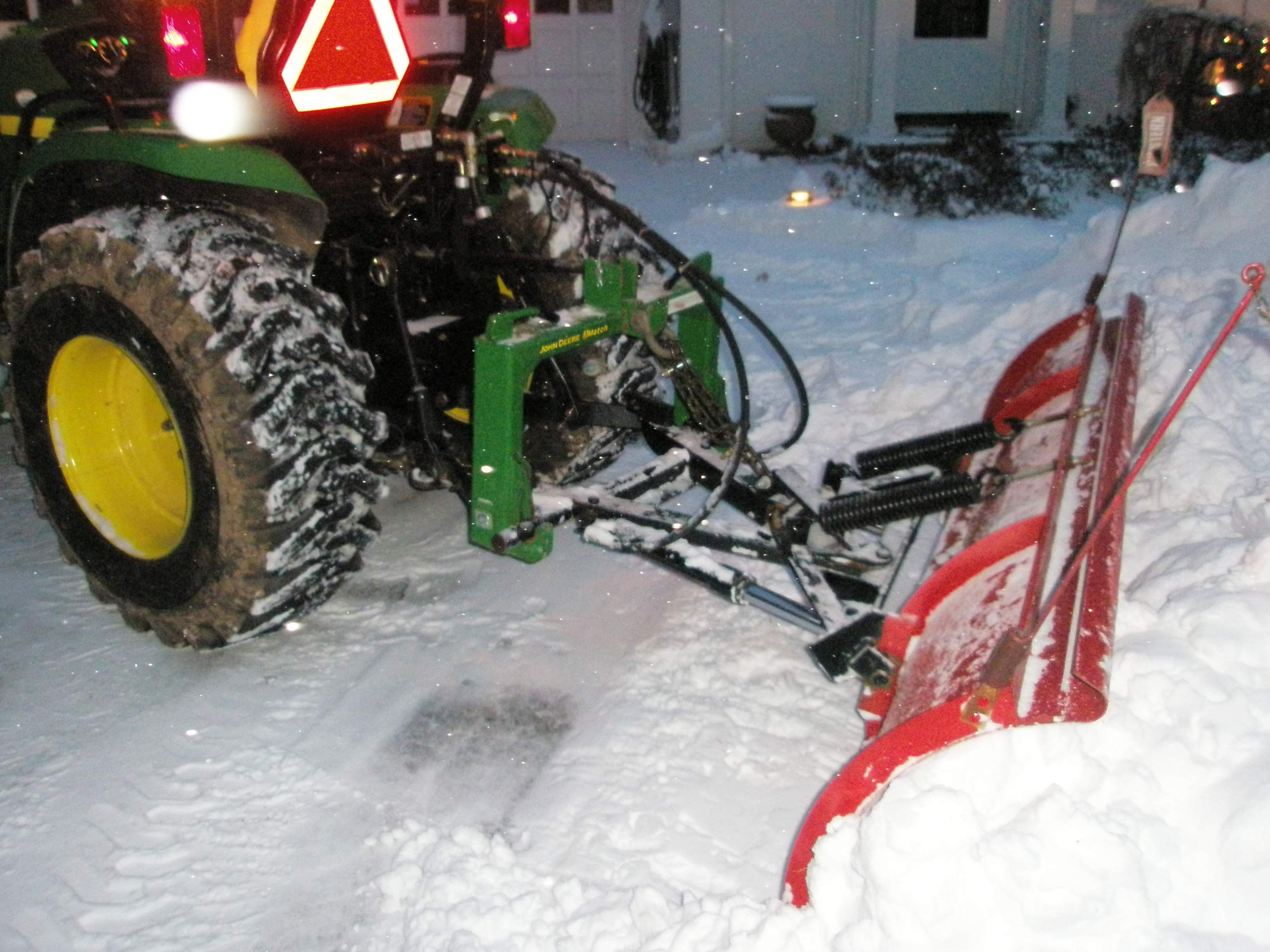

I snapped both of my lift arms in half using my box blade in reverse. I just read that it痴 not a good idea to do that but it works really well until it breaks.
How well will it hold up if I weld them back? Has anyone had any success with this?
   / Broken hitch arms on a 3320 #2
I've been using implements in reverse since I got my tractor, always heard it could be a problem.
As far as welding back together, if they're broke in an area you can reinforce with extra steel then I think they would be better than new, if they broke near the swivel balls then probably have to get new ones.
Have any pictures? what were you doing with the box, did you slam something? must have for both to break at the same time.
I may be asking for trouble with this contraption but it has been working great, I'm hoping the quick hitch's rigid frame may be offering some protection to the draft links.

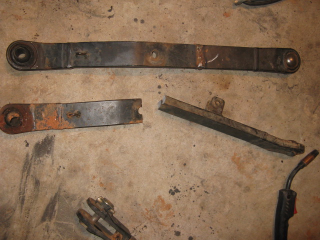

The box blade is great for cutting saplings off level with the ground or on bigger trees it will rip it out by backing into it and lifting up. Anyway I backed into what I thought were a few saplings but it was a stump that they were growing out of. I hit it at an angle and both hitch arms snapped.
A welder instructor friend of mine is telling me that my MIG welder will not work for this project but I am tempted to try anyway. As can be seen in the picture I have already fixed one of them.

Is there a way to tell if it is cast or forged?
