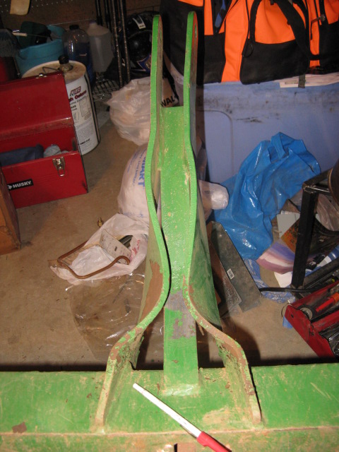

Dan, a welding instructor that I know (not local) made the same suggestions as you have on the rod and V. I have made very deep and wide V on both sides. So they are prepped and ready to be welded.
As far as there being more to the story, there could be. The box blade has been reinforced because of a previous oops (see picture). I was grading in reverse down hill and hit a rock dead center. Yes, I know get a bulldozer Anyway, I do not know if that blow weakened the hitch arms but there was no damage the box blade this time.

Just left my buddy's muffler shop. He has a big press he uses to bend pipes. In less than 5 minutes and some metal blocks he bent the arm right back. We laid the two arms out and the bent one was almost 4 inches off center of the other one. Now you put them on top of each other and their identical again. Thanks for the help.
