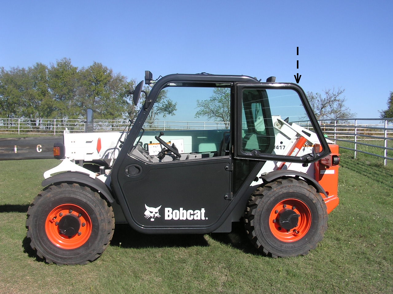

Had it happen to this one. Backed into a tree, it put a very slight bend in the frame at the edge where the arrow is, but didn't break the glass, that is glued to the other side of the frame. About a month later after a cold night, I drove it out of the shop and parked it with the sun shinning on that side. The top half was closed. A couple of minutes later the glass shattered.
