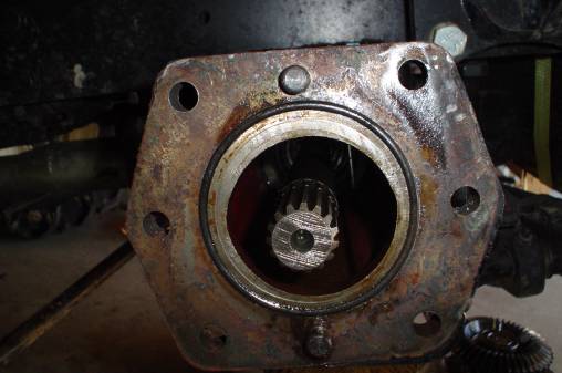

I have over torqued my 284 4wd and damaged the front axle. I have removed both front wheels and axle housings. The right side drive gear in the Standing Shaft Housing has a broken tooth as you can see in the picture. However, when I rotate the shaft that goes into the main housing it does not rotate smoothly either direction. Got a feeling this is not going to be fun. Before going any further I would like some opinions on how to proceed? I am going to try and include the pic of the shaft I am now rotating that goes into the main housing. This shaft slides in/out easily and the teeth on both ends look fine. Thanks for your help.

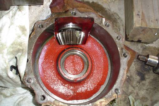

Here is the pic of the shaft that goes into the main housing. Like I said earlier, it slides right out and the splines on both ends look fine. I am beginning to feel like I have bumped into my mechanical limit and may consider pulling the axle, putting it on a pallet and ship it to someone close to South Carolina. I appreciate any words of wisdom.

OUCH !!! I'm sorry but that is what comes immediately to mind.

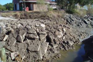

It may be of some benefit to detail how to over torque your front axle. On this particular day I was moving rip rap (big chunks of concrete and mud) preparing to pour a boat ramp in my back yard. Working a loader while picking up material is all a function of forward speed and bucket manipulation. You can slow down and work the curl and lift to pick up almost anything. The stuff I was working was heavy, muddy and tough. I started using L1 approaching the material and slowly manipulate the bucket in order to work the material into the bucket. This really turns into a dozer function at some point. Anyway, it was the only way I was able to make any progress. Should have called my buddy with the big back hoe! I was almost finished when I heard the pop sound under the tractor. I knew what I was doing overstressed the front axle and got that feeling like now I did it. To make a long story short I damaged the front axle. So far I have a busted gear on the left housing but the main case has to be dropped today because I have a feeling something is busted in there also. I have no doubt this is a self inflicted mechanical failure. Now I gotta get her fixed because spring in South Carolina is right around the corner. I will post here and CTOA as repairs proceed.

Here is a pic of the material I was moving. It was probably much to heavy for my 284. I think the damage occurred while inching forward and lifting. That is just too much torque on the front axle!
