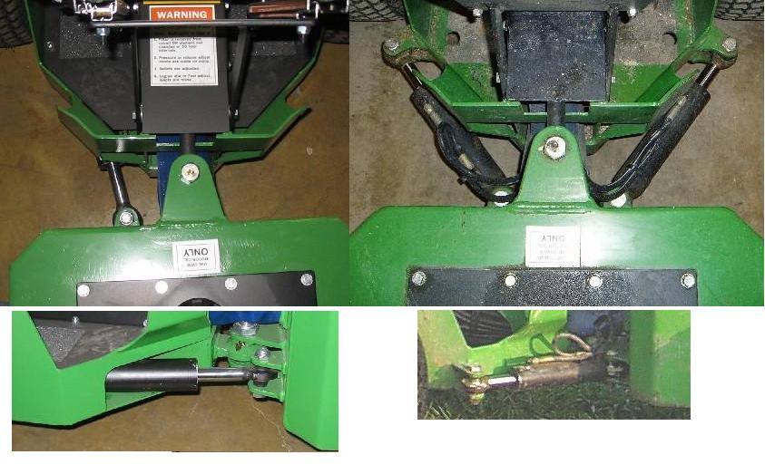

I thought this pic might be usefull in the repair thought process for someone. On the left is the new one cylinder setup on the right is the old two cylinder setup.

I'm concerned since I have the single cylinder steering..due to my lack of knowledge on welding, etc. can somebody post exactly what should be told to the weld shop on beefing up this area for preventative maint.?
/ broken frame on PT 422 #48
Why not print those pictures of the unit that was broke, and show the welder what the other guy did to fix his unit, and the welder will come up with a fix, to beef up the unit.

Hi All, I recently had the same steering failure as Scarg did. I have a 2004 - 422 with one steering cylinder. Luckly I caught mine before a complete failure occurred so it was easier to take to the shop. I had it welded in 2005(not very good) by a neighbor at 175 hours when I first noticed a crack, but it failed again. A clicking noise under foot was heard when turning and that is a sure clue to this problem. I didn't take any photos because they were basically the same as Scargs.
The welder told me the main issue is the metal on the bottom where the cylinder is attached was too thin for the pressure the cylinder put one it. Plus, it was right next to a big drain hole. My machine has about 350 hours and this repair cost $250 to have welded (a little more then I hoped, my guesstamate was about $150,but what can you do). He said it took 4 hours labor plus material.
The guy did a great job and welded a large plate on the bottom of the machine. It looks strong now and he pomised I wouldn't have a problem in that area again. The moral here....watch those 422s with 1 cylinder. Thanks and good luck. PS, this was my first real repair on the machine, I still love it.
