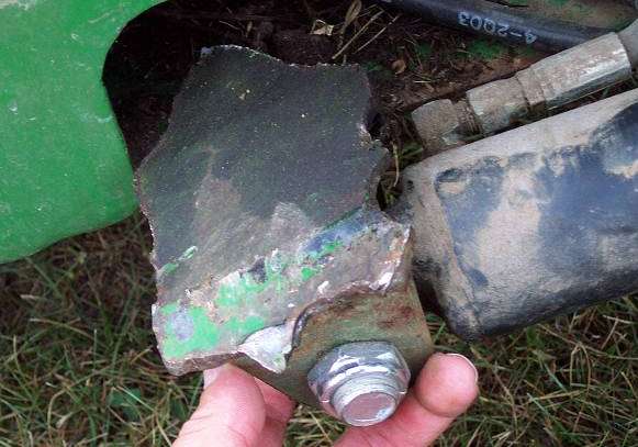

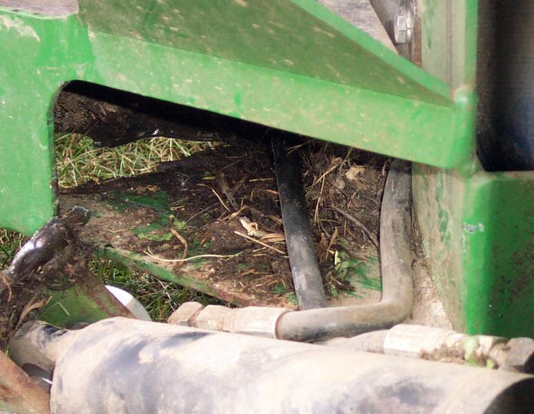

Hmm. New PT 422 with just over 100 hours on it. Mowing today and the front mount of the steering cylinder where it is welded to the frame completely broke off. This is what I believe to be a tractor that has seen on marginal use.

That is a really strange looking failure. The weld didn't fail. The steel plate did.
It's hard to picture what could rip out a hunk of steel like that. It doesn't seem like the steering cylinder should have that kind of power.
Even if it does, I can't think of a realistic way for it to put an excessive load on that attachment point (drive between two concrete walls with tires scrubbing on both sides, and try to turn hard...repeatedly???)
I'll be really interested to see what PT has to say. Good luck.
Dave

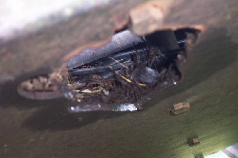

Here is an image of where it torn out taken from the ground looking up.
This happened while mowing 4" high grass down to 3"?
It should be noted that there is what appears to be a 1" diameter drain hole and a bolted connection exactly on the outline of the tear out.
The unit is still under warranty so it will be interesting to see what happens.
This and next attachement are hard to see well. However it appears that there is an orange rust along a portion of the hole. Maybe there was a crack that finally weakened to the point of failure.

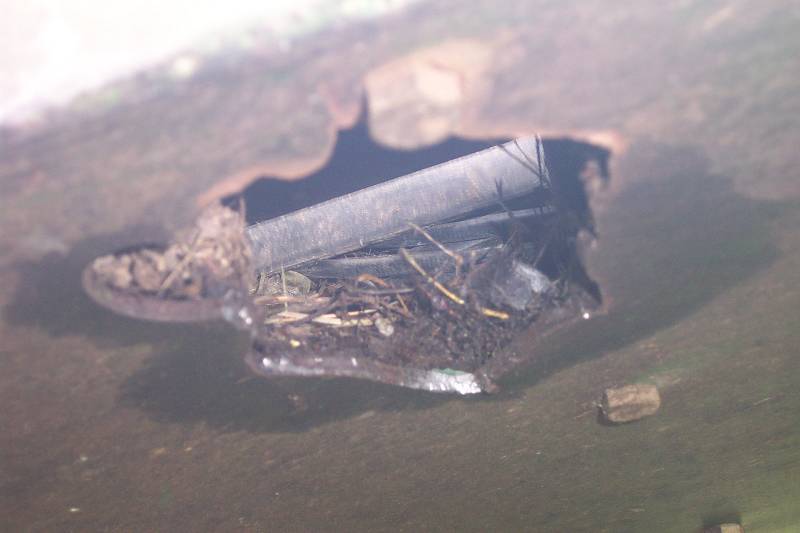

another almost the same view but slightly different.
