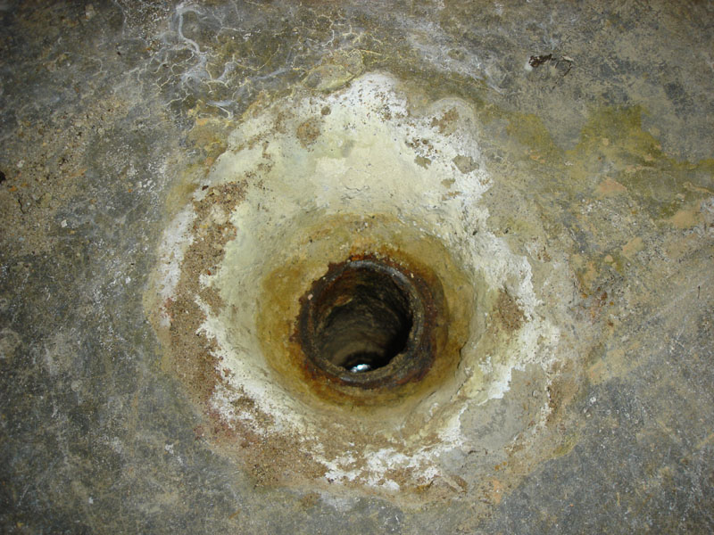

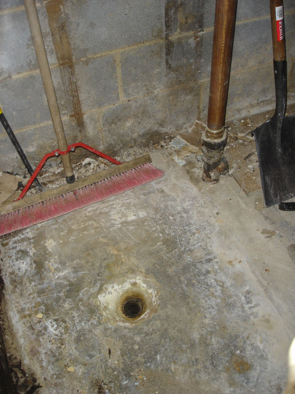

The shower drain in my basement bathroom has always leaked, and at times I have had minor sewage backups as well, so I decided to demolish the shower to determine the cause of the leak, repair it, and replace the shower with a tub/shower enclosure. Well today I finally got the floor of the shower out (tile over a lead shower pan), and discovered the worst case scenario, that the cast iron drain pipe was broken off below the surface of the concrete slab. I have now determined to decommission this in drain, and plumb the new bathtub to the kitchen drain pipe that is about a 18" away.
I've included a couple pictures.
My question is,
"How do I permanently plug this drain, without affecting other nearby pipes (the aforementioned kitchen drain) that drain into the same waste line?"
I'd appreciate any insight anyone could offer.

Before you start running new lines, this one may still be fixable. Get a masonary bit for a skill saw for about $40 and cut out a square around the drain line. Remove the concrete until you can get to the main line. Attach a new drain line to the old line and bring it up through the height of the floor by about six inches.
Pour concrete back into the hole and let set.
Put in new shower.
Cut off excess pipe and attach drain from shower to the drain line.
This isn't all that uncommon and in new construction, it's very common to have to cut out the slab to ajust the location of the drains.

If you just want to plug the drain get an expansion plug for it. If you want to fix it go Eddies rte..
   / Broken Drain Pipe #7
I agree with Eddie, chip out the concrete and then attach a new section of pipe and repour around the new pipe. May be a little dusty, but it can be done.

Like Eddie said...moving a drain or repairing one is common in construction. Just be careful if you "dry" cut the concrete. Silica dust is not good for the lungs and a dust mask will not work. I would personally rent a wet saw and throw up some plastic on the framing members. It might be a little messy but it will be contained in the shower area.

You don't even need to get to the main. As long as that broken stub is about 2.5"-3" tall, you can use a "hub-less connector" (Fernco coupling) & come up past the finished floor height in PVC. If that line to the right, in one of the pics, is what you are thinking of tying into, you may run into pitch problems, so coupling into the broken cast iron is likely easier/less work.
   / Broken Drain Pipe #10
Like others have said. Remove the concrete and do it right, or you’ll be doing it again in a few years. If it’s that bad above ground, who knows what it’s like underground. You need to get to good clean pipe, and work you way back up.
