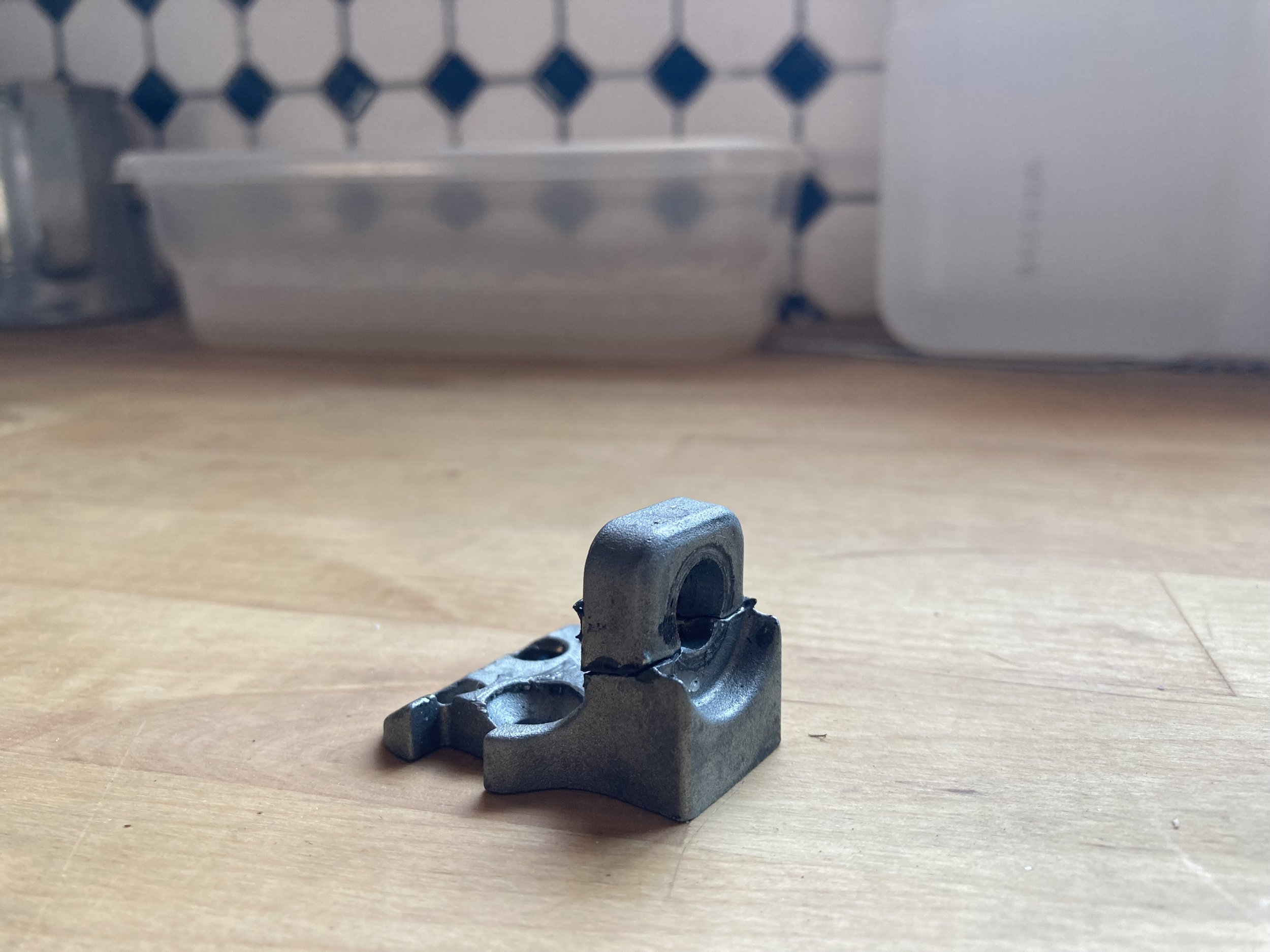

HI,
New to the forum. I have a 6 year old Branson 2400h with a SL00 loader. I have had 2 joystick plates break on me in the last 6 years. It has broken where it is fastened to the plate. I have to buy the whole assembly not just the plate. Cost is over $300. Anyone else have this issue?
Any way to strengthen it? I called a local tractor supply, they said that their parts vendor shows no inventory. He ordered it, but doesn't know if they have it to ship. I'm located in the Spokane area.

Can You Take some pictures and to show the parts that are broke?

/ Broken Branson SL00 Joystick
this is the plate that breaks

Looks like pivot bolt breaks out of the cast material. Is that function curl dump or lift lower. If lift lower is your detent difficult to engage and release?

Take it to a machine shop or good fabrication shop and have them make you one. They are not that difficult to make and will last longer than the original.
/ Broken Branson SL00 Joystick #12
One option since the price of a new one is High is to take it to a machine shop and have them build you one out of steel. Because it is a 90 degree and has bolt in holes they should be able to duplicate it fairly easy out of some good steel with a mill. Might take a couple hours probably less and cost might be even less than 300$

No worries. I suggest the same thing not to long ago to a guy with the same issue. He decided to make his own and worked just fine. It does not have to be fancy.
/ Broken Branson SL00 Joystick #15
I found the thread I was talking about. A little different design but works the same way. You can see what he came up with that is working.
#16
Thanks for the suggestion. I'm not handy that way, but I will try to find a machine shop that can manufacture it.
