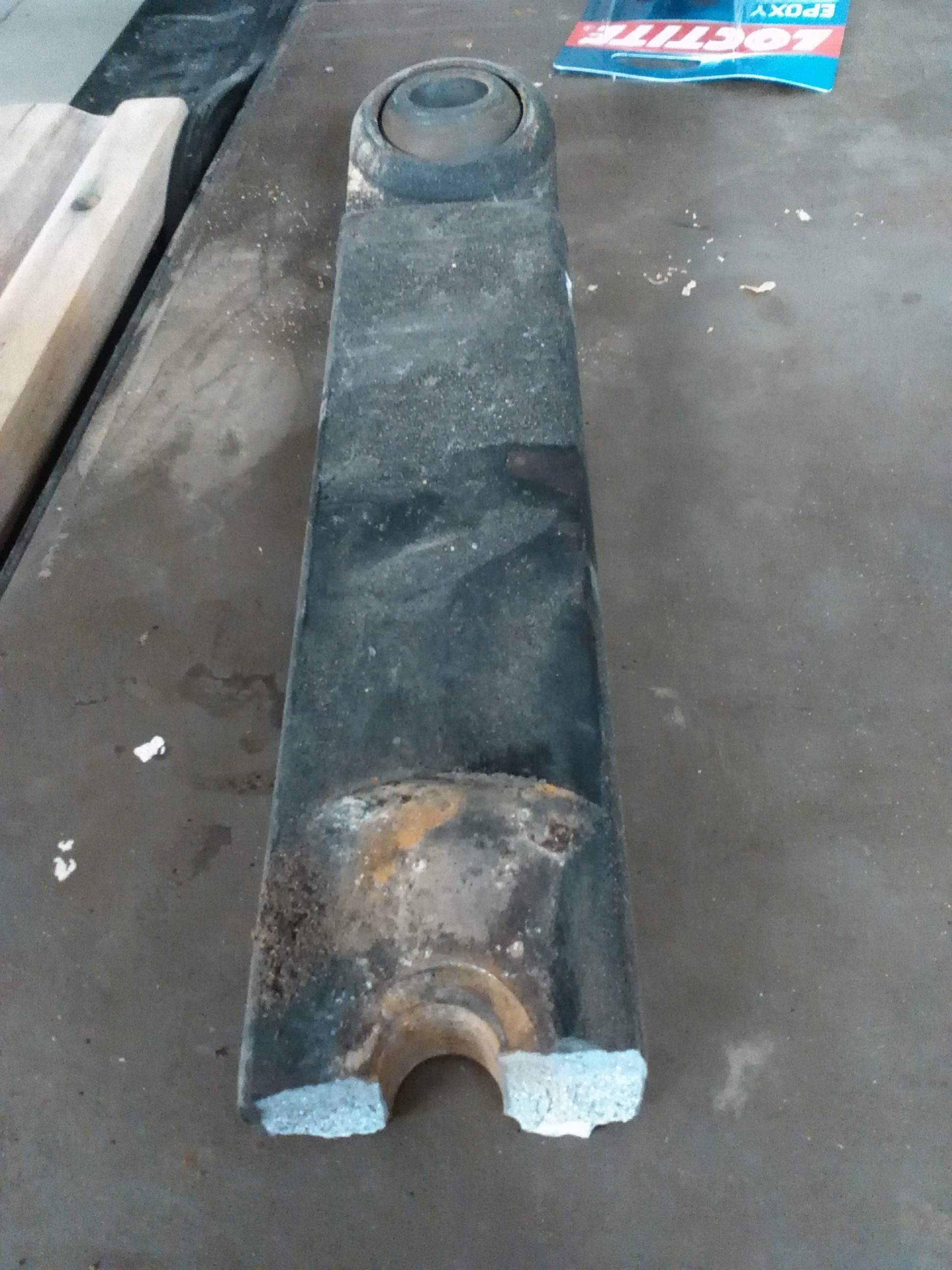

Has any one ever broke a draft link or lift bar? I broke mine yesterday and it broke at the weakest point right where a hole was drilled through it. the dealership wants 286$ for a new one. Im looking at used ones now.

Same thing happened to me on my MF135 I just welded it back with some extra bar stock on top and bottom. Worked fine but did not look the best :)

How long has the weld lasted? Do you take it easy on it?
/ broken 3 point #4
15+ years. Did not take easy on it. Never had a problem again. The top bar stock was about 3/8" to 1/2" in dia. The same thickness as the link. The bottom was at least 1" in dia (may have been bigger). Did v out the broken out area on both pcs. Had to re-drill the hole to remove the weld.
