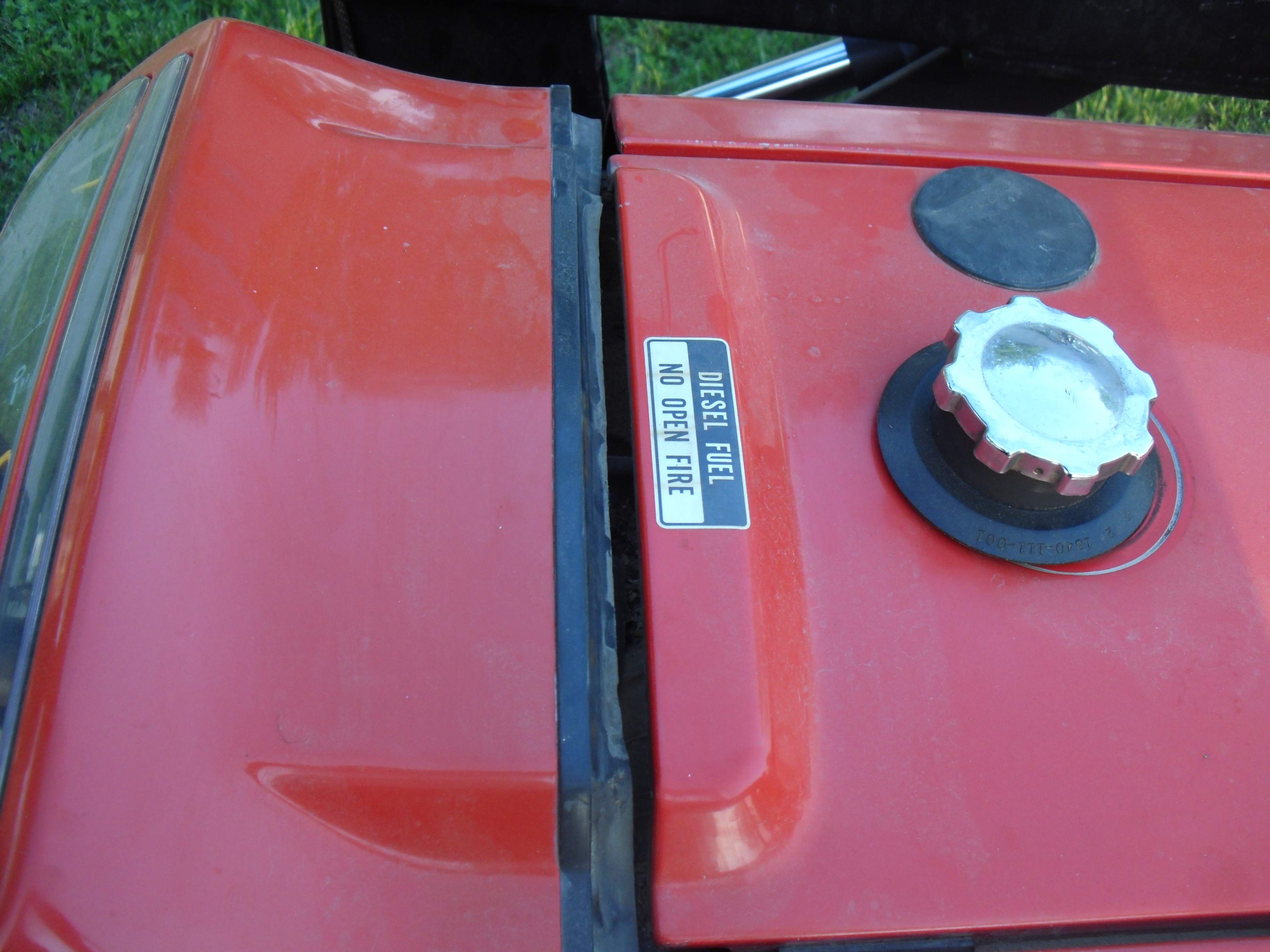

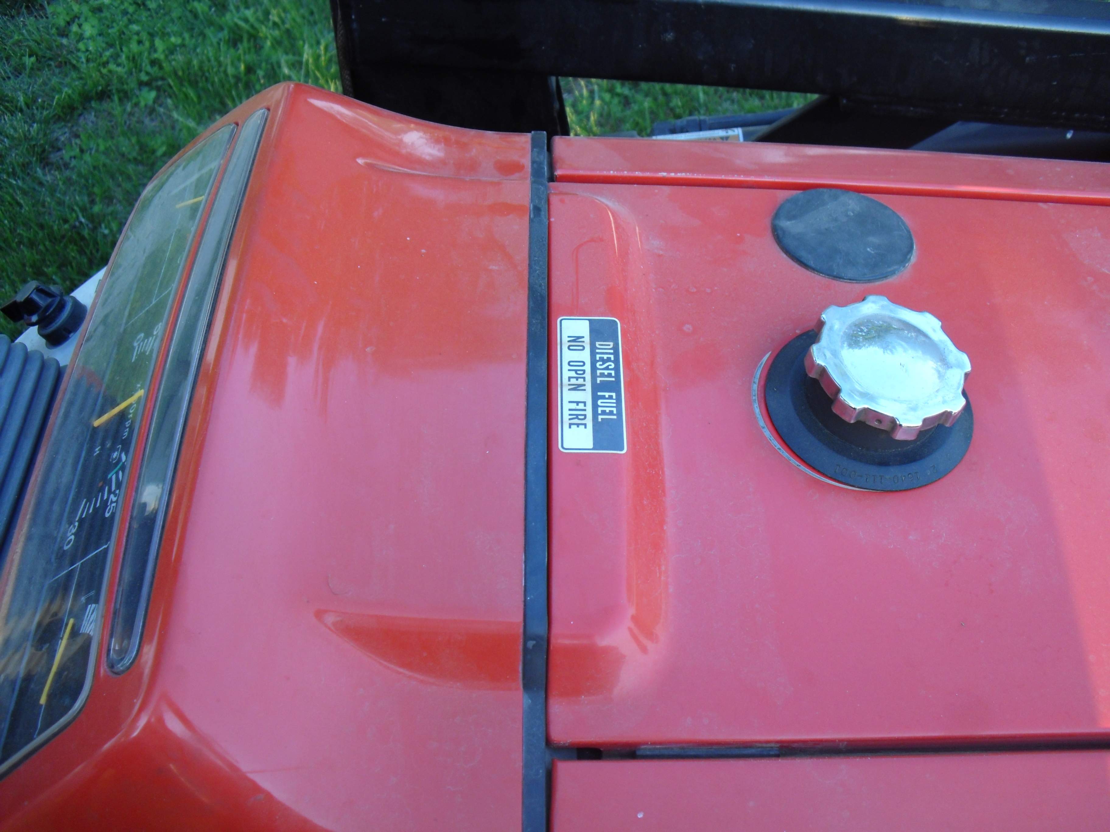

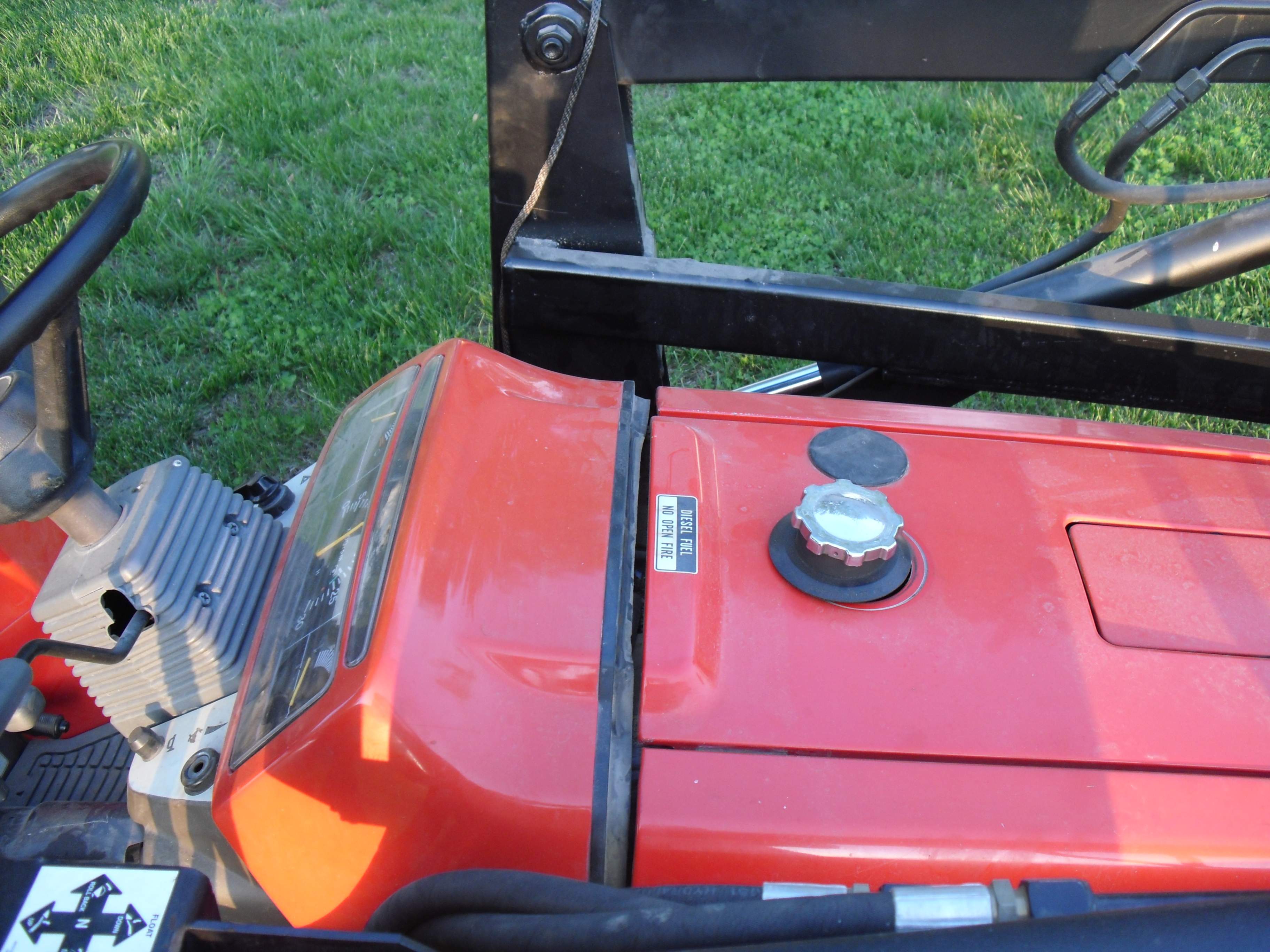

Hey everyone,
I posted a question about this issue about a month ago and never got any pictures to go with it. Now I've got them and hoping some of you can weigh in on what might be causing the gap. Note: the rattling sound in the video is my FEL not my tractor.
Another thing I noticed is how the steering seems to be very stiff when the bucket is up. I haven't used the bucket aside from just lifting it up to operate the tractor since this problem started.
Use this link to view my video: http://www.youtube.com/watch?v=iMJbgEWKHkI

Thats odd! do you have pictures of the frame below ?
   / Broken 1230 issue
No, but the frame is intact and there aren't any cracks. My neighbor and I had it on a lift and went over the frame and came up with nothing. :(

Wow! Is the tractor as new as it looks? Talked to the dealer yet? If mine did that, I'd be real concerned!
   / Broken 1230 issue #5

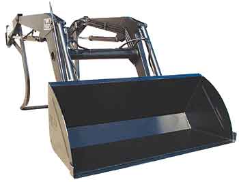

Does the loader hook to the front of the tractor frame also? I can't imagine that sheetmetal moving like that without the frame being broken.
   / Broken 1230 issue
I haven't contacted the dealer yet, and after looking at the frame from under the tractor is looks to be in good shape. Nothing is separating from itself, and the only thing that looks to be showing any sign of stress are the motor mounts. I didn't think that would be it though.
It's a 1997 with 926 hours. My bucket is a Westendorf TA-111. Personally, I think it's too much bucket for my size of tractor.
   / Broken 1230 issue
The loader hooks to the front of the tractor frame and then also slides into brackets at the midsection. Here are a couple pictures of my loader.

thats exatly what my 1250 was doing ,,it had to get really bad before i found the trouble....i couldnt see anything wrong until it really got so bad it was really broke..that may not be the case with yours but it sure looks the same,,when mine broke i didnt even take it apart ..a welder buddy was able to repair it on the tractor.... hope you find your trouble bruce
   / Broken 1230 issue
#9
So what was the problem with yours? Did your frame actually crack? When your welder buddy fixed it, has it been ok since?
Thanks for your input.
Steve
   / Broken 1230 issue #10
yes it actually broke ..after he welded it i kept the tractor 2 more yrs with no more trouble at all ...the only reason i got rid of it was i went to a little bigger tractor ...my 1250 was a tough tractor ... bruce
