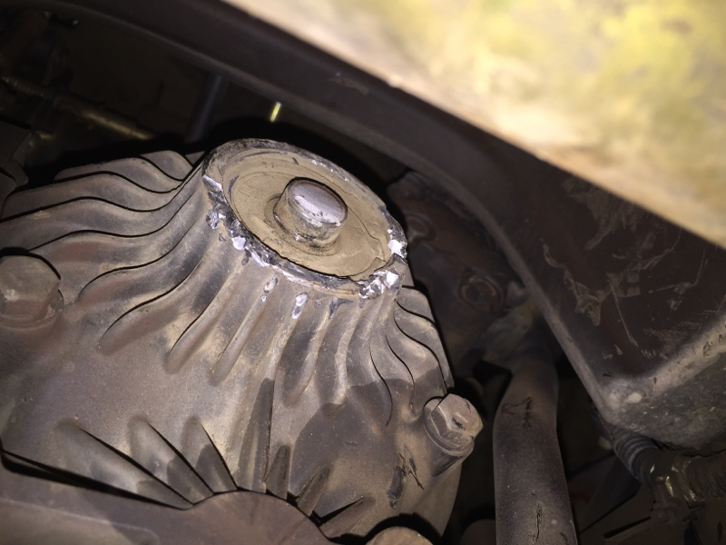

The shaft that connects to the drive shaft where the fan is mounted on broke off today. Hope I'm not confusing anyone. Here's a picture

Wondering how much this will cost me and how big a job it really is!!! image-2233590495.jpg

The shaft that broke is $200, then add seals and other things plus most likely 5-6 hours labor, I could see $800-1000 before it was all said and done.

not really..I was pulling a lawn roller full of cement and was going to put it away, went over a small pile of snow and that's where it broke off..I did notice that both u-joints on the drive shaft are shot!!

Will need to add more to the fix if the u-joints are shot. Something unusual happening to cause that much damage, IMO.

bad u-joints might have caused this

went to dealer and they never saw that...as that shaft does not get any added torque,it's mainly running free.
all they could conclude would be bad joints causing vibration.Just hoping my shaft didn't get any bend in it as it was hitting the underneath of the tractor, 'cause a new shaft is close to $900

Failing U-joints caused vibrations that flexed the input shaft until it fatigued and failed. New u-joints many hours ago when they started to fail would have been cheaper.

Totally agree with you...Negligence on my part

all fixed,,new joints on drive shaft and shaft in transmission...Proud to say it's back up and running :thumbsup:
