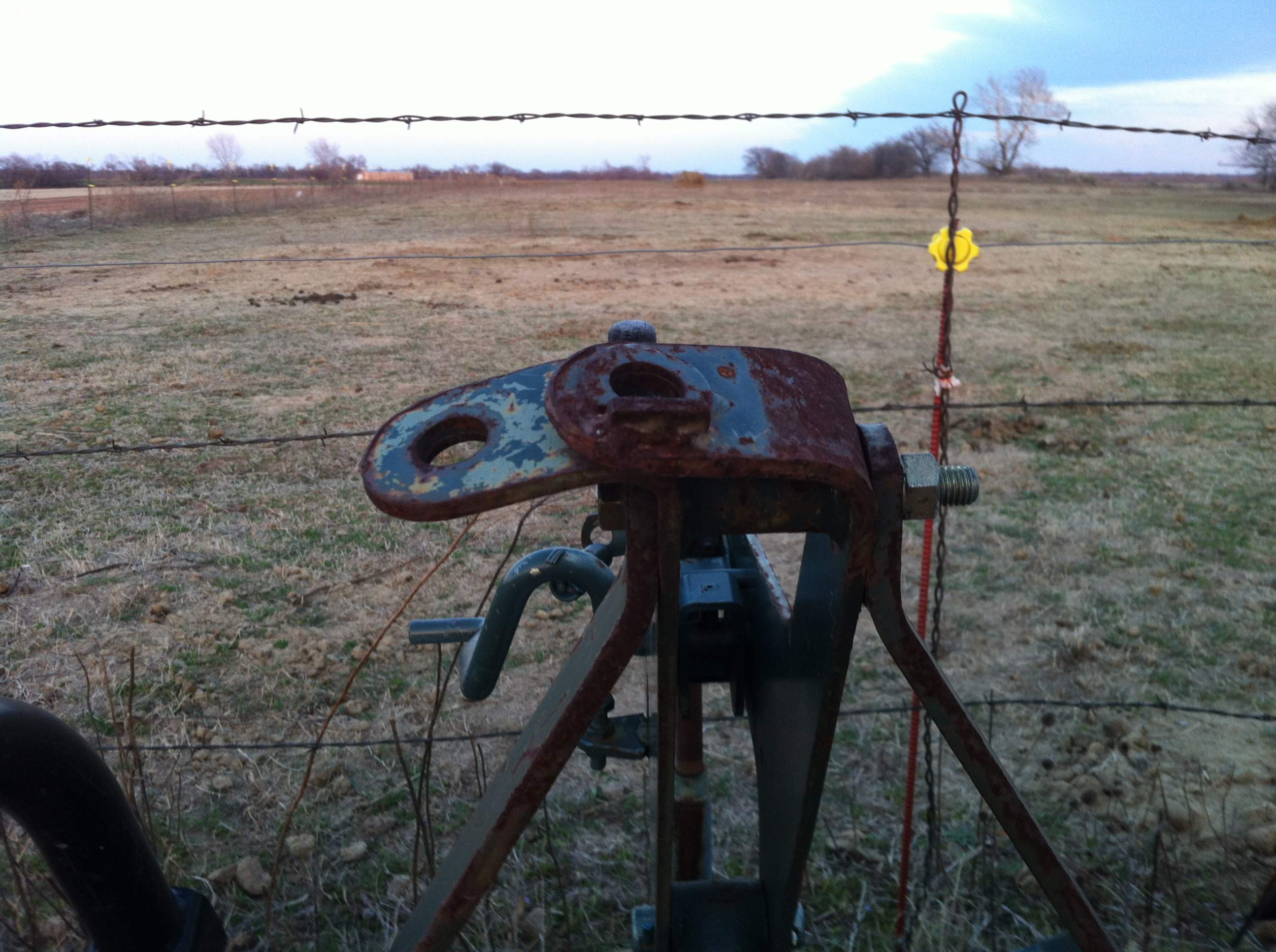

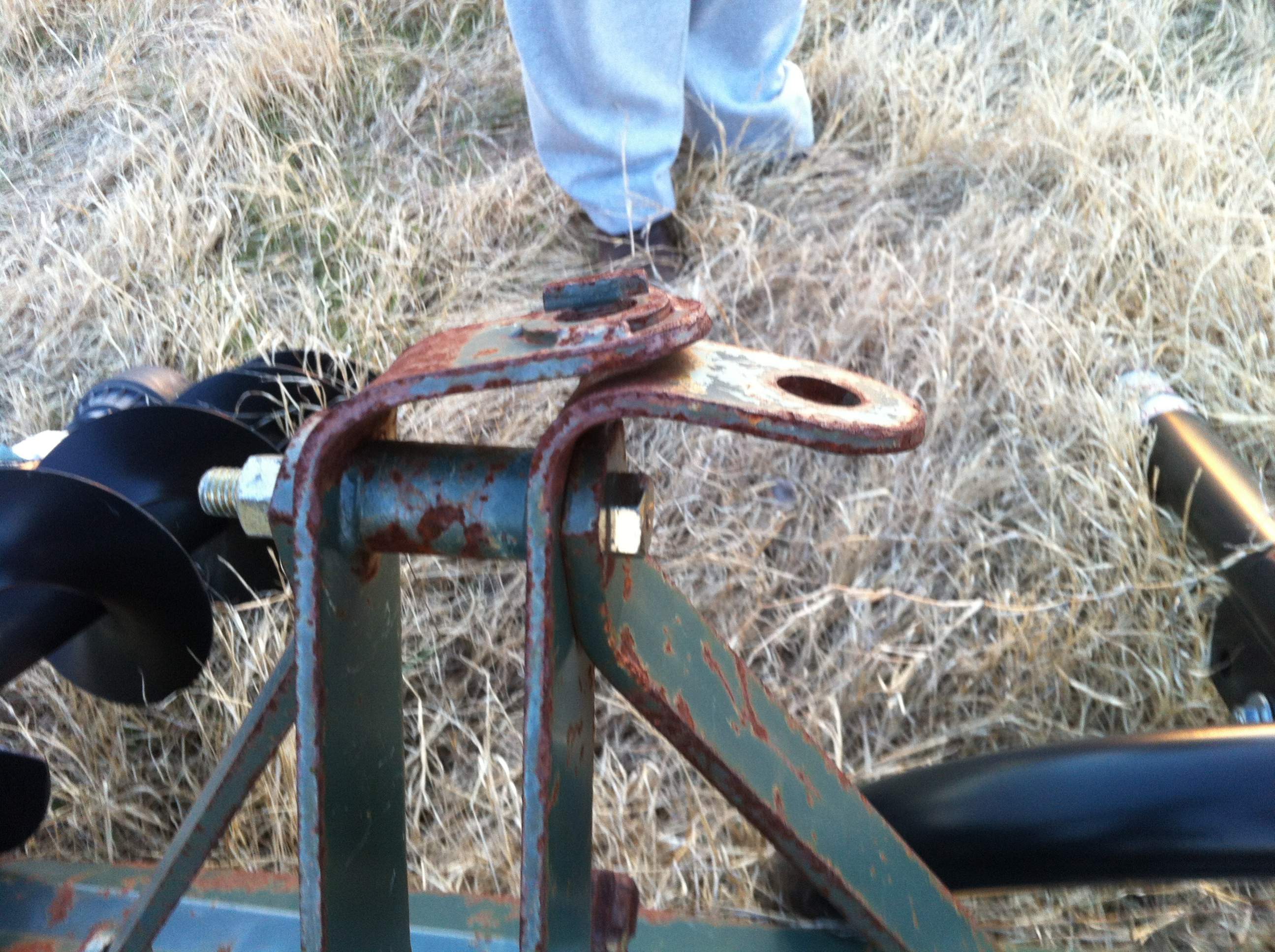

When I moved the attachments for his ... my ... The Tractor (A Mitsubishi 4wd w/fe loader) I bent the fork where the lift attaches. Folded them over with the loader putting it on the tractor. I am not the most skilled in the world with a tractor, still learning!!

This is the top of my tiller, where the lift attaches.

Any welding shop will be able to straighten it. A little heat, leverage and maybe a hammer and you"ll be good as new!

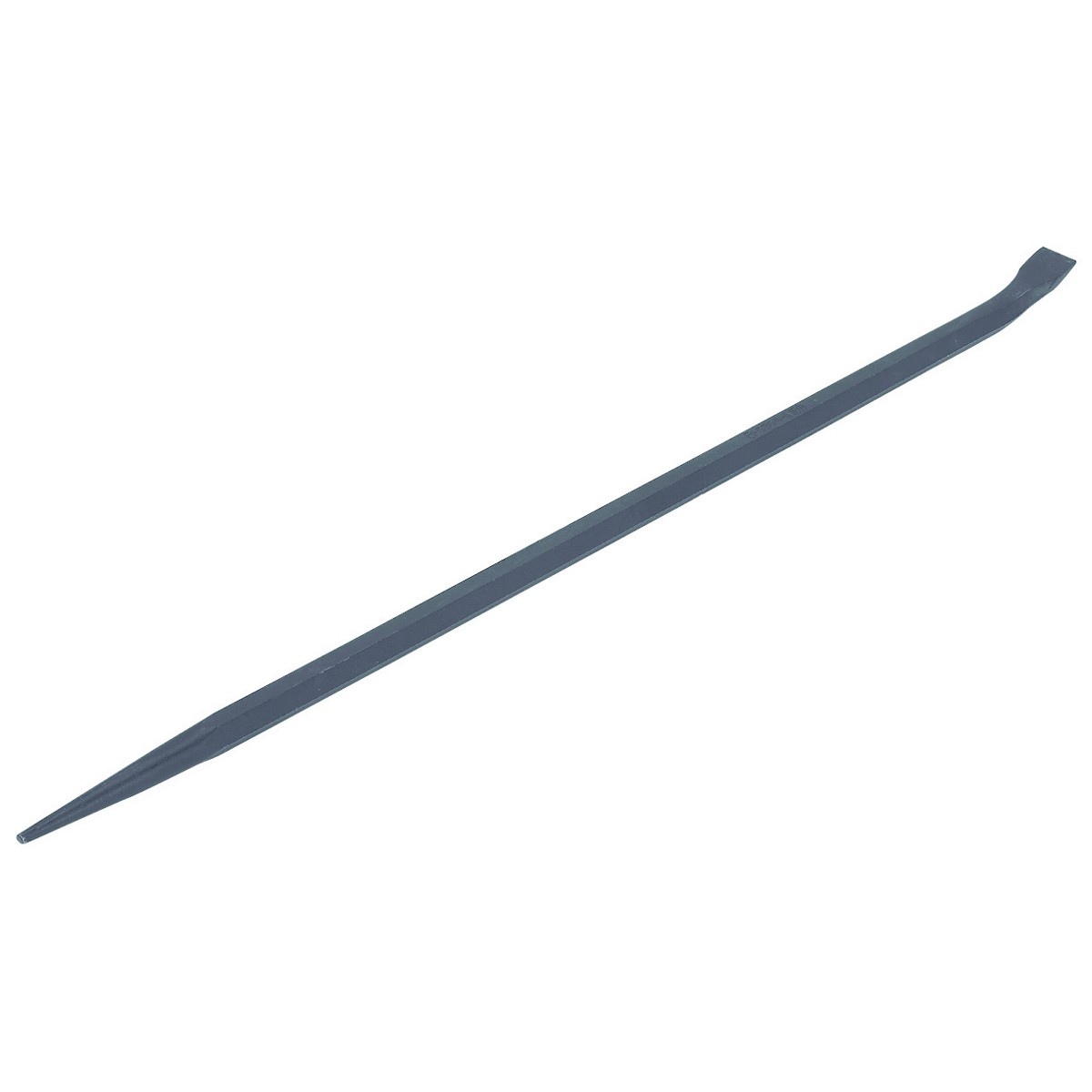

^Yep. A BIG crescent wrench, and BIG cheater pipe to go along with that BIG hammer (5 lb min and/or 10lb sledge). As said above, heat would help out too. Also, you can substituting a pry bar ("alignment bar", the kind with 1 pointed end) and put one end through the pin hole(s) on the tiller, then slide your cheater bar of the other end of the pry bar to extend its length for more leverage.

That is not a terribly high-stress part, and the way it's bent is more or less exactly perpendicular to the way the stress is usually going to be applied. I second what others have said. Get somebody with a torch to heat it up and bend it straight again. You can do it cold, but it's going to require a lot of muscle. Down-side of the heat method is, you'll probably need to take out that bolt and bushing to get at just the bent pieces.
If you put an ad on your local Craigslist, including some pictures, you can probably find some good ol' boy with an O/A torch and a strong arm to come out and do it for you, vs. you having to take it in to a welding shop. It aint rocket science...

If you have a propane torch, whether or not you can heat it up enough depends on the tips you've got, but yeah, propane is plenty hot for heating and cutting if you have the right equipment. Heating before bending will do a better job of not weakening the metal, but I don't think you need to worry too much. This isn't high-carbon steel, so it's not like you're going to make it brittle. The key will be to use a tip on the torch that concentrates the heat where you want it. Get the bent section nice and red, and it'll bend back without too much trouble. Then just let it cool on its own--don't throw water on it or anything to hurry it up.

I am a fair sized guy and you are going to want more heat then a small propane torch is going to supply. You are not the first and will not be the last to do something like this. Take the picture with you To a welding supply place and ask them to recomend someone.
/ "Broke" my Tiller Moving #13
As Joshua said - you can do this with propane if you have the right tip for the torch. You want to get the steel dull red hot in overcast light. If you're working in direct sunlight, then move something to put the work in the shade the better to judge the color. With propane you will need to be patient and play the tip of the flame in a line along the path where you want the metal to bend. A long pipe wrench applied to the bent "ear" or a close fitting pipe through the hole should give you enough leverage to move the ear back to where it should be. If you can get you hands on a MAP gas or an oxy-acetylene torch, your chances of success will be better. Remember, wear heavy leather work glove and eye protection. There's a good chance you can do this yourself and you will get a great feeling of independence if you can pull it off. If not, then ask for someone to help - that's what I do.
