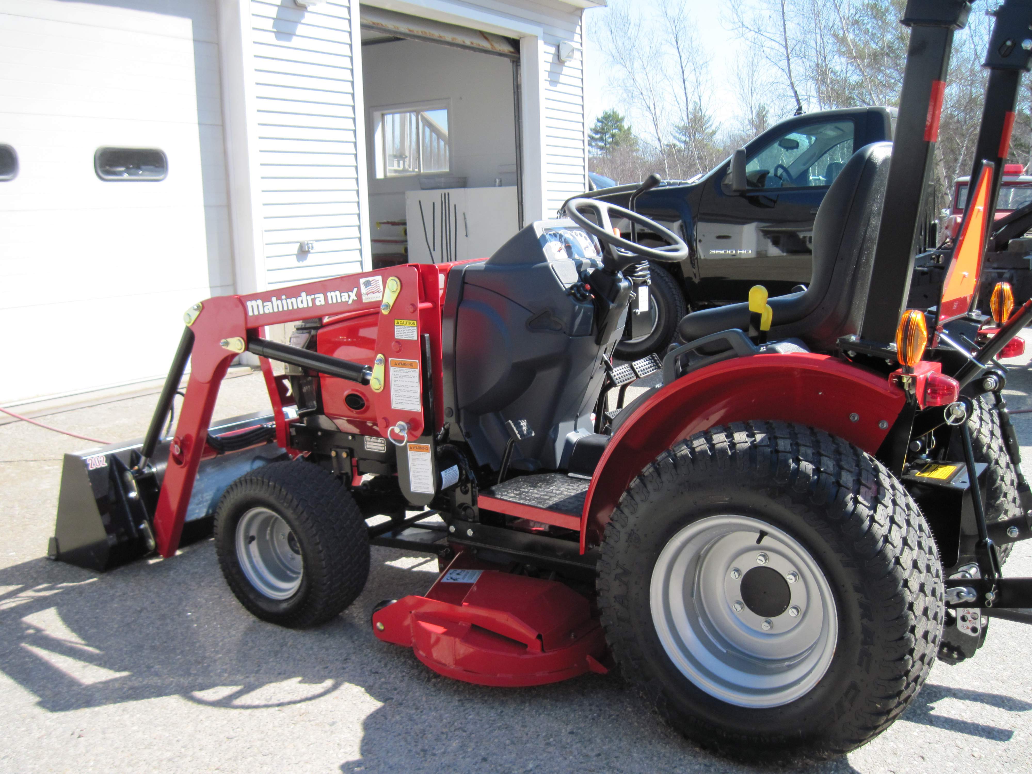

It felt great, even managed to scrounge up a little gravel to scrape up with the bucket. Two problems, the mower deck will not go down and all the lights work except the headlights. It was a mixed day, half happy to be almost ready to go and majorly bummed the deck will not go up and down. Guess I will be seeing how the service is at the dealer. :confused3:

Could the mower be latched up? I have not installed a mower on a Max 22 yet (ours will be in this week), but if I recall correctly, you can latch them up so that you can keep them out of the way when you are working the three-point for box scraping or whatever. That way the mower doesn't lower everytime you lower the box. You might check that.
On the headlights, the grill is removed to install the battery during final assembly. I bet the plug did not get plugged in.

Not sure if that is the case with the mower, will check tomorrow. I am handy, but the truth is I helped my friend who is a premier body guy. I wish I could take the credit, although I did design the setup. The mower was lowering and raising when the dealer delivered it. Is it possible to hook itself? Where would that hook be?

The hooking mechanism is done on the rear drawbar. Not that I have any of them as yet, but I remember seeing that at national dealer meeting.

Thanks Galen, I think you are right.
Make sure the rate of decent valve hasn't been closed. If it is closed, the three-point will go up, but not down.

HAH!!!! Thank you, I thought that might be it but the manual is at the show where I am working on the tractor. Thanks so much, you guys are great!
