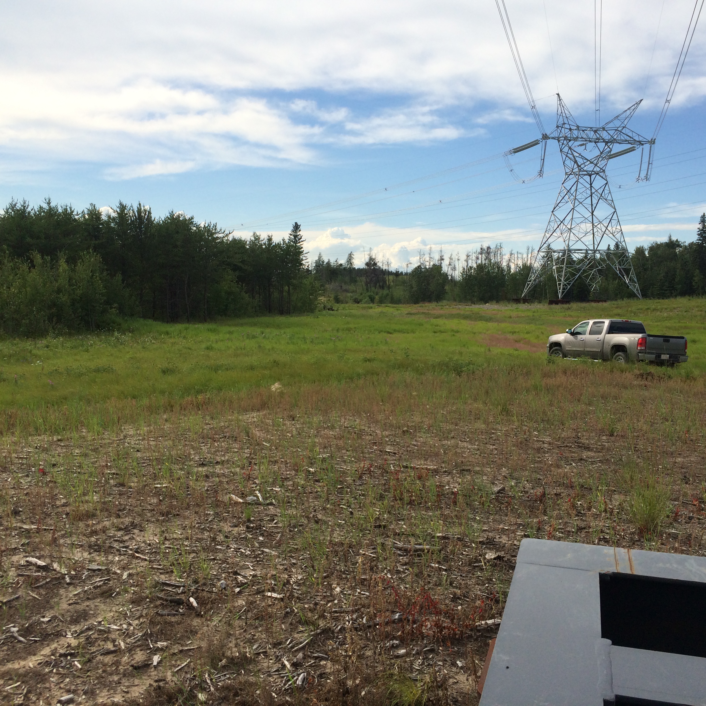

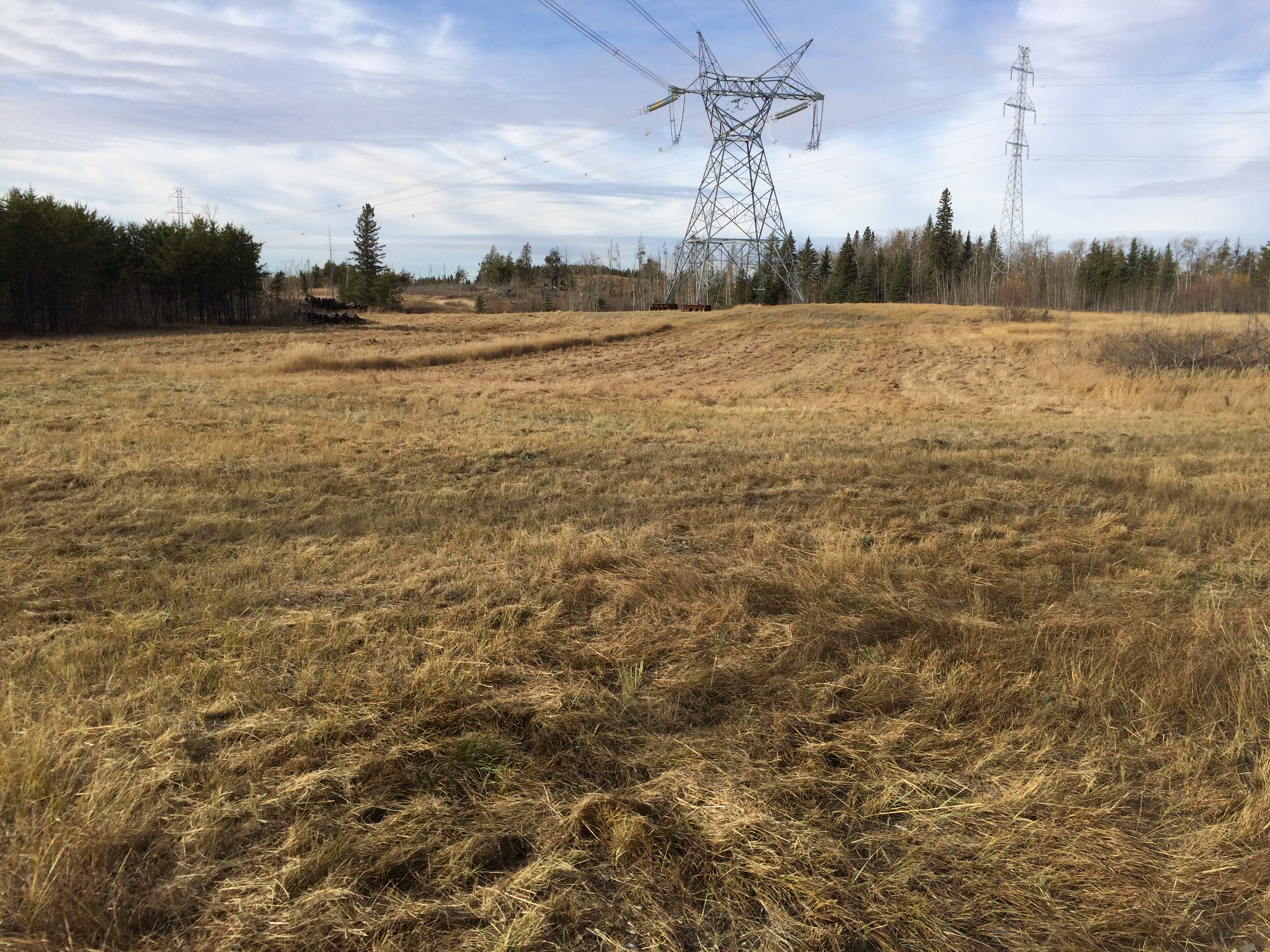

Here are some pics of my property, generally light sandy soil. The utility company brushed it in 2014 to build the line, I seeded it with a broadcast spreader and drag harrows in fall of 2015. The green pic is from Aug/16, I was really disappointed how it looked like a total failure after they sprayed it with Garlon and Picloram to kill the wooded growth. I mowed it later in fall. The second pic is from Oct this year after I let it all go to seed and cut it with the rotary mower to spread it again. You can see the standing centre strip I left, it is about 3 ft high. I would have never believed it could improve so much. The mix was 40% brome, 40% wheatgrass, 10% fescue and 10% alfalfa which was totally lost with the spraydown. They supplied the seed, it went on at 15-20 lbs /acre.
