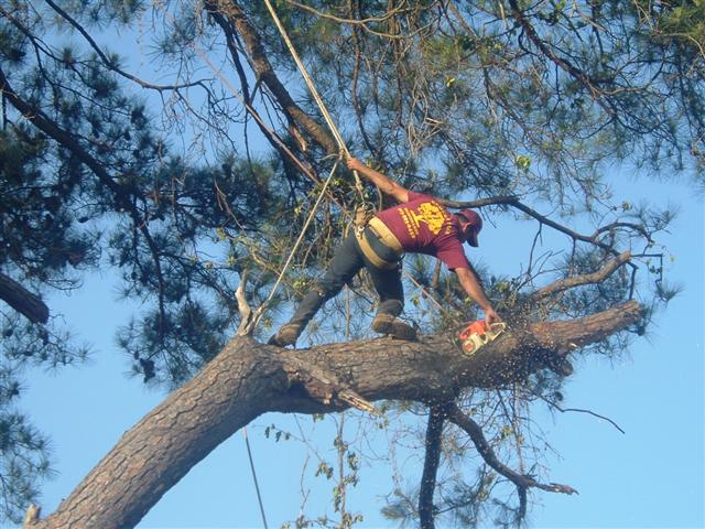

Through a friend I found this guy. His name is impossible to pronounce, but he's very reasonable, and showed up when he said he would.
He had about a doze chain saws, all sorts of ropes and a crew of three.
First thing he did was climb to the top and tie a 300 foot rope to the tree. Then he repelled down with another rope he had anchored up there and started taking off the branches that would cause the tree to fall the wrong way.

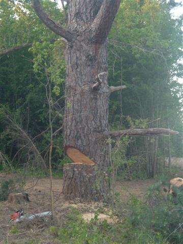

After he removed the branches he didn't like, he used his 36 inch Stihl to cut out this notch. He had to cut from both sides since the saw was too small. /forums/images/graemlins/shocked.gif Said he should have brought his 48 inch saw /forums/images/graemlins/crazy.gif

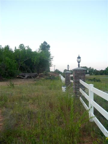

For insurance, we tied that 300 ft rope that's attached to the top of the tree to my dozer. My dad took out the tension while one of the guys translated what everyone was saying. Niether my dad nor I speak Spanish.

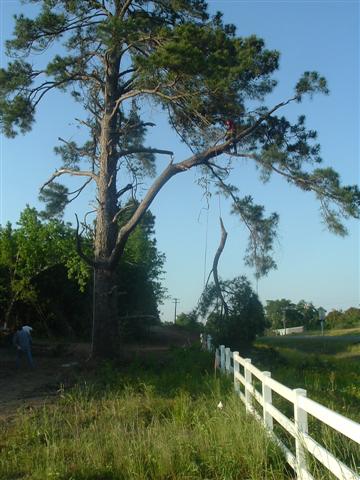

Now that it's out of the way, I have a clear shot along the highway to the nearest power pole.

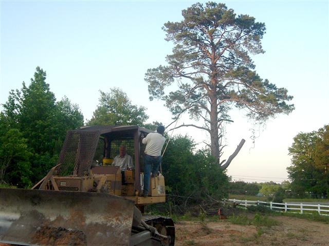

TXU put the poles in one day. I was in a meeting in town that morning and by noon when I got back, they were all done. Sure would have enjoyed watching them work.
Anyway, I was in town on another issue when they showed up to put in the wires. This was a two day job, so I didn't miss too much of it.
The lines along the highway take a sharp turn when entering my place. They wouldn't put any guy wires into the highway right of way becuase of previous issues. Not sure what that meant.
Two poles are put in fairly close together and the wire is loosely hung from one to the other. This way the tension is in the direction of the guy wires.

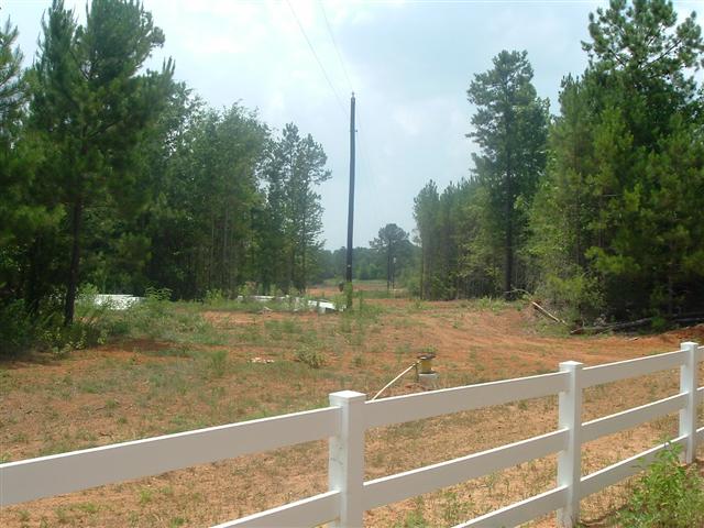

I'd cleaned up the opening through my front pasture earlier in expectation of this actually happening.

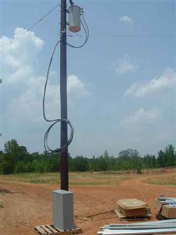

Here's were I'm at now. Poles are in, wire in attached, and all I need is a place to bring the wires to...
Then I hit a wall. I have to have a licensed electrician hook up my meter and disconnect. No problem, I know just the guy. I've used him on other projects.
I call and find out he's no longer a contractor and is working for the school district, but his brother is running the company. I know him, so I call. No answer, so I leave a message. Several days go by without a return call. I try again and to this day, three weeks ago, I still haven't heard back from him.
I talk to another buddy to get his guy. He says he'll be there the next day. Great. Except he doesn't show up. No call and he isn't answering his phone anymore. That was two weeks ago.
This week I get the name of another electrician from a different buddy. Should have gone to him first, cause his electrician showed up and is right on top of things.
He's never done a 1,200 amp meter and diconnect before, but knows just what to do. He gives me a plan and says to call when I'm ready.
The best part about his plan is it's totally different then what I've seen in other RV Parks. We'll just bury the lines coming down from the pole in conduit, run them back up through a concrete slab into the meter box. Then from the diconnect box, we'll run six seperate lines to their destinatios through the slab.
Brilliant, simple and clean.
