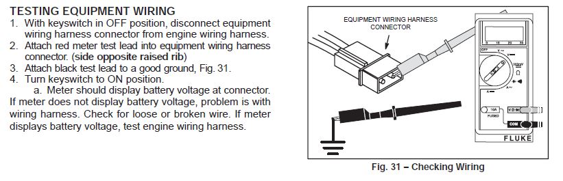

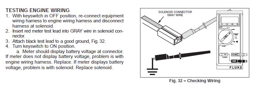

Before you go off on work around's for your hard starting issues, you should make sure that your fuel shutoff solenoid is working and that the voltage is being applied when it should.
I doubt very much that Briggs developed this engine, found that it wouldn't start well when cold and said, "Ah what the ****, just sell it".
So take some time an look into the problem. Below is some pics from the manual showing how to check for the proper voltage at the solenoid.
What the manual does not suggest, but you should do this. If the voltage suggested in the test procedure comes on as indicated, you may want to check the solenoid itself. Set your meter to ohms, on the lowest ohm scale if you have that choice. Place the two meter leads on the contacts of the solenoid. (note: you may have to insert the probes into the solenoid housing to make contact) You should get some sort of reading. Perhaps from 20 to 100 ohms. If you get no reading, then the manual process is correct.
It often happens that the OFF/ON/START switch goes bad. It doesn't apply the voltage to the solenoid when it should. This can be a bit mystifying because the engine starts when warm. That happens because the engine does not need much fuel to start when warm.
It is important to note that the fuel shutoff solenoid must also be active, i.e. open when the OFF/ON/START switch is in the START position. I have seen cases where the solenoid is active in the run position of the switch, but not active during the start position of the switch.
Richard

Kohler comes to mind of having that issue. Either due to key switch not compatible with new engine with fuel solenoid, or for some reason key switch looses contacts between the B+ and the L terminals
/ Briggs & Stratton Hard to Start #29
Yep, I re-powered a friends Cub Cadet Zero turn with a Briggs engine. After getting everything hooked up, gassed up, and filled with oil, I tried to start it. Sometimes it would start the next time it would not. I'm not sure what the problem was with the switch as it worked for the original engine.
Once I figured out the problem, the shut-off solenoid was not getting voltage during the crank stage, I fixed it with a wire and a diode with one end connected to the starter and the other end wired into to original wire to the solenoid. Worked like a charm.
Richard
