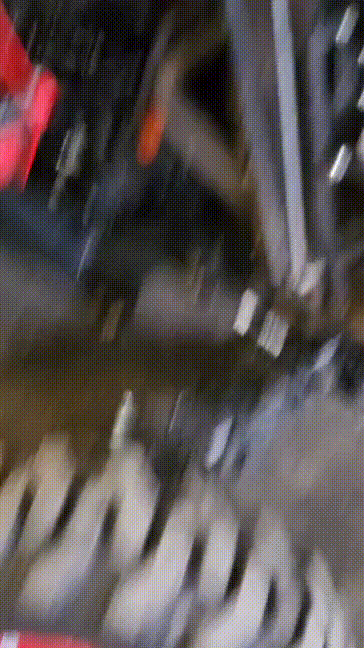

just a heads up guys if you loan out your equipment make sure to inform the person your loaning to gasoline doesn't go into a diesel tractor.
Edit* just to give context, this unit was brought to us because they couldn't get it to start, well once we were finally able to this was the result, and was also shutdown very shortly after i took this video, gonna require fuel system overhaul, cleanout of tank, fuel lines, new filter, new injectors, and maybe a new injection pump if it damaged the internal seals, very costly for a simple mistake that can be prevented.

Could be handy to get the brush pile burning, plus gas is a lot cheaper than diesel !
/ Breathing Fire - warning #3
I've been around a couple of fuel mix ups.
Neither required any hard parts replacement.
And the filters were replaced just because it was a good idea.

It don't need all that work. Just get most of the gas out and keep going. Dump the filters out and use the same ones. Had this happen many times. Last time was a diesel pickup.
