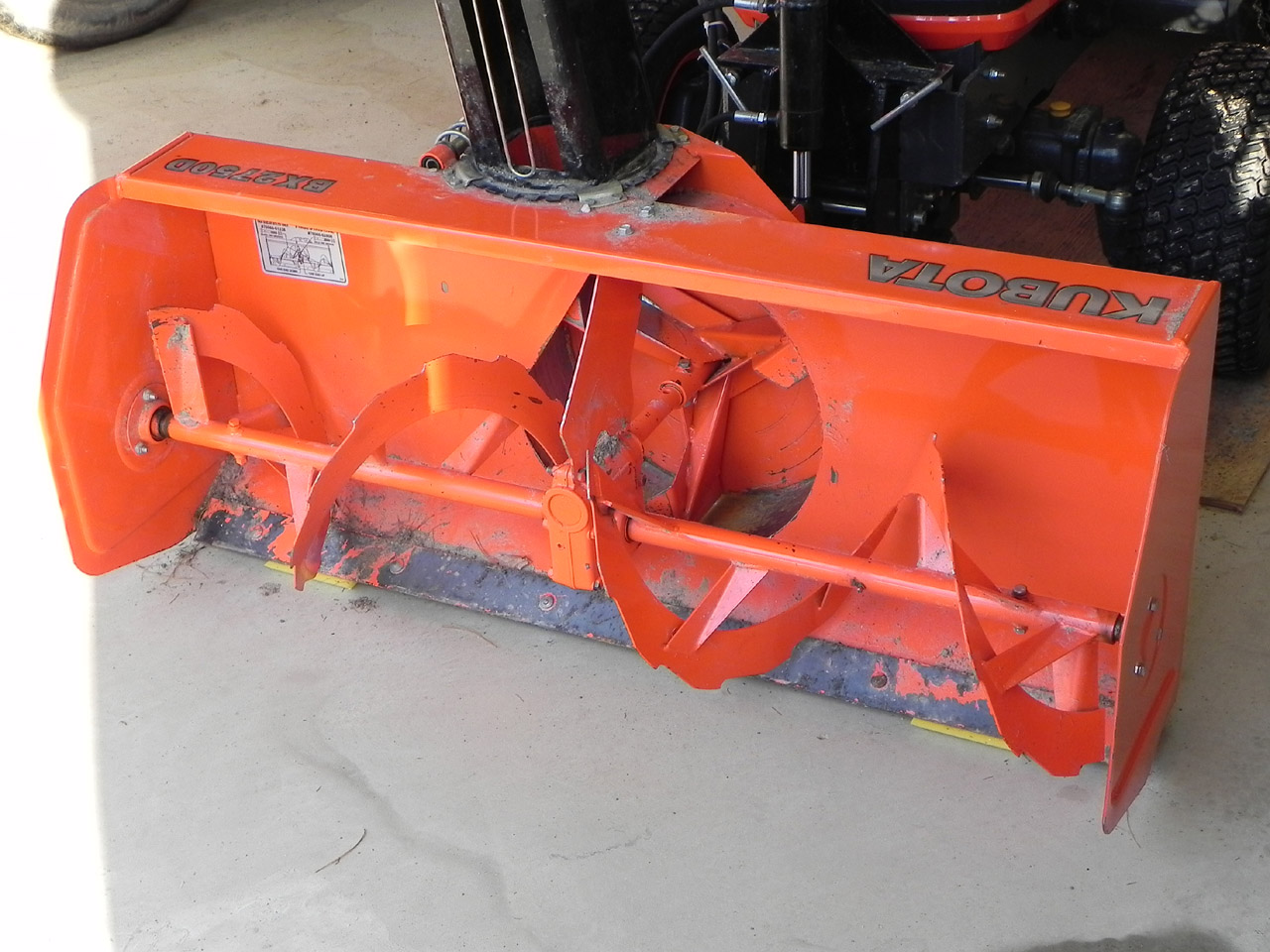

I have a Kubota BX25D tractor, and a front mounted snowblower. The snowblower breaks a crazy amount of fan shear bolts every time I use it. I am using the proper ones. yesterday I was just clearing about 8 inches of powder snow, and it was breaking them for no reason. No stones rocks debris, and not even pushing it hard. Any ideas?

Which fan bolt? I was breaking mine until it was told to me the long bolt that secured the fan to the shaft is grade 8. The short one that connects the flange is the soft one.

The snowblower is the Kubota 2750D, and the fan shearbolts are the proper gold coloured ones, are 5/16, part number 70060-02808. I rarely break the auger shear bolt.
   / Breaking shearbolts #9

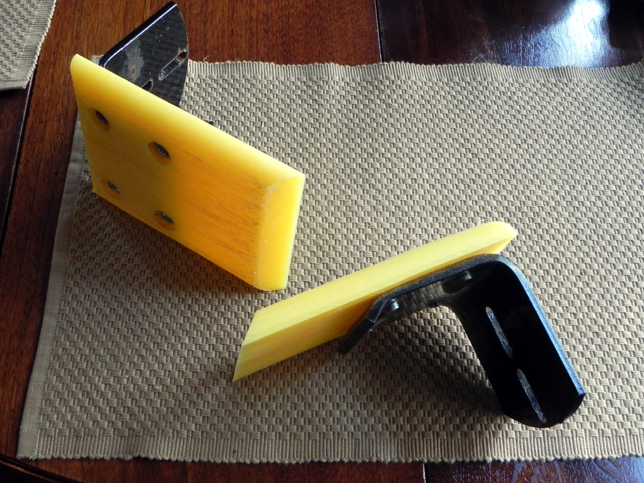

I run the same setup on my BX25. The first year I sheared 6 fan bolts but I blow nothing but graveled areas and I was picking up a lot of rocks because of the inadequate skids. I added skid shoes and made them to long enough to reach the cutting edge and now I might shear one a year or none.
Skids mounted -
Skids mounted -
That looks like a good idea. The stock ones are a bit inadequate now that you mention it. Thanks very much.
