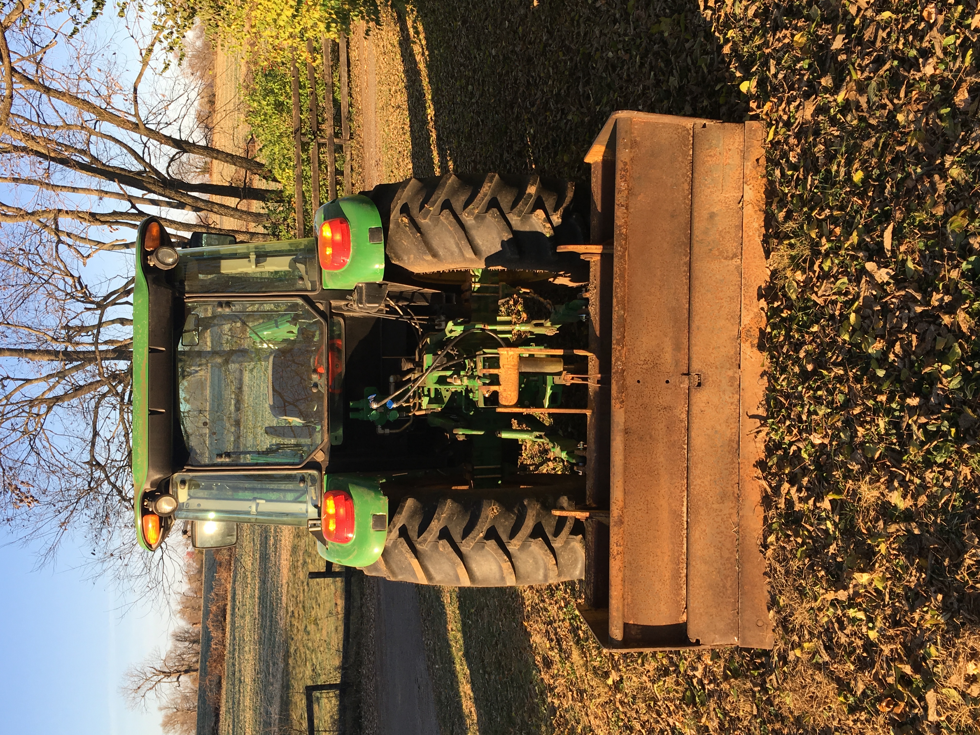

I recently purchased an 80" Gannon 4x2, of CL. It had no shanks at all, but the hydraulics works well.
I looked for quite some time, until finally giving in and purchasing the shanks from eBay. They arrived, along with teeth and new spring clips, 8 sets in all. The shanks appear to be cast iron. The notches in the front turn out to be too narrow (clue #1) for my blade, so initially, I had a machine shop cut notches in the right location. They simply used a cut off wheel and notched it out. They put the teeth on, and $30 later, I was fully shanked and ready to roll.
They work fine, sticking roughly 6-8" below the box when fully extended and locked. However, I've broken 3 shanks so far. I know when I've done it, it was when I was working around some big trees, and I hooked on a root. I got a little resistance, then everything continued on its way. Come to find out, each time I noted this resistance, I was breaking a shank.
My tractor is 100hp at about 9K lbs. The blade is huge and heavy. Nothing has twisted, tweaked, or torn... other than the shank.
Now, I know that this is a cheap 'shear pin' type safety to keep my tractor and blade intact. However, It seems as though these shanks are breaking rather easily. They break at the bottom of the tube through which they pass, right at the bottom of the 'new notch'.
Any ideas about whether I can get any stronger shanks or where I can get some which would fit my Blade in design?
I don't know whether these are just weak shanks or whether notching them for fit is weakening them to the point that they break far too easily. But regardless, I need to see whether I can find an alternative. There really seems to be very little 'stress' put on the machine as it 'catches and breaks'. I don't even have time to hit the clutch to stop it, before its already moving on. Thus, it seems to me the shanks are weak or weakened.
I'll have to remeasure, but my top tube through which they hook and pass is approximately 5 - 5 1/4". The notches inherent in the shanks I have found have notches only approximately 3 1/2 - 4" apart, necessitating my additional notching.

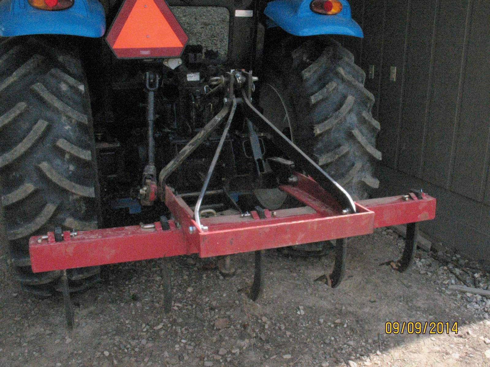

By the way, the shanks aren't cast iron, they might be cast steel but more likely they are forged steel. They are weldable as I have welded back mine more than once using 7018 rods. They then hold as well as a new one, but still break at that notch. I haven't used my box blade since I got this implement IMG_1643.jpg The shanks seem to be much stronger on this thing which I use to uproot rocks prior to tilling.
NOTE the pins thru the middle of the shank rather than a notch

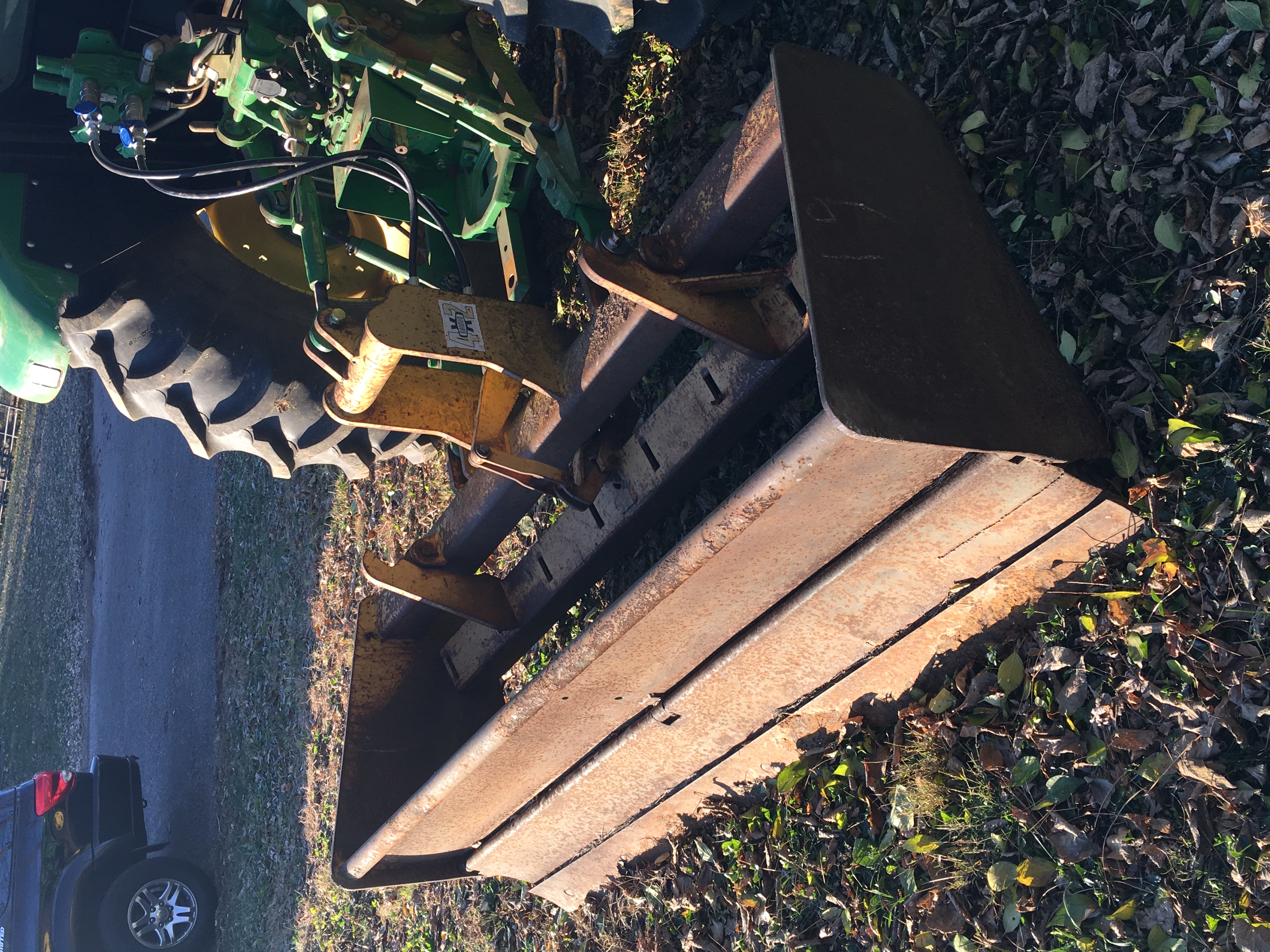

I had some better pics, but this is all I can find for now.
In order to change over to 'center hole' shanks, I have to weld brackets to the top to hold the cross pin. While that isn't a HUGE problem, it is a moderate hassle at this point, as I don't currently own a welder. I just haven't gathered the $$$ for one, given everything else begging for $$$ as well. I guess I need to just buck up and get one.
But, I really believe, this is a big blade, and they surely wouldn't have been having as much trouble as I am having, and kept the design. Surely, there is someplace I can buy replacement shanks that aren't as weak as the eBay ones I have found thus far.
And yes, I meant to say cast steel, I guess the 'iron' just follows 'cast' so easily that I didn't even recognize what I was saying. I don't believe it is forged. Neither did the machinist.

Gannon is now Woods. Locally, that's the Kubota guy. I would stop by and ask to see the parts breakdown before buying more.
http://www.woodsequipment.com/files/Products/Literature/B04024_LandscapeEquipment.pdf
/ Breaking shanks... thoughts?
#12
Thanks, That 's what I needed. I've been trying to find the # of the blade. I knew that Woods had purchased them, but when I called my local 'Woods' guy, they had no idea about what I was speaking. I felt like I was talking to a zombie. And since I didn't have a #, he was stuck.
Hopefully, with this information, I will be able to find OEM shanks and see whether they are stronger and notched appropriately.
