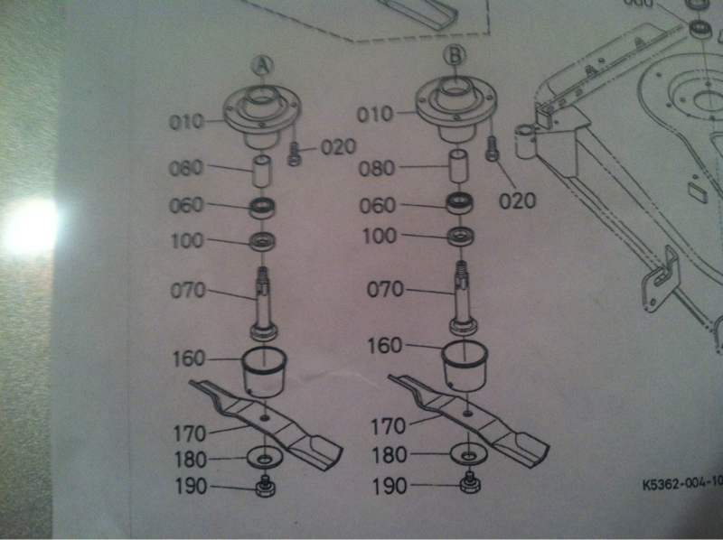

Have you replaced the washers on the deck? I think the set up of the washers is supposed to allow the blades to slip on the spindle if you hit something. The washers are cupped and I think they are called a bellville spring but I could be wrong. Here are the PDFs showing the spring plate the goes between the blade bolt and the blade.
View attachment A00701.pdfView attachment A01001.pdf
   / Breaking BX Blade Bolts #7
I could see the bolts breaking off if someone replaced the springs with washers. Just a thought.
