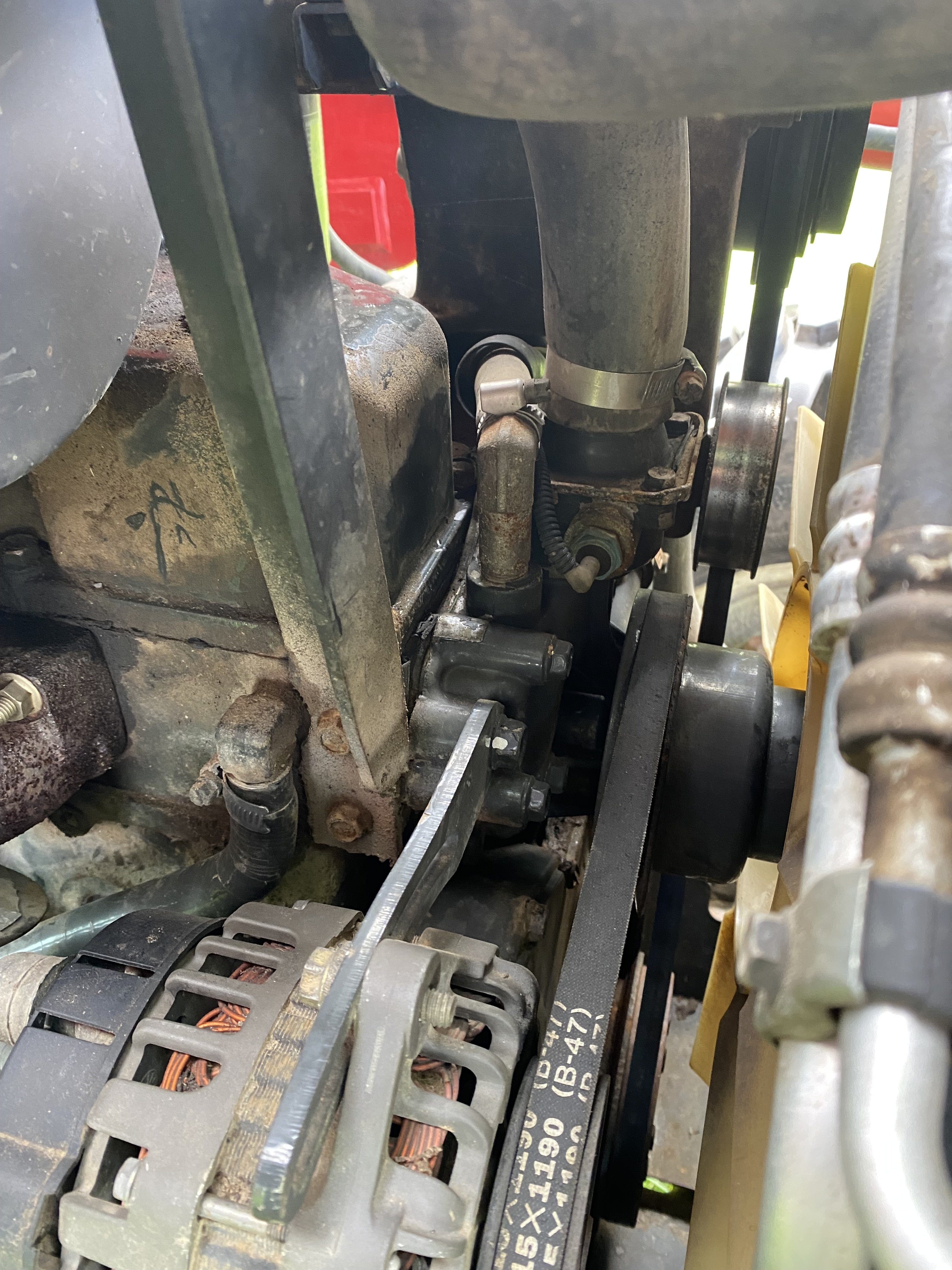

Hello,
Has anyone had problems with their Branson tractor’s water pump?
I am seeking suggestions for what needs to be removed and in what order.
Thanks
/ Branson water pump replacement #2
Welcome to TBN!
I don't have experience with Branson, but from your picture, like most tractor water pumps, if you can take the fan off, remove the fan belt and remove the water pump bolts, you should be able to remove it. Not sure what kind of room you have. If you don't have enough room, you might have to take the radiator out.
/ Branson water pump replacement #3
When I changed the one on my 8050 I didn't pull the radiator. It was a royal pain getting the fan bolts off and the fan out and the same going back together. It would have been easier if I had pulled the radiator.
/ Branson water pump replacement #4
I agree with LouNY, on my TYM273 when I changed the water pump it was much easier and far more room to work with the radiator out of the way. Also was a great time to do a thorough clean out of radiator at same time.
/ Branson water pump replacement #6
I also removed the radiator when I changed the water pump on my Deere 5105. I could have done without that but it made it easier to get to things.
