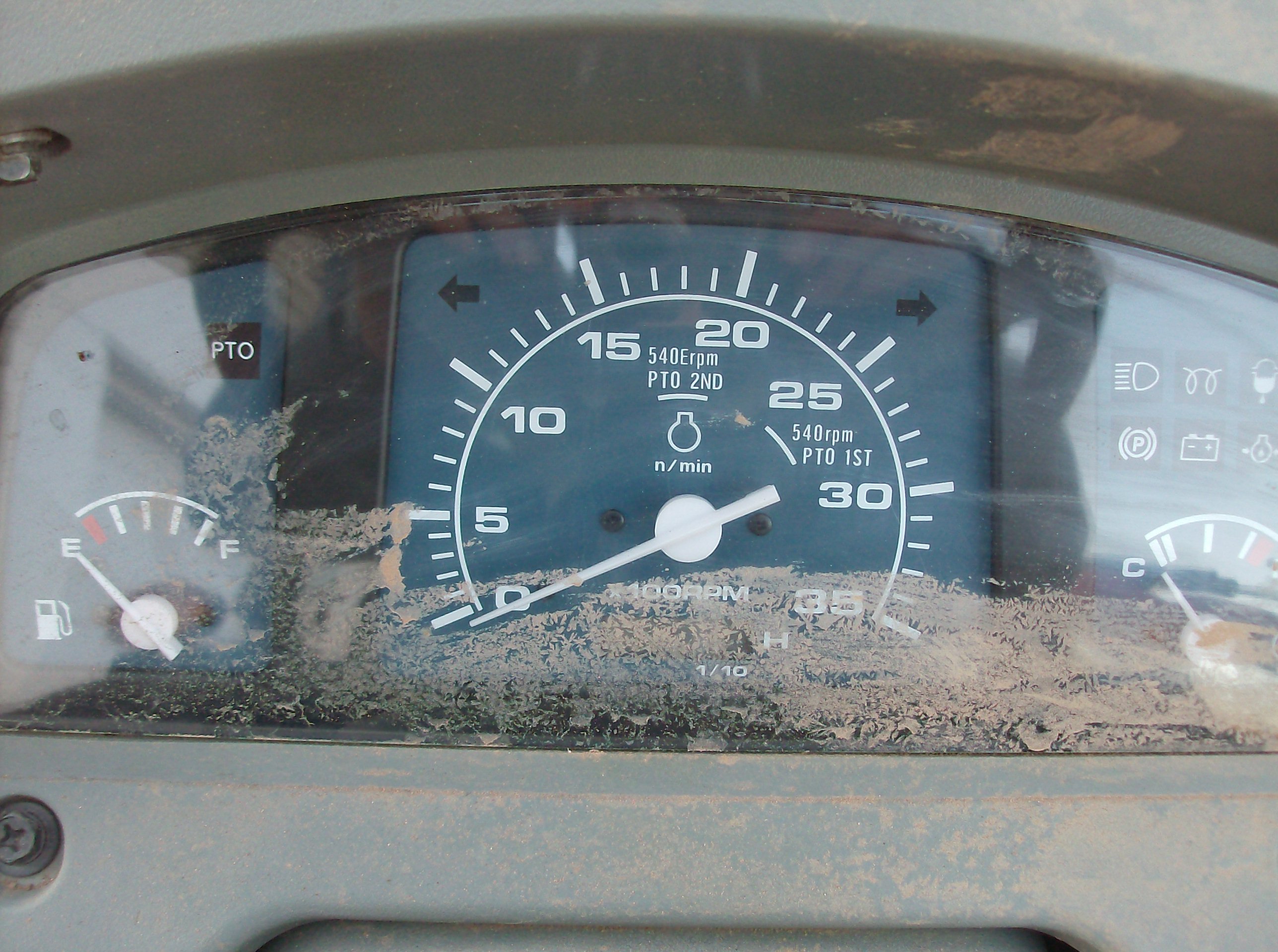

I have the manual . Too bad every second word is spelt wrong. Manual is very poor. The dash does have a PTO 1 and PTO 2 mark.
PTO 1 is 540 ?? and pto 2 is ?????
Update 1800 rpm says 540E PTO2 Not sure what that means ?
2500 -2700 RPM is PTO 540 1 mark
/ Branson Trailer 4720i (47 hp) #5
It has a two speed PTO and at 1800 rpm pto 2 is at 540 rpm while pto 1 would be much slower. Your engine is designed to run at about 2500 rpm to develop full torque and 540 rpm in the pto1 position. There should be a lever to change the pto setting. Most al US implements are designed to run at 540 rpm pto speed. Your engine is designed to run at 2500 rpm for ax efficiency and power.

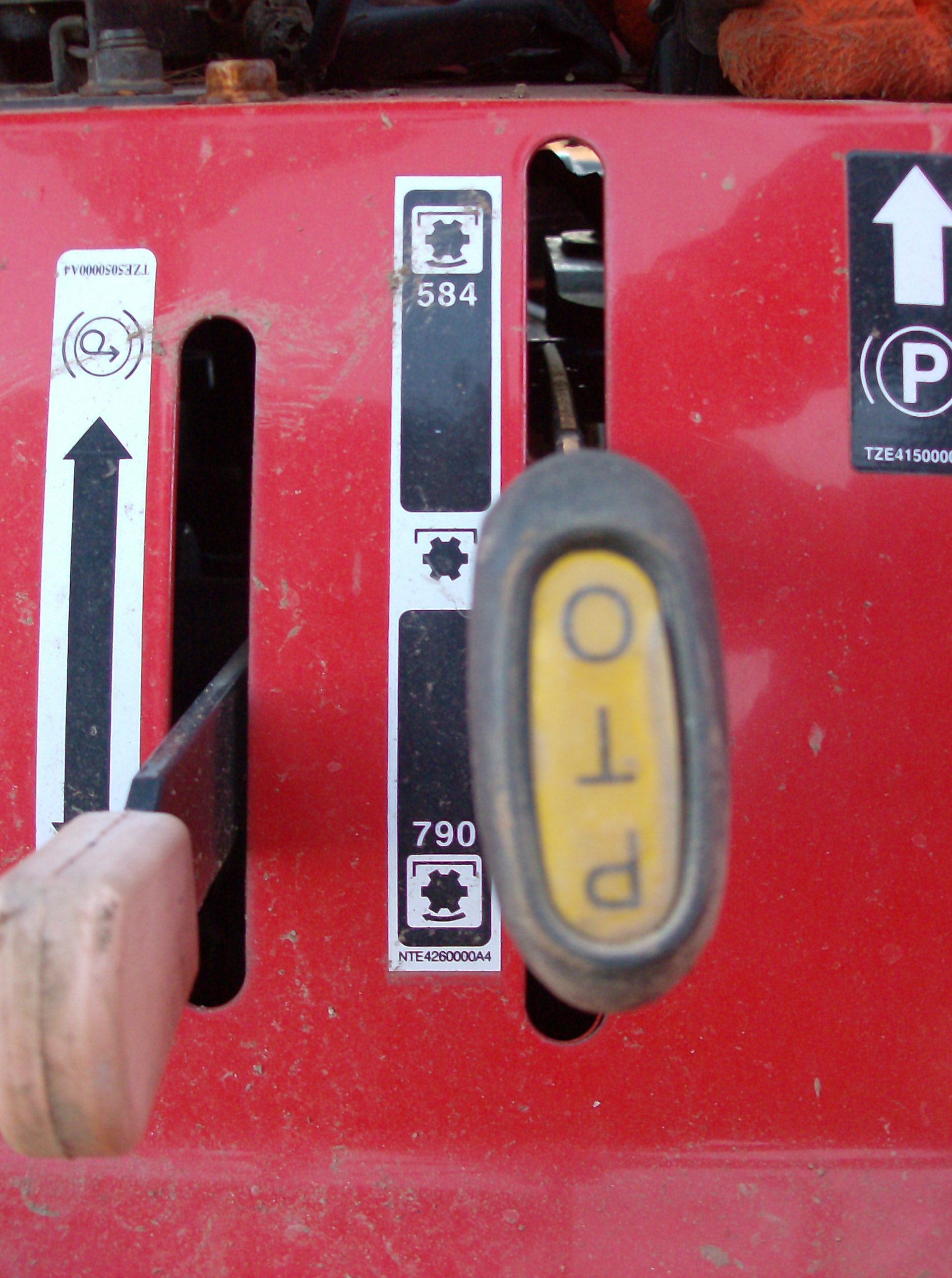

Will try to get a pic of the console today Both marked areas say 540 PTO.

Looks to me as though your PTO has the customary two speeds with neutral in the middle, just that they're labeled 584 and 790 rpm, versus 540/720 which is standard. That is probably what they have calculated, based on their recommended engine rpm of 2500-2700. So I'd say run the engine at about 2500 rpm.
/ Branson Trailer 4720i (47 hp) #10
I'd like to add to Rich's post with my interpretation of the two PTO speeds on the tach. The #2 speed ~1,800 r/m is for stationary PTO driven implements that do not require tractor propulsion: ie. log splitters, generators, chippers, etc. The #1 speed ~2,500 r/m is for implements requiring power with the tractor in motion: ie. rototiller, brush hog, etc.
