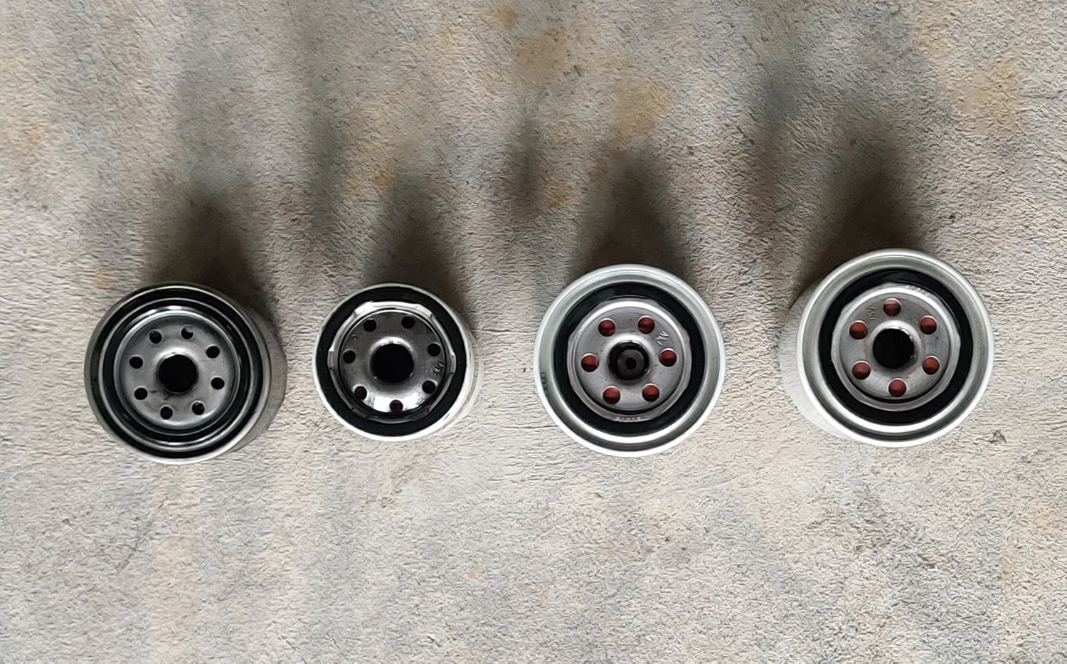

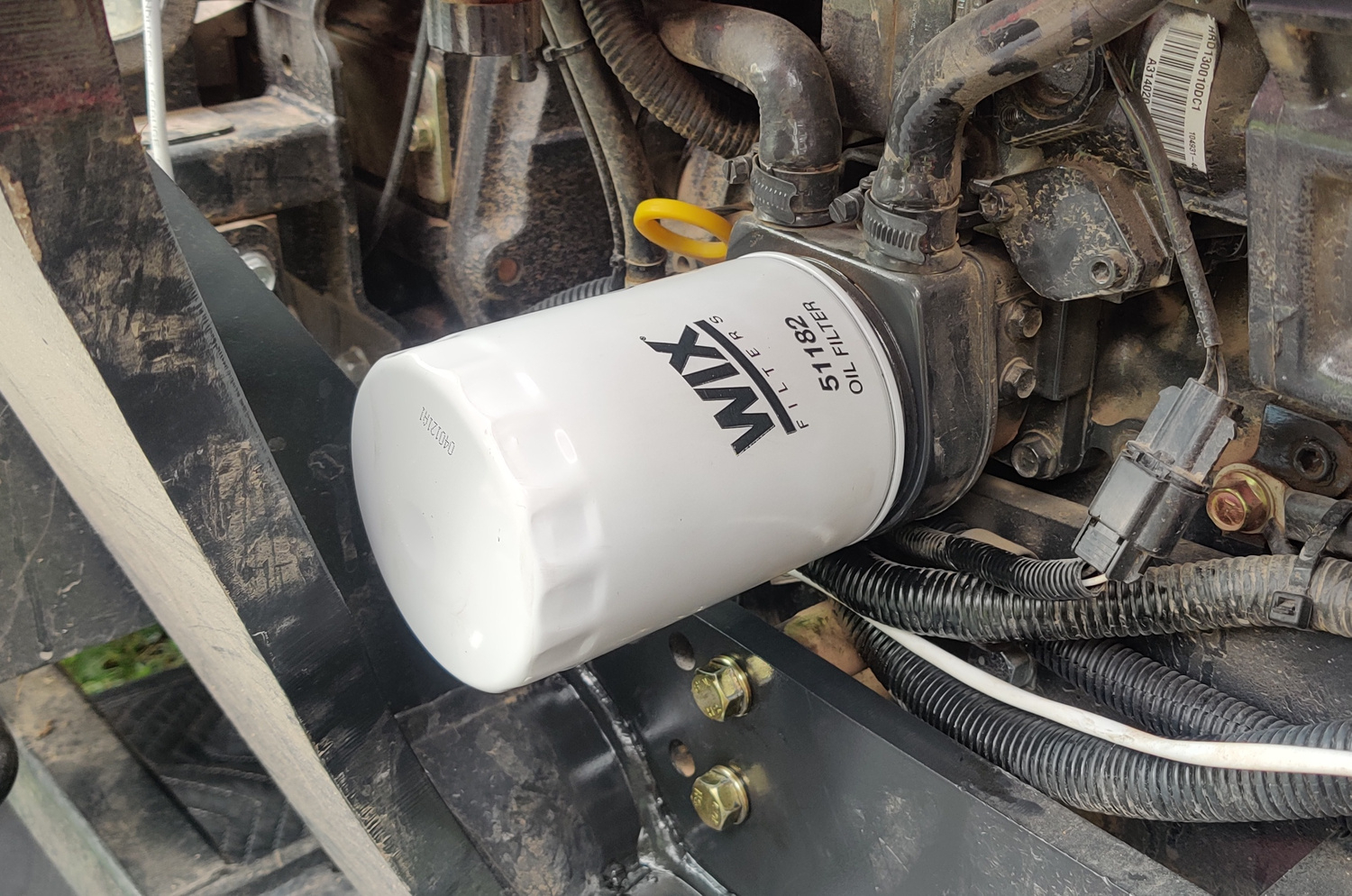

Adding to this thread, I recently did an oil change on my 3620h (A1700N2 engine) and did some research on which oil filters will work. Here are several I found, all Wix/Napa. They all fit but the one I chose to run is the Wix 51182, which is almost twice as large as the OEM filter.
In the pictures, from left to right:
OEM -- Napa 1347 / Wix 51347 -- Napa 1324 / Wix 51324 -- Napa 1182 / Wix 51182
