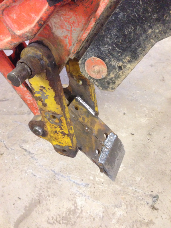

What are your fabricating abilities? A ripper shouldn't be very hard to build. After I get done with this scraper I plan to make a ripper from it.

I could fabricate but I'd like to defer to getting it from a company that has done their engineering. I'm not capable of making intricate cuts, making beveled edges, using high quality steel, etc.

Never did hear if they would be compatible. I fabricated my own ripper.
