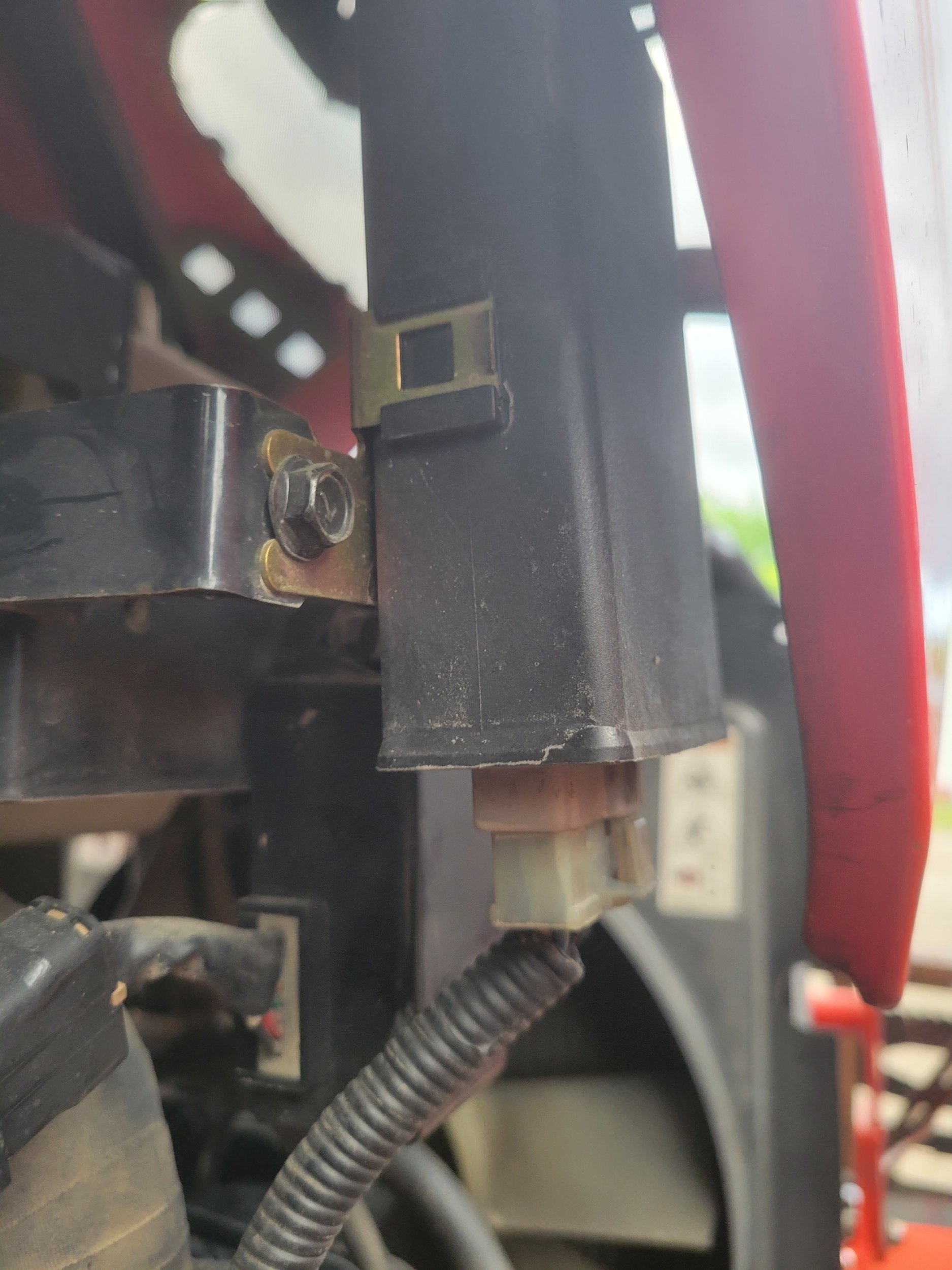

Last week l want use my tractor turn the keys he start about 5 to 8 time.
So l turn the keys of and tey again but this time no light in the dash and hebdont want start.
I check the battery 12.7,the starter same thing.
So whats the probleme.
Thanks

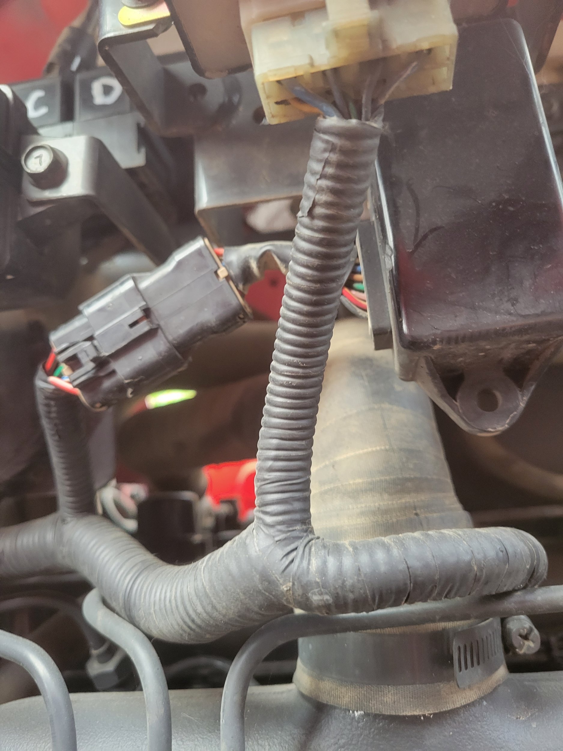

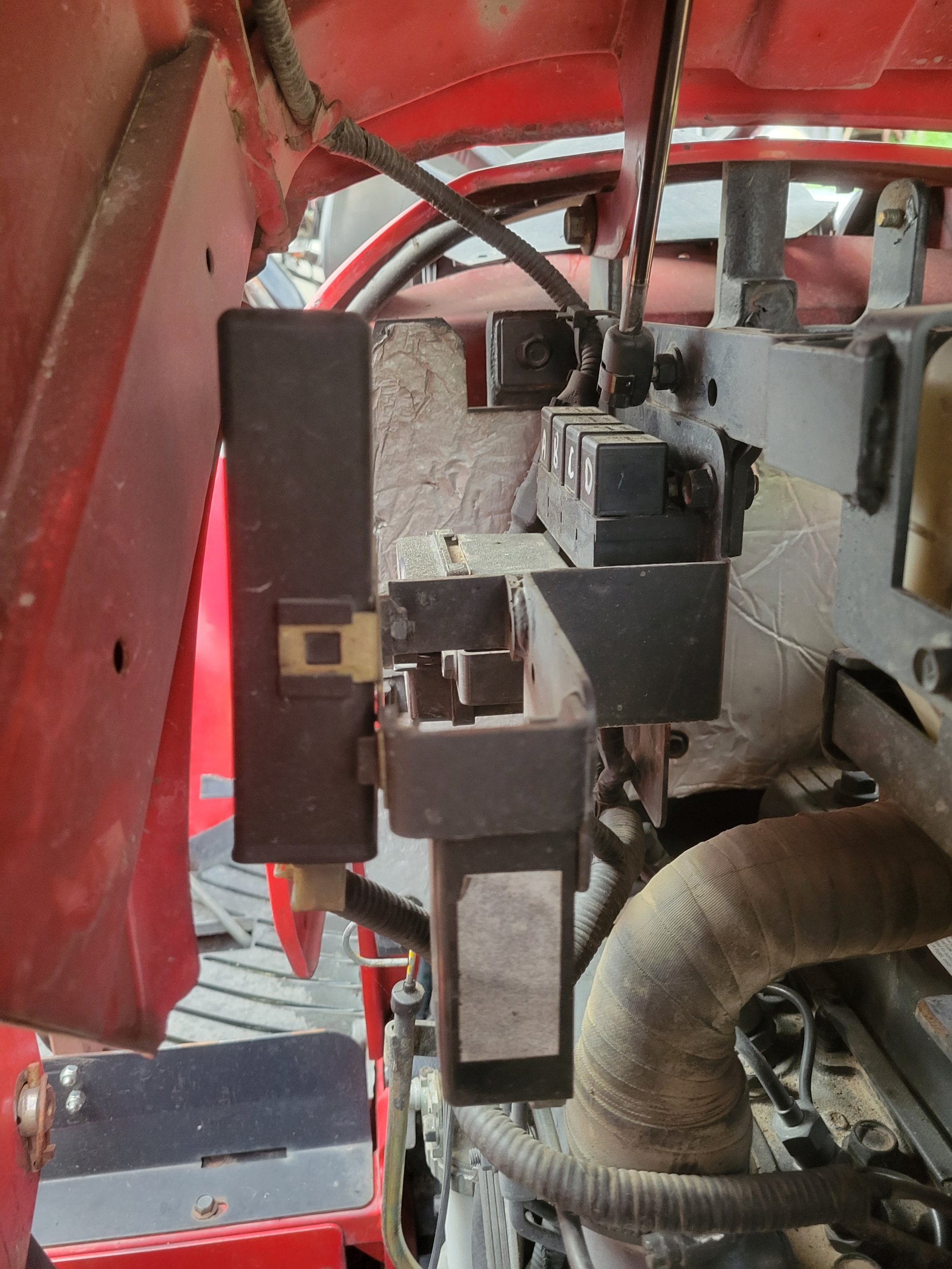

My battery test 12.7,my starter 12.7 and the alternator 12.7.
But l cant tell you if the alternator pull too much juice the tractor dont want start (no tic tic nothing **** all.
The first time he make the motion to try start good maby 5 to 8 time and no more electrical its like if l disconneced the positif one shoot.
And said ok l turn the key off and l turn at the first click for see the go plugs and all the rest off the light in the dash but light come on **** all.
So the first think l do its put the battery at low charge for 2-3 hours give a break for 2 hours and give him a charge for 2 hours around.
After that l check with my multimeter my battery 12.7 thats is good.
So l check all the small fuses all good and l blow whit they air and take out the square relay in the top and blow they air to.
I take the swich out and blow air to.
I gone try to send you a pic of the fuses box and the relay but the relay l dont no how to check if is good or not.

   / Branson 5520r issues electrical #4
Start with checking voltage on the fuses in the fuse box. A pin light is helpful for tracing electrical issues.
Verify voltage on both sides of each fuse. Some of them will require the key to be in the on position.
Ok thanks l check those things
