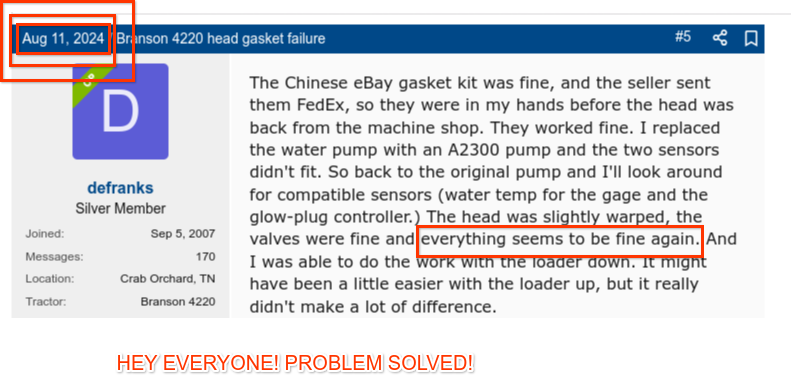

So the previous repair did not last long. How warped was the head?
I'm not the op.
Why are you thinking that the previous repair didn't last?
The op was the last to report on this thread, stating that "everything is ok" then (in August 2024), until you responded 8 months later.
   / Branson 4220 head gasket failure #16
I'm not the op.
So sorry. A foolish mistake.
