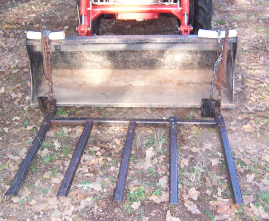

If you're needing forks on your front end loader, I've found this attachment solves it. I've used it HARD for over 10 years. I've hauled many tons of brush, unloaded pallets from trucks, and even used it as a lift to work on the underside of my riding mower and go karts. Just drive whatever over the forks and lift and angle it to get exactly the position to fix the underneath. Works wonderfully! You can, also, remove some of the tines to get down to two if you really need to. I've always been able to enter the pallets without removing anything.
I ordered this fork set from somewhere in Oklahoma and, given the abuse I've heaped on these forks, I'll say that those guys in OK know how to weld. They're very easy and quick to put on the loader. You just hook the lip in the front and pull the chains around the back. Tighten the chains with a lever binder and you're good to go.

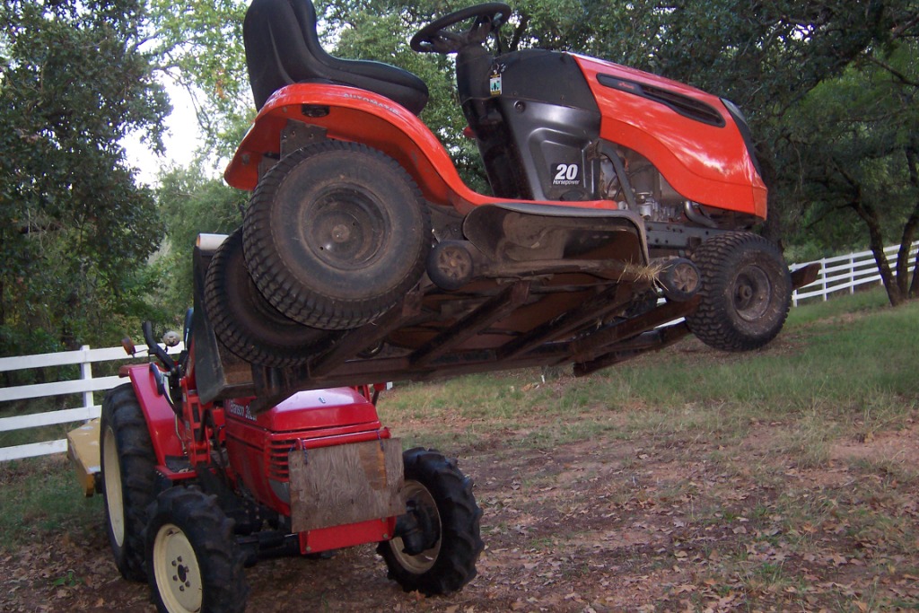

My wife wanted me to sharpen the riding mower blades this morning. No problem with the help of these forks!!

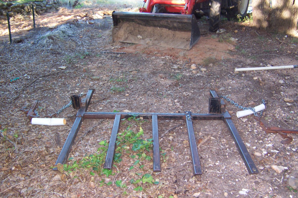

Hi Psyched123,
could you post more pictures of the Forks, and wall thickness of steel.
Looks like an easy build.
