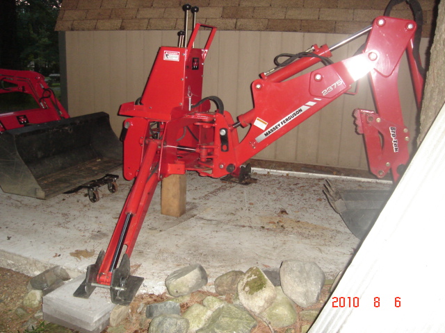

Mine will also leak down over time, so I think it's pretty common and normal.
I set mine on a cut-off log, but leave the outriggers out with pads on the ground for storage. I know the cylinders are exposed, but so far no problems. (Earlier I used a couple of blocks of wood; now use a single log piece.)
