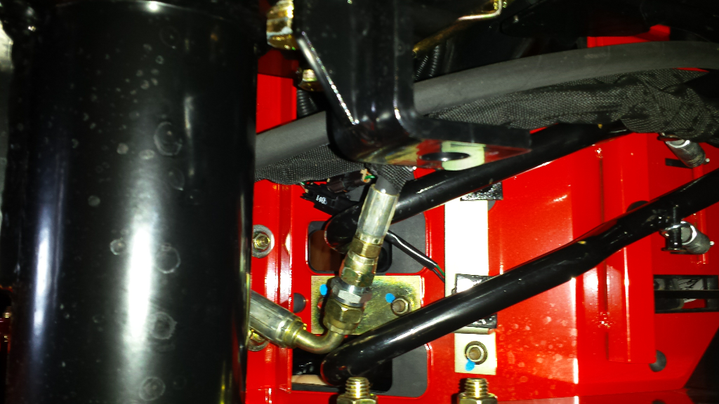

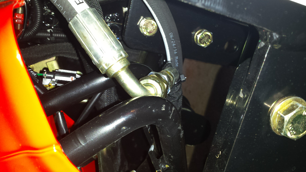

Was looking around the tractor today and found this hydraulic line really in the way of the brake linkage arms. I have not studied it enough yet to see what I can do to get it out of the way. Not sure yet as to what it works with either.
Also found that the brakes must be way out of adjustment. Pedals when separated sit at different levels.
Next day that's nice enough, I'll get under it and see. Lay hands on it.

See if you can take the hose with the 90deg and change end for end. The other end might not have a 90deg.
   / Brake pedal have a little interference. #4
Looks like the zip tie is broken in your photo that hold the hose up.
   / Brake pedal have a little interference. #5
Had the same problem with my 2400H. A couple of minutes with a wrench and the hose was rerouted out of the way. Can't remember if I had to add another zip tie or not.
