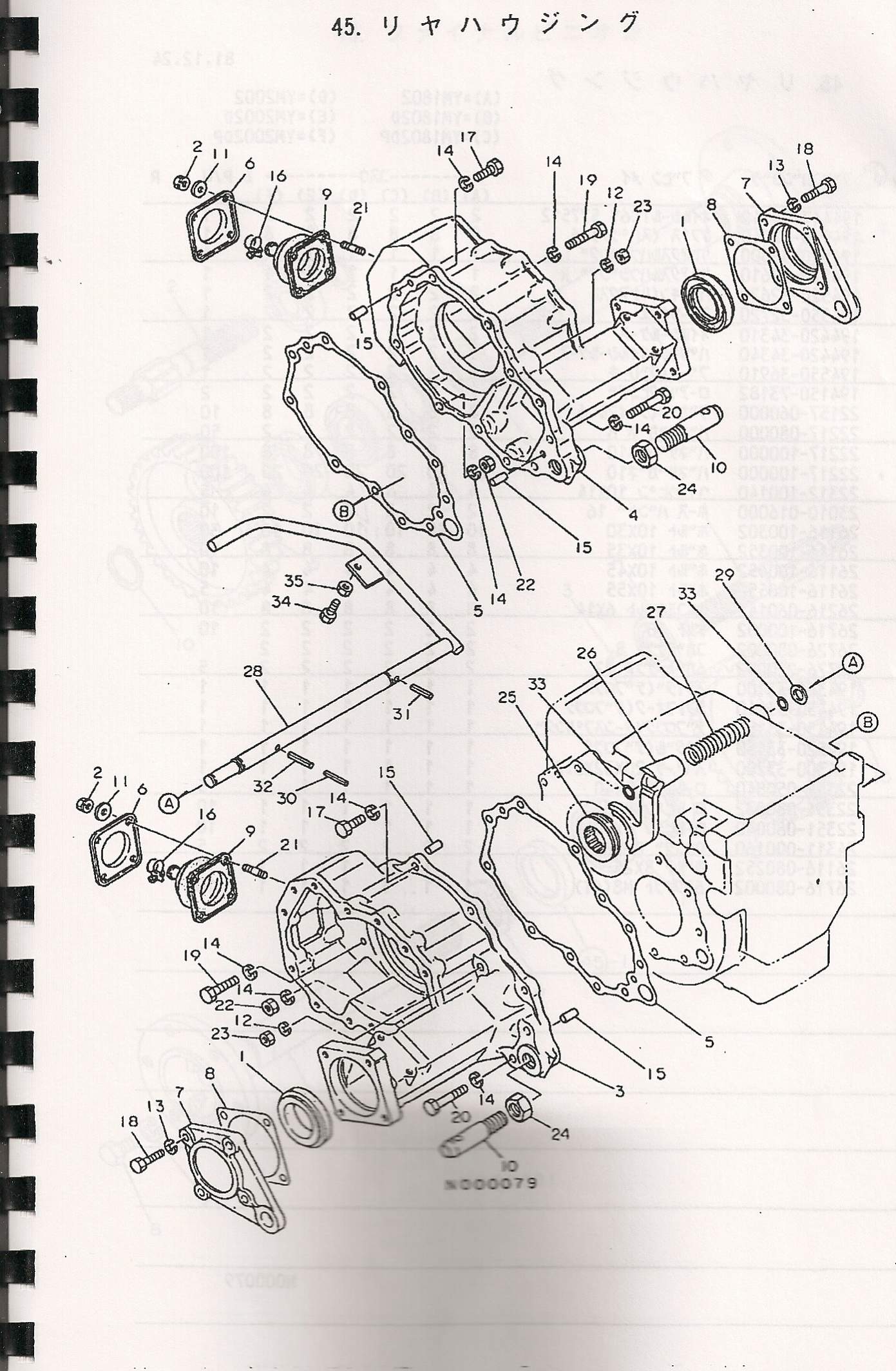

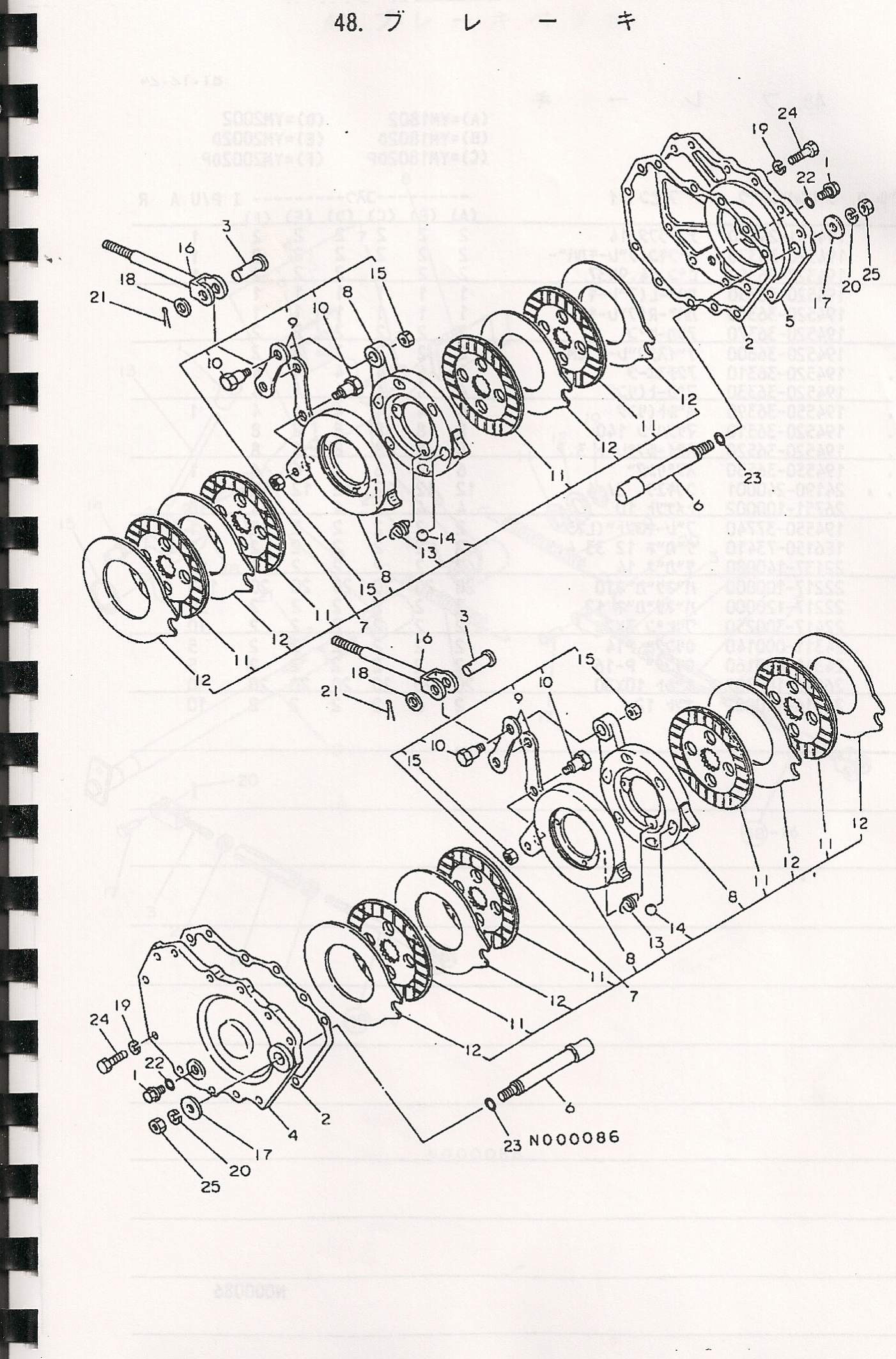

I was doing some maintenance on my 2020 - oil and filter, hydraulic filter an fluid change, fuel filter - when I noticed the boot to my brakes is seeping. What is behind here and is the boot just for protection? Just wanted to know before I called Hoye.
Also - looks like there is a drain plug on the rear of the front drive shaft. What does that drain?
   / Brake Boot leak? #2
   / Brake Boot leak?
I would think that there is an oring or some sort of seal behind the boot? Or is it the boot that holds back the fluid?
   / Brake Boot leak? #4
The boot is what holds the fluid. No o-ring. Boot just flexes as the brake rod goes in and out.

Just an update - replaced the boot - very easy job....probably best when doing an fluid change though.....lost about half a quart of fluid. Not sure if more would have come out, but I replaced the boot as fast as I could to minimize the mess.
